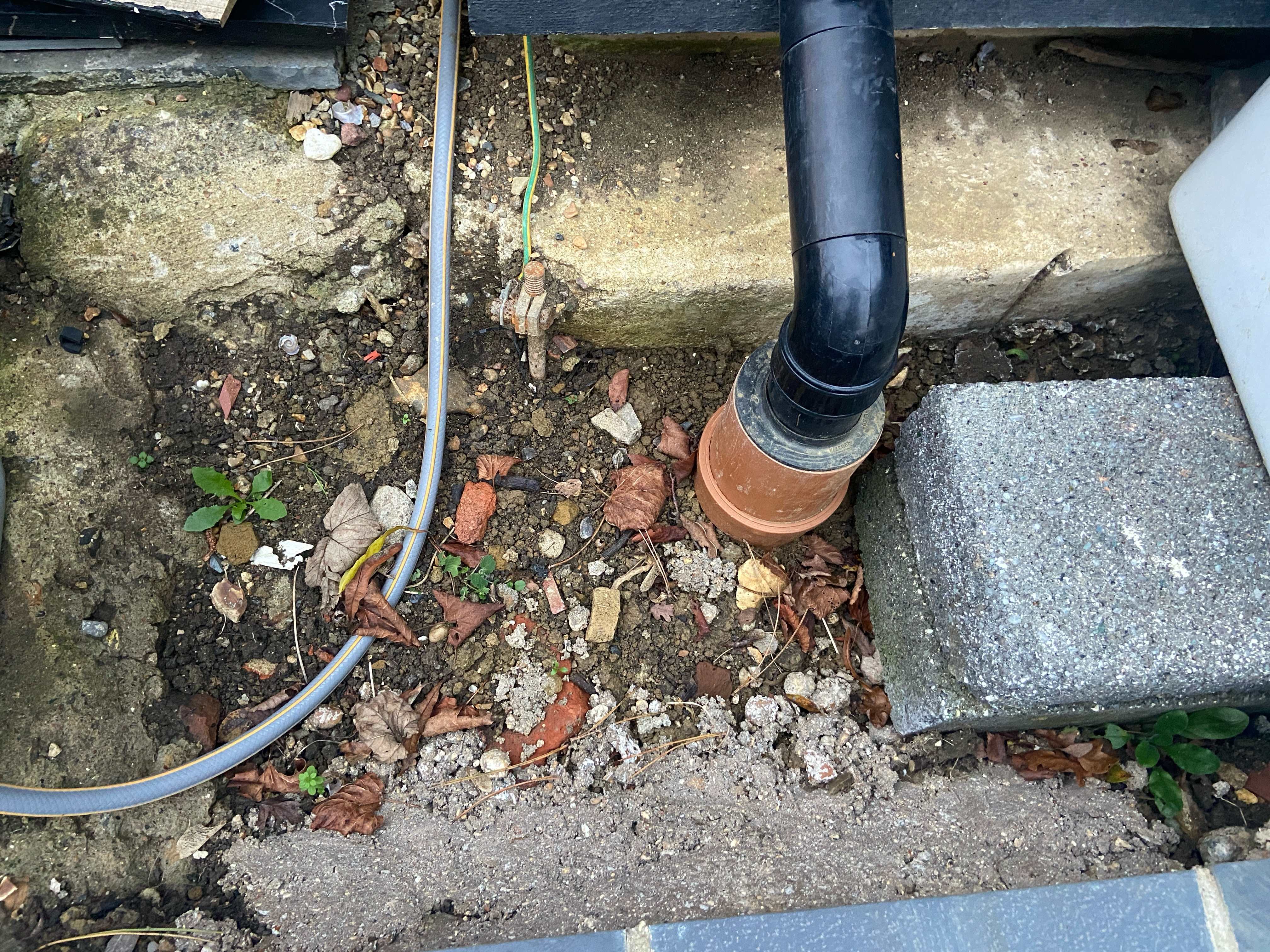

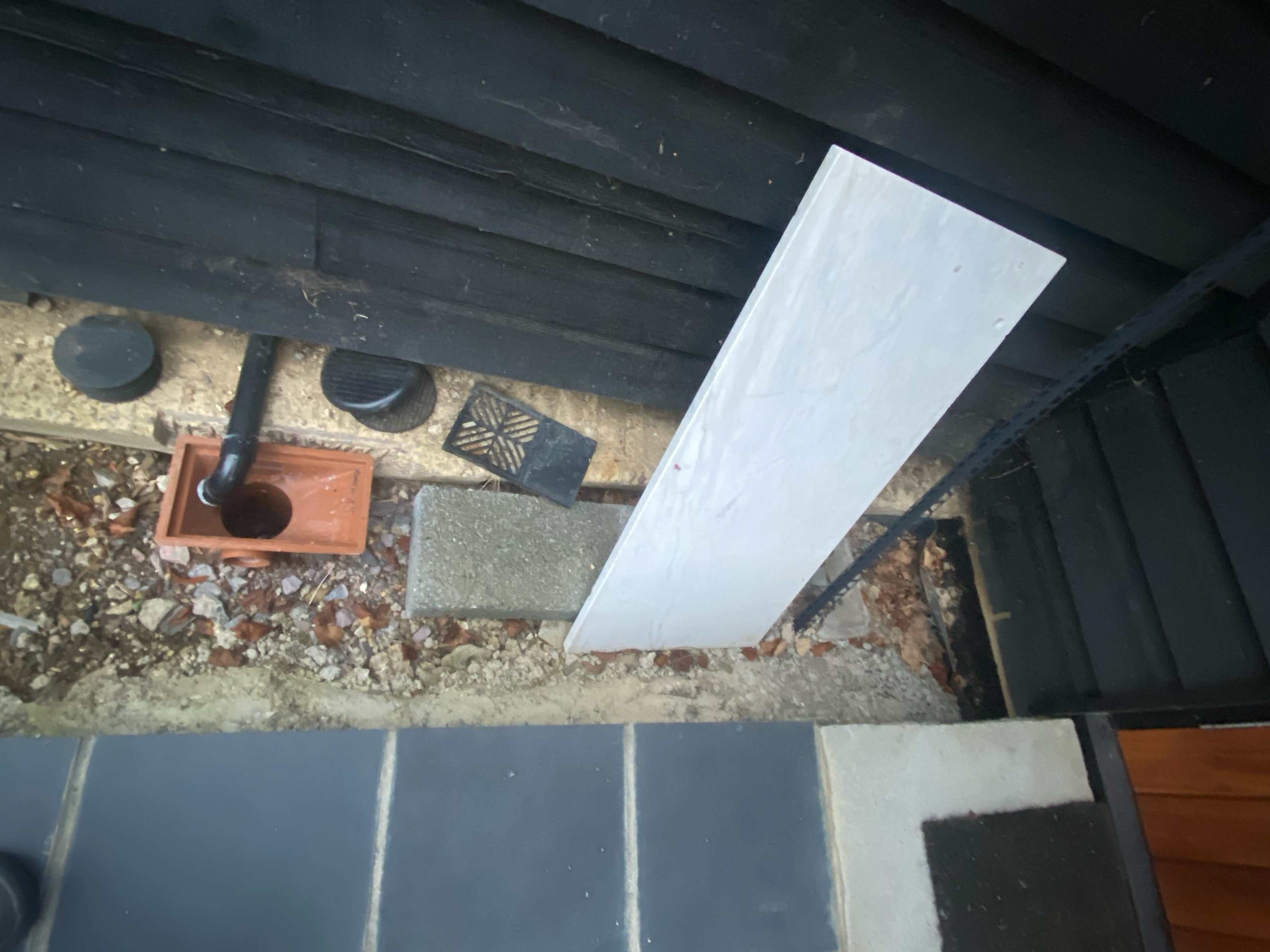

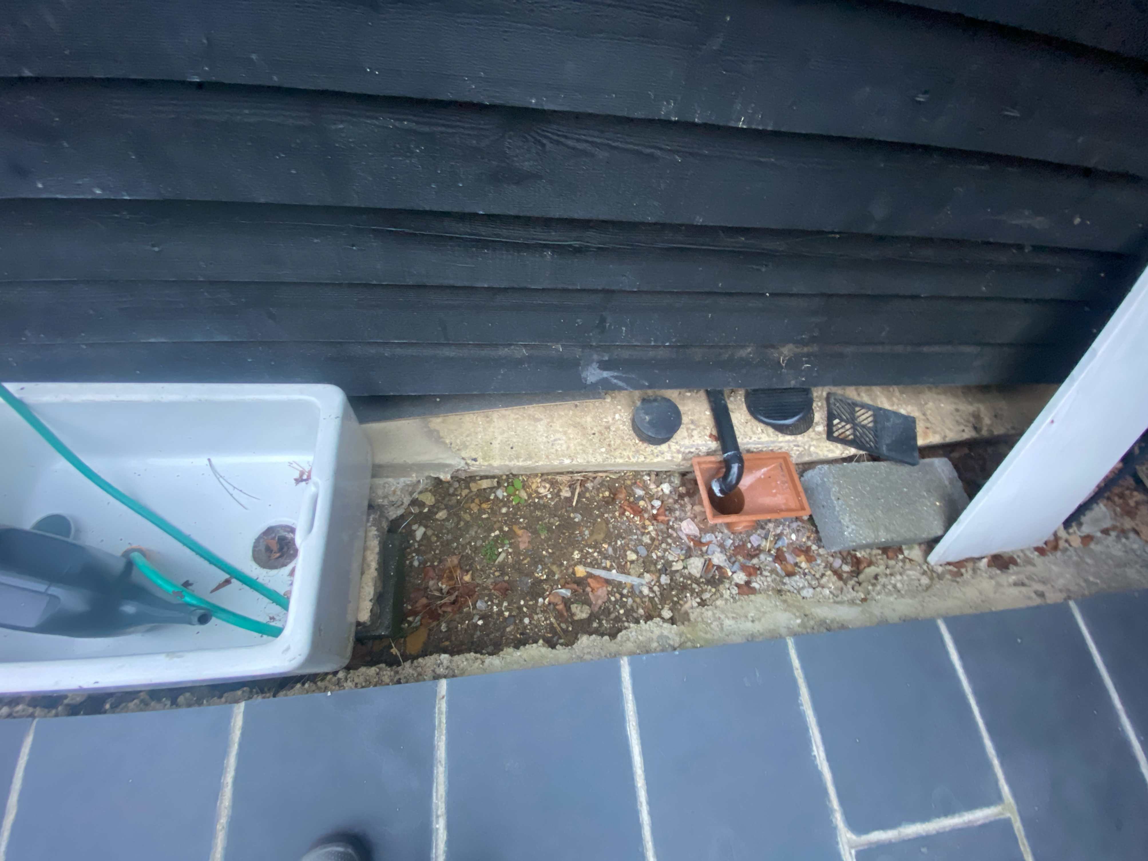

Jilly Posted November 8 Share Posted November 8 (edited) We have had a raised path made up parallel to the side of the house and so have dug out the area alongside the (600mm) foundations (on clay). It’s left a kind of gulley: Should I back fill it with gravel (and will this be ‘strong’ enough?). The gulley seems to have a slight slope towards the corner of the building and the (hopefully sound) drainpipe and it’s a tad damp there. I’m not sure if that’s minor leak or water seeping in that direction. I’m wondering if I can ignore this if I fill it with gravel? Also there’s an earth spike slightly exposed, should that be in clay? The Belfast outdoor boot sink hasn’t been connected up yet. Apologies, the detritus in view is because of my CBA. Thanks @ToughButterCup! Edited November 8 by Jilly Link to comment Share on other sites More sharing options...

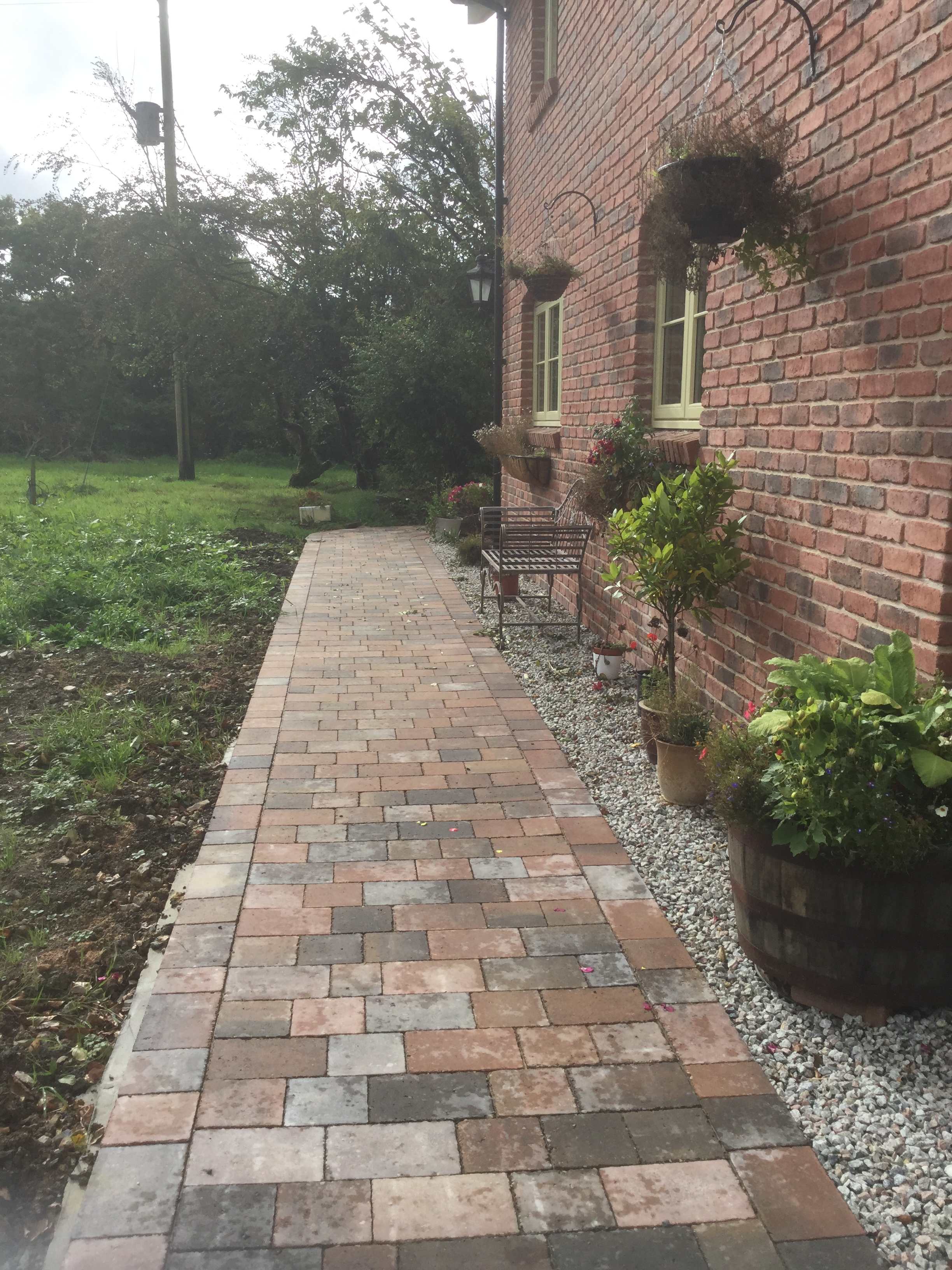

joe90 Posted November 8 Share Posted November 8 (edited) 7 minutes ago, Jilly said: will this be ‘strong’ enough? Not sure what you mean by this, imo gravel is perfect especially around the boot sink (great idea) my build was surrounded by gravel (crushed granite) because of a high water table and worked perfectly (and looked good). Edited November 8 by joe90 2 Link to comment Share on other sites More sharing options...
Redbeard Posted November 8 Share Posted November 8 Are you expecting it to pick up much water? (Does the path fall towards it, for example?). I have incorporated a perforated pipe, with the gravel over it, (and a drain connection at the end) at the base of my EWI. 1 Link to comment Share on other sites More sharing options...
ToughButterCup Posted November 8 Share Posted November 8 2 hours ago, Jilly said: ... Should I back fill it with gravel (and will this be ‘strong’ enough?). ... I’m wondering if I can ignore this if I fill it with gravel? ... Also there’s an earth spike slightly exposed, should that be in clay? Yes. Yes. Its fine where it is. My CBA affects me more on Friday than any other day of ther week. 1 Link to comment Share on other sites More sharing options...
ProDave Posted November 8 Share Posted November 8 What is that hopper next to the boot sink and what is that black pipe discharging into it? 1 Link to comment Share on other sites More sharing options...
Jilly Posted November 8 Author Share Posted November 8 6 minutes ago, ProDave said: What is that hopper next to the boot sink and what is that black pipe discharging into it? That's the sink/washing machine/dishwasher outlet into the foul drain Link to comment Share on other sites More sharing options...
