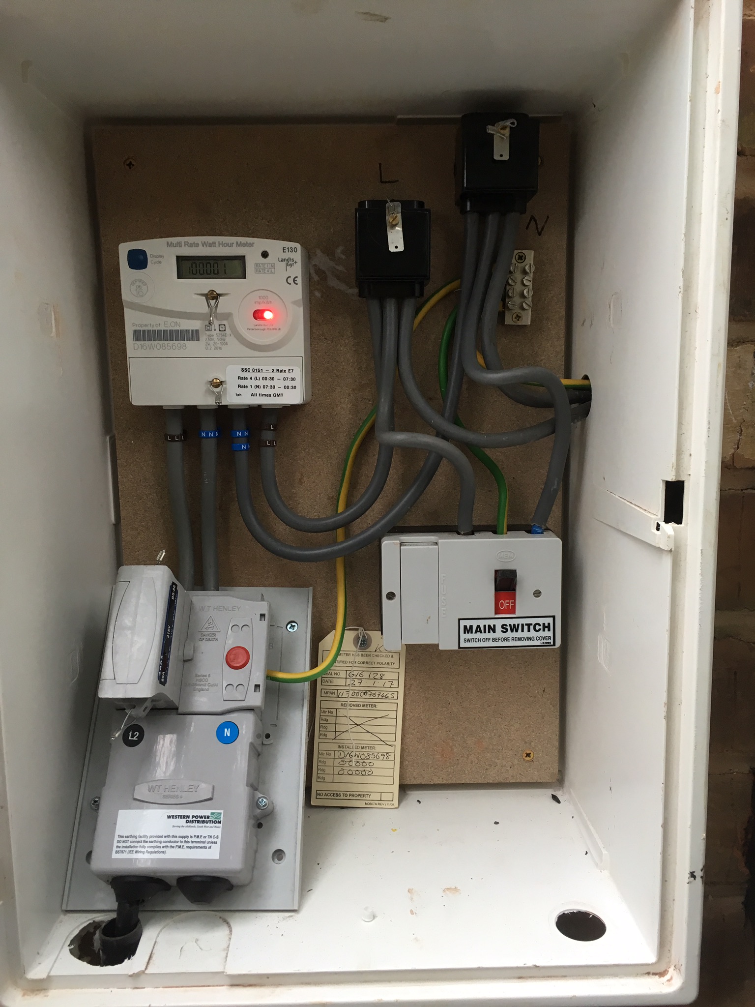

ToughButterCup Posted November 16, 2017 Share Posted November 16, 2017 I have bought the meter box. Before I fit it to the wall above the hockey stick today I need to drill a hole so that the cable can be fed into the box. Does that hole have to have some sort of rubber grommet or gland to keep the water out? Or can I just drill a hole the same size as the hockey stick? Link to comment Share on other sites More sharing options...
ProDave Posted November 16, 2017 Share Posted November 16, 2017 Flush or surface mount box? Hockey sick on the surface or in the wall? Either way the hockey stick wants to come up in the left side of the meter box. You should see marks to guide you where to drill the hole. A flush mounted box, you can bring the hockey stick up within the wall and it enters near the back of the box. Alternatively it can come up the wall on the surface and enter within the flange of the box, you should see a marking of where to drill the hole, again towards the left. With that arrangement they put a sloping bit of wood in the box to fix the supply head to usually. Link to comment Share on other sites More sharing options...
PeterW Posted November 16, 2017 Share Posted November 16, 2017 53 minutes ago, ProDave said: Alternatively it can come up the wall on the surface and enter within the flange of the box, you should see a marking of where to drill the hole, again towards the left. With that arrangement they put a sloping bit of wood in the box to fix the supply head to usually. Our box had a hole in the bottom of the front flange to allow the cable to enter - no hockey stick at all for Western Power .! They also have a wedge shaped connector with the fuse in it - really neat way to get the tails onto the meter. Link to comment Share on other sites More sharing options...

PeterW Posted November 16, 2017 Share Posted November 16, 2017 Found it ... Link to comment Share on other sites More sharing options...

ProDave Posted November 16, 2017 Share Posted November 16, 2017 If it's a surface mount box then the entry will be rear left. Here's mine, I drilled a bigger hole to take the duct straight to the meter box. Link to comment Share on other sites More sharing options...
