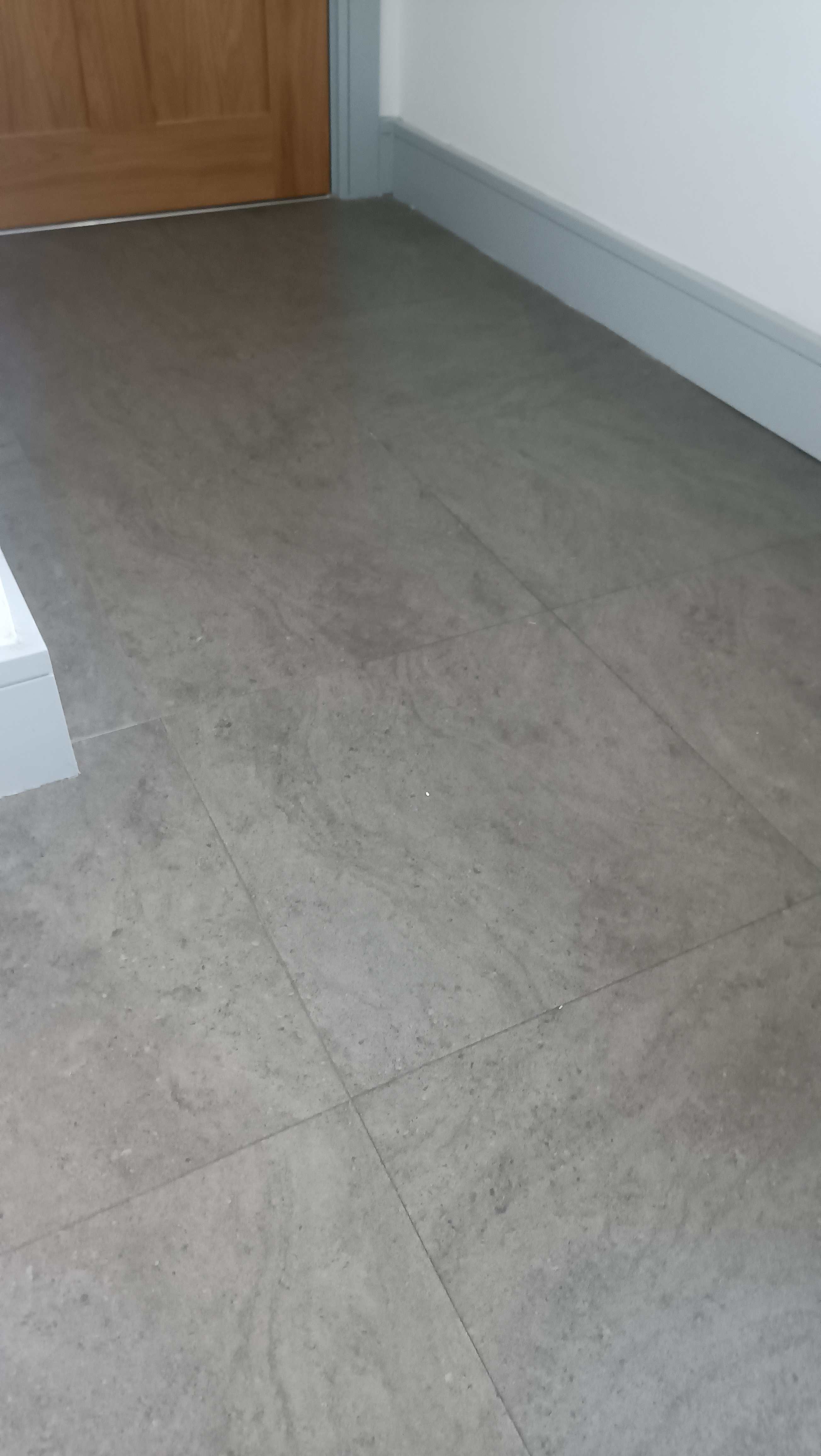

Iceverge Posted November 7, 2024 Share Posted November 7, 2024 12 hours ago, G and J said: My 25m2 garden building doesn’t have to comply with regs and we won’t be throwing money at it as it is just a man cave, but I still want it nice and useable. This idea would solve my ‘getting concrete down the bottom of the garden after we’ve built the house’ problem. I’m keen. Having used amtico in the bathrooms I'd have no issue using it in a wet room. I can't see how it would be less effective than tiles. I'm dreading the day we have to remove ours. Whatever glue they gave us is tough stuff. I also despise hard tiles floors from a comfort and safety perspective. 1 Link to comment Share on other sites More sharing options...
CalvinHobbes Posted November 7, 2024 Author Share Posted November 7, 2024 Iceverge did you use the planks or stick down? Link to comment Share on other sites More sharing options...
Iceverge Posted November 7, 2024 Share Posted November 7, 2024 Square stick down tiles. I wouldn't use the click together floating ones as I'd be afraid of water getting under them. 1 Link to comment Share on other sites More sharing options...
CalvinHobbes Posted November 7, 2024 Author Share Posted November 7, 2024 Thank you, I have the square stick down ones. Happy days. How did you do the sides? Link to comment Share on other sites More sharing options...
Iceverge Posted November 7, 2024 Share Posted November 7, 2024 I just did the floor. 1 Link to comment Share on other sites More sharing options...
CalvinHobbes Posted November 9, 2024 Author Share Posted November 9, 2024 (edited) Iceverge Thank you, was it an actual wet room? Can you recall products you used to waterproof, adhesive and cover in top? Nervous because everywhere is saying you can't. Only other solution that seems ok is this creative resin like in swimming pools but then what do I use for the actual drain? Is it the one for vinyl not tiles? Sorry self build hub, we are moving in 3 weeks so pressure is on. It's overwhelming! https://search.app?link=https%3A%2F%2Fcreative-resins.co.uk%2Fnon-slip-floor-paint%2F%23%3A~%3Atext%3DCreative%20Resins%20brings%20to%20you%2Cdemands%20such%20as%20wet%20rooms.&utm_campaign=aga&utm_source=agsadl1%2Csh%2Fx%2Fgs%2Fm2%2F4 Edited November 9, 2024 by CalvinHobbes Link to comment Share on other sites More sharing options...
scottishjohn Posted November 9, 2024 Share Posted November 9, 2024 from watching my floor fitters doing my LVT floors they would not consider it without a self leveling layer to start with and then lots of time spent checking it for actual level and cleaning every spec of dust then and only then did they start laying tiles and use a heavy garden roller type thing to make sure they are down flat after laying no UFH for 2 days at least ,then very low heat for a week to make sure everything is happy OHH and a humdity reading of less than 3,7% in subfloor before self levelling applied more than that could cause lifting of tiles over time with trapped moisture trying to get out 1 Link to comment Share on other sites More sharing options...
Iceverge Posted November 10, 2024 Share Posted November 10, 2024 22 hours ago, CalvinHobbes said: Iceverge Thank you, was it an actual wet room? Can you recall products you used to waterproof, adhesive and cover in top? Nervous because everywhere is saying you can't. Only other solution that seems ok is this creative resin like in swimming pools but then what do I use for the actual drain? Is it the one for vinyl not tiles? Sorry self build hub, we are moving in 3 weeks so pressure is on. It's overwhelming! https://search.app?link=https%3A%2F%2Fcreative-resins.co.uk%2Fnon-slip-floor-paint%2F%23%3A~%3Atext%3DCreative%20Resins%20brings%20to%20you%2Cdemands%20such%20as%20wet%20rooms.&utm_campaign=aga&utm_source=agsadl1%2Csh%2Fx%2Fgs%2Fm2%2F4 Not an actual wet room, just the bathroom floor. I'll have to go to the shed to find the adhesive. It was some magic stuff from Poland from memory. I used tanking paint over the floor first and then SLC over that . I second the need to have the floor immaculate though. I left a grain of dirt under one of the tiles and you can feel it with your toes. On a separate note take a day off. Get ugly with everyone about the moving date and push it back. I gave myself the world of stress with this, baby enroute etc. Absolutely not worth it. It's only a house. 1 Link to comment Share on other sites More sharing options...
