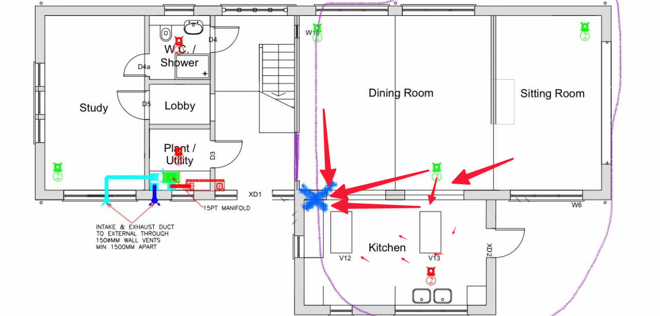

I have come to a problem that I don’t know how to get around with my DIY installation. I have a wooden beam above a doorway (see picture) and in order to supply the side of the house through the doorway (both ground and first floor) I will need to get 15 of the 75mm pipes through here. I can’t manage this without seriously weakening this wooden beam. There is no other route to the other side of the house.
i have attached the floor plans, the purple line is where the wooden beam is and the purple circles are where I’m struggling to reach.
Does anyone have any ideas/suggestions??

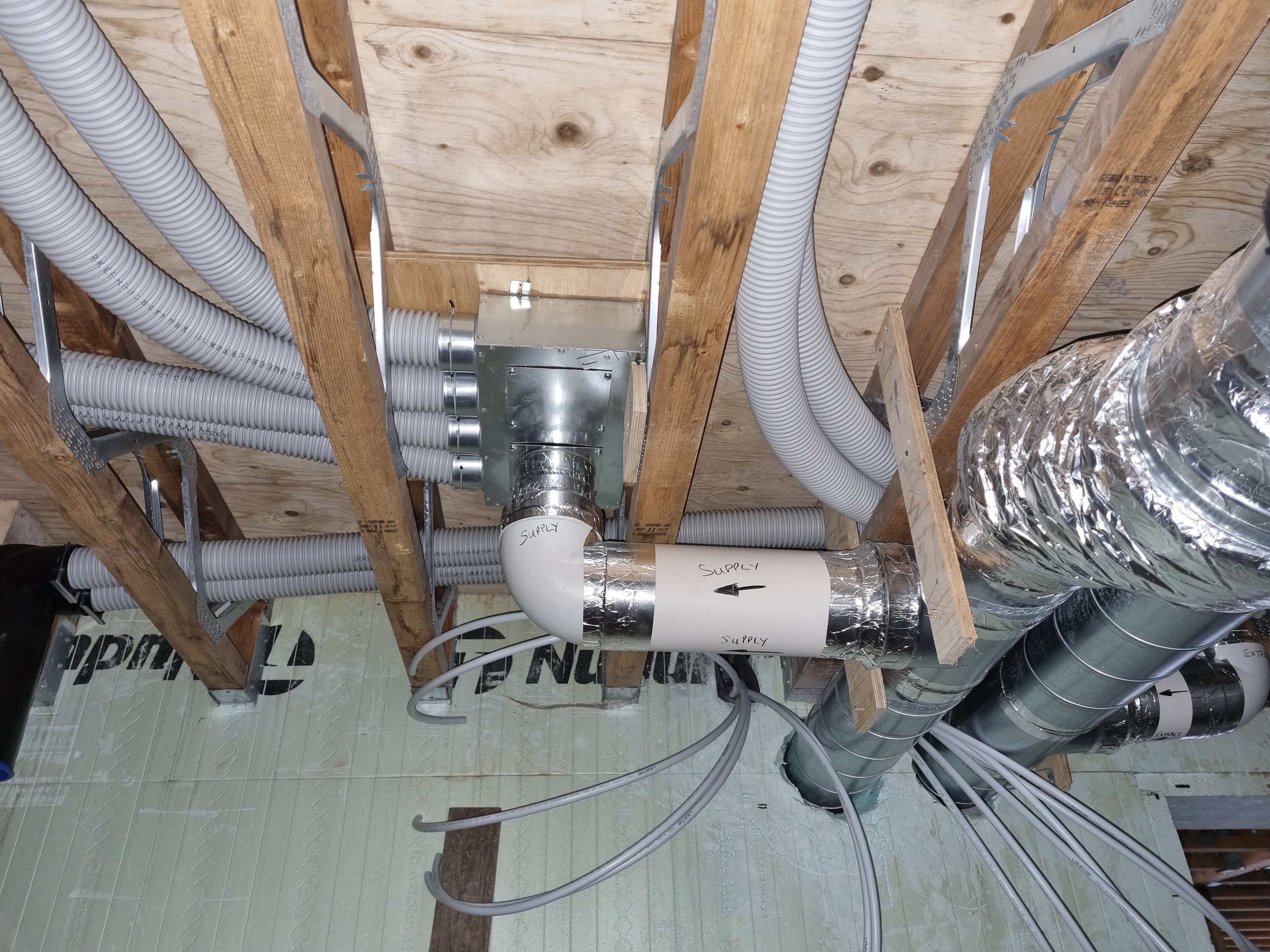

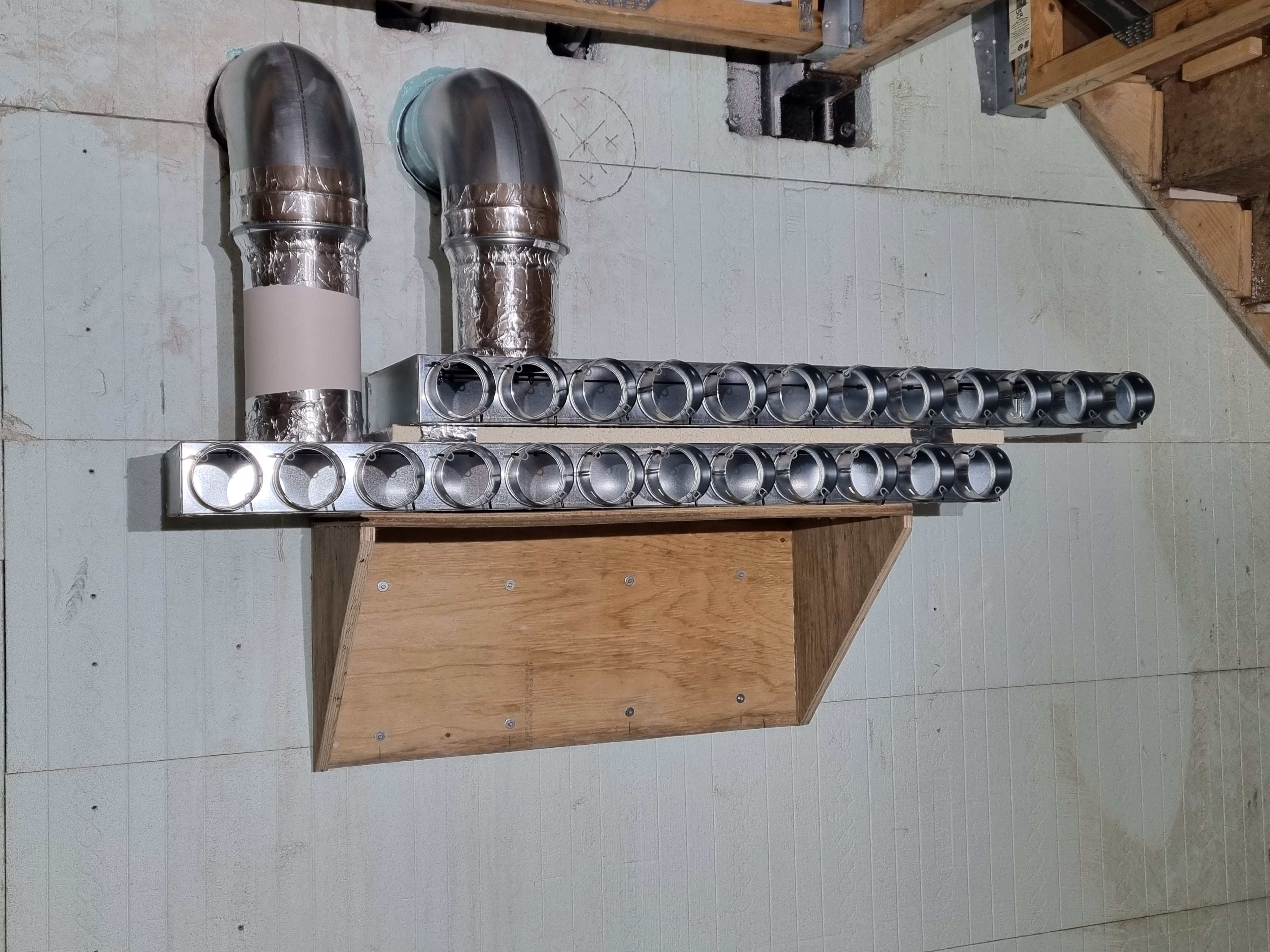

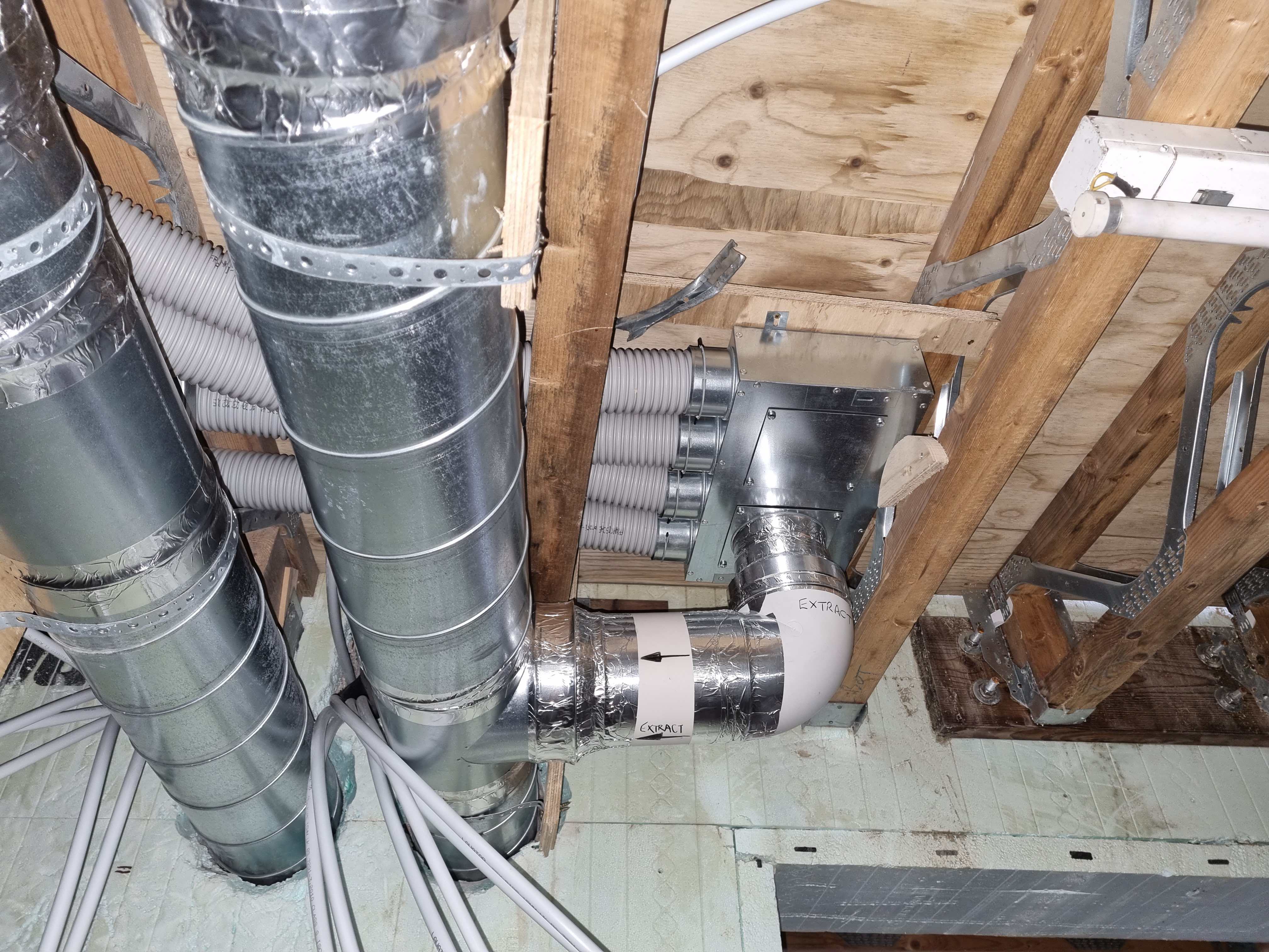

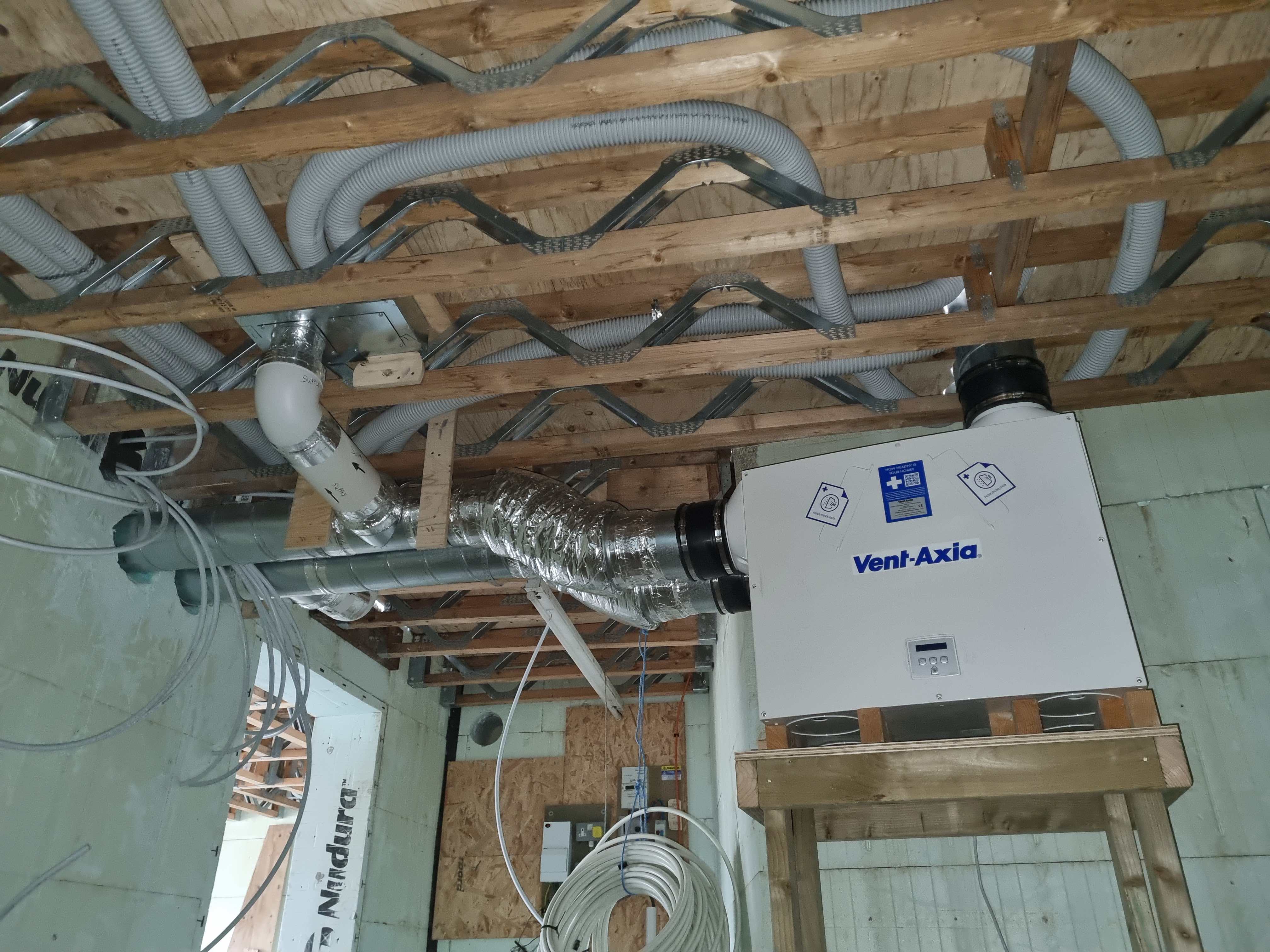

You could certainly feed 2 separate manifolds, one for each side of the beam.
This is what I had to do, through a 200mm concrete wall!!
Unit in plant room
Two x 180mm feed and extract pipes
Tees of the above to two distribution boxes on one side of the wall, and the 180mm go thru the concrete to two more distribution boxes
Unit in plant room
Yes I think this is what I’m imagining! Did you get this from bpc? Thanks for your help! The pictures are really useful

It's not required to vent the rooms, however you appear to have 8 ducts pumping air into the ground floor, and you need to pump that same amount of air out from somewhere. If you have only 4 extract pipes, the airflow in them will (on average) therefore have to be twice as fast, and that speed could be more than recommended to avoid noise. You'd need the calculations to know if that's so, but it's possible.
17 minutes ago, AppleQueen said:
I actually think I’m going to have to put those extract ducts just outside the kitchen into the dining room where the column is on the plan because I can’t find anyway to get them into the kitchen otherwise.
You do need extract directly from the kitchen, but away from the hob, and ideally on the far side so that the air flows across the room. As a compromise a wall-mounted vent could work (in the kitchen-dining room wall), unless you want to make to make a feature of a suspended metal pipe & vent.

Do you think a wall mounted vent here where I’ve put the blue cross would work? Facing into the kitchen? Thanks
If it's not too close to the hob it could.
Another possibility may be to run concealed ducting boxed in over the top of the kitchen cupboards, if you have any, to give more flexibility.
I don't. With what looks to be an open plan setup, the air will mostly go from the supply vents straight to the extract vent, creating a dead space in the kitchen. I've tried to show that with arrows on the picture below.
