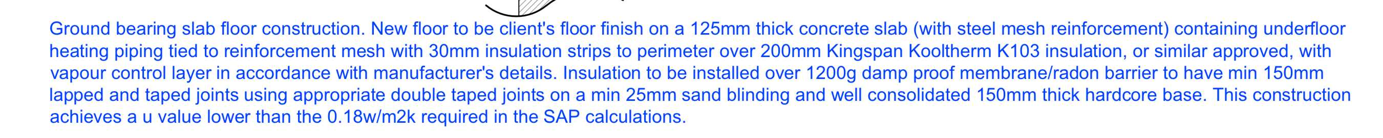

Wil Posted November 11 Share Posted November 11 Hmm spec for my retro fit floor is hardcore and sand 160mm. 200mm PIR. 150 concrete. Pipes in the concrete. Tiles likely on top. Sounds like there are options to cut 50mm off the concrete at least. So useful post. The 200mm was me insisting on exceeding BR, architect and contractor not keen. I have a QS cost for rates of digging I can try and find if useful. Link to comment Share on other sites More sharing options...

Wil Posted November 11 Share Posted November 11 I lied- here’s the spec- it’s 125mm concrete and much more hardcore/ blinding: Link to comment Share on other sites More sharing options...
saveasteading Posted November 11 Share Posted November 11 1 hour ago, Wil said: it’s 125mm concrete and much more hardcore/ blinding: OK. what thickness might help you practically? This is a house so nobody is going to break the floor. The weakest layer is of course the insulation. After that the loads are very well spread over the stone below. If the hardcore is good quality , ie not a heap of old bricks, then that can be reduced in thickness. Likewise the sand. The sand is there for adjusting the level so there might be none above the highest point in the stone. so i am suggesting 100mm concrete, on 150 PIR, on 150 of stone and sand (total). that is still 400mm which is a lot to dig out, but a lot less than 500. IFFFFF you do it to a high standard of level control and compaction. Link to comment Share on other sites More sharing options...
Wil Posted November 12 Share Posted November 12 Realistically, every little helps. That’s a useful breakdown, thank you- I’ll discuss with the contractor who’s bidding. A couple of questions if I may? In my spec above it looks like there’s a vapour layer over the insulation with a damp membrane/ radon barrier under. Is this second barrier necessary? I was imagining pinning the UFH pipe to the insulation direct with the concrete and reinforcement poured directly on top (or even follow the spec and tie to the rebar). Does 100mm concrete differ from 100mm screed poured? Link to comment Share on other sites More sharing options...
saveasteading Posted November 12 Share Posted November 12 You only need one layer of plastic. Choose a radon spec and it does the dampness thing too. You need an extra plastic layer on top of the pir as it stops concrete or grout from running into gaps and floating it. I've seen it and isn't fun. Screed or concrete. Either will do. BUT I would say put a thin concrete screed down for the pir to sit on, and then 60mm pumped screed goes on top with the ufh in it. Link to comment Share on other sites More sharing options...
Wil Posted November 13 Share Posted November 13 So that would be 100ish hardcore, sand, concrete(how much?), 150mm insulation, plastic membrane, 60mm screed with UFH pipes? Link to comment Share on other sites More sharing options...
saveasteading Posted November 13 Share Posted November 13 This is becoming non standard but then so is ( to me) having insulation straight on stone. So I'm going to say, stone as thick as you like...but at least 100, laid really flat and with 0 to 10mm max sand blinding but zero if you can. Dpm, to radon spec if necessary. Then a concrete screed about 75mm, hand tamped and nicely level. A light mesh (A142) would be a nice touch. Shop around. 150mm insulation Dpm, taped, any spec as it is only to close the joints. Ufh pipes pegged to the pir. 60mm pumped screed. I like the level control in this, so the thicknesses are controlled. Plus having the lower screed keeps it all clean and the pir laid solid. BUT it depends who is doing it. Link to comment Share on other sites More sharing options...
