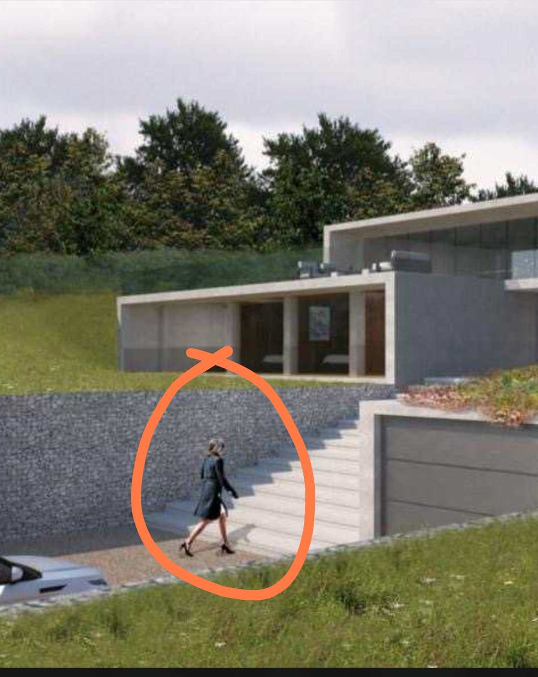

Iceverge Posted October 29, 2024 Share Posted October 29, 2024 (edited) The more I look at it the more I think the comment above about it just being "a design to secure planning permission" makes more and more sense. Its baffling how the designer expected the roof over the kitchen to stay up. If it is concrete it could weigh 250 tonnes and yet seems to be supported only at the end and them in turn partially below by fresh air. There is some artistic licence with the sketches too and they seemed to have moved it to the southern hemispheres with some of the sketches looking at the shadows. This makes it all look much sunnier and more inviting that a Northern Elevation is in reality in our neck of the woods. Edited October 29, 2024 by Iceverge Link to comment Share on other sites More sharing options...

Gus Potter Posted October 29, 2024 Share Posted October 29, 2024 On 28/10/2024 at 20:34, LadybuilderLOL said: Hey guys Hiya and thanks for posting on BH. I've had a quick look at what you propose. With my SE hat on.. because it it so big you probably have loads of stiff structural floors / roof deck.. unless there is a massive atrium. This can be an economic form of construction. The size tends to lean towards standard commercial building construction.. nothing new and you should get competetive prices for a project of this scale.. it's basically office construction that is fitted out as a house with enhanced U values, heating / cooling systems etc. Looks great to me! Keep posting. Link to comment Share on other sites More sharing options...

Firsttimer Posted November 5, 2024 Share Posted November 5, 2024 (edited) Very exciting. I'd initially budget at the very least £3k a metre squared and not allowing for any spendy finishes. This doesn't include fees. It might be worth getting an engineer engaged at the planning stage given a lot of the wall will be retaining. Edited November 5, 2024 by Firsttimer Link to comment Share on other sites More sharing options...
