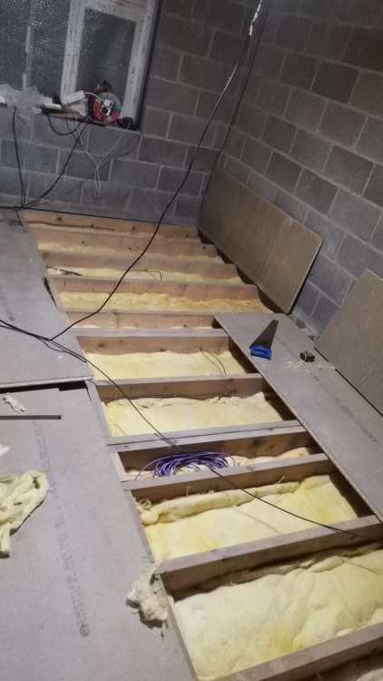

SuperGlass acoustic. 100mm enough?
Evening.

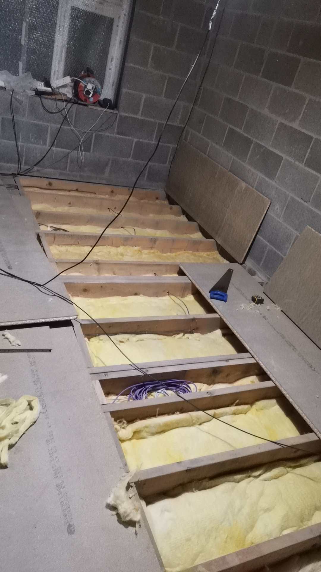

I've added 100mm acoustic wool (SuperGlass) between the joists between the ground and first floor. The ground floor has UFH but upstairs has rads, which I hope to never use.
Question is, is the 100mm enough to balance out the sound absorption and "slight" heat transfer I require? Deck is 22mm, ceiling is standard 12.5mm.
Id rather not hear the missus stomping around to the latest Taylor Swift rubbish, but I don't want a bedroom that is absolutely baltic either. Any thoughts? Banana for scale.
I suspect that if you generally leave the doors open that will take care of warming the upstairs.
There are two ways sound is transmitted through the floor: airborne sound and structure-borne sound. The insulation you've added takes care of airborne sound, so it will deaden the noise of Taylor Swift from above. However, it will do pretty much nothing to deaden your missus dancing around. To deal with that you'll need to add some kind of cushioning over the joists - a thick underlay if you're putting down carpet, or better decouple the floor deck from the joists (or the ceiling below from the joists) to reduce the sound transmission.
Others here have more practical experience than I do - I've been focused on airborne sound transmission.
I'm not an expert either soso anyone who has a better practical understanding of it please enlighten me more.
None the less, this is the internet so I'm going to present my opinion as fact  regardless!
To mitigate sound transmission.
1. Airpaths - lots of acoustic mastic at any joints and at the walls. Seal all gaps.
2. Reverberation - A layer of fluffy stuff just to stop the drum effect. The stuff you've done is fine. Infact any more will only add slightly more mass and risk increasing the coupling effect of the floors.
3. Impact noises - decouple the surfaces. Carpet, foam strips under floorboards, resilient bars downstairs.
4. Add Mass. Plasterboard, standard or soundbloc or OSB is the cheapest way. Upstairs or downstairs . The more kg the merrier.
"Acoustic" insulation adds more mass than regular insulation but it's an expensive method of buying mass.
