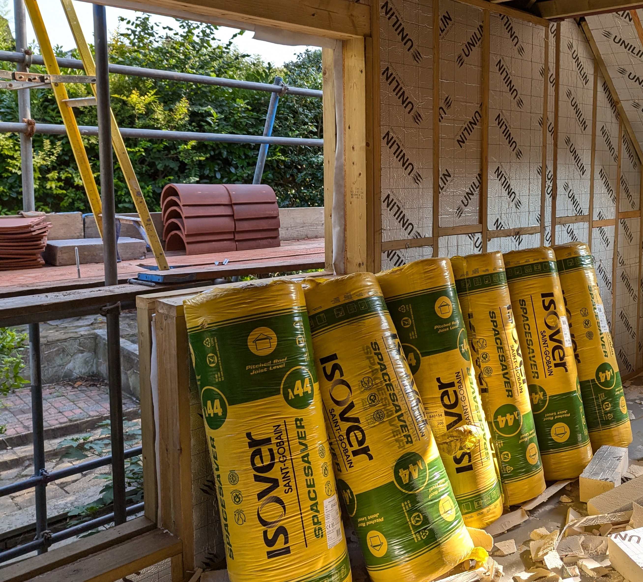

I have the weekend free. It would be about £250 in materials for me to stick some Isover 100mm Spacesaver within this extra cavity/within the secondary studwork line. Money is tight at this stage of the build, but it would be a lot more expensive to add more insulation at a later date.
Is this overkill? Our SAP calcs don't require it, but is more always better

I think the bonded bead boat has sailed, as the OP intends (or not) to install mineral wool this weekend. It will be better than a poke in the eye with a sharp stick, but check for and block any air-leakage and sort it as you go along. I see no reference to vapour control layer (VCL), except that the insulated plasterboard may have one, but only where the joints aren't. Worth doing that condensation risk assessment. 'Feels' like it may be OK (except that air leakage within the 'sandwich' isn't) but I am not CRA software.

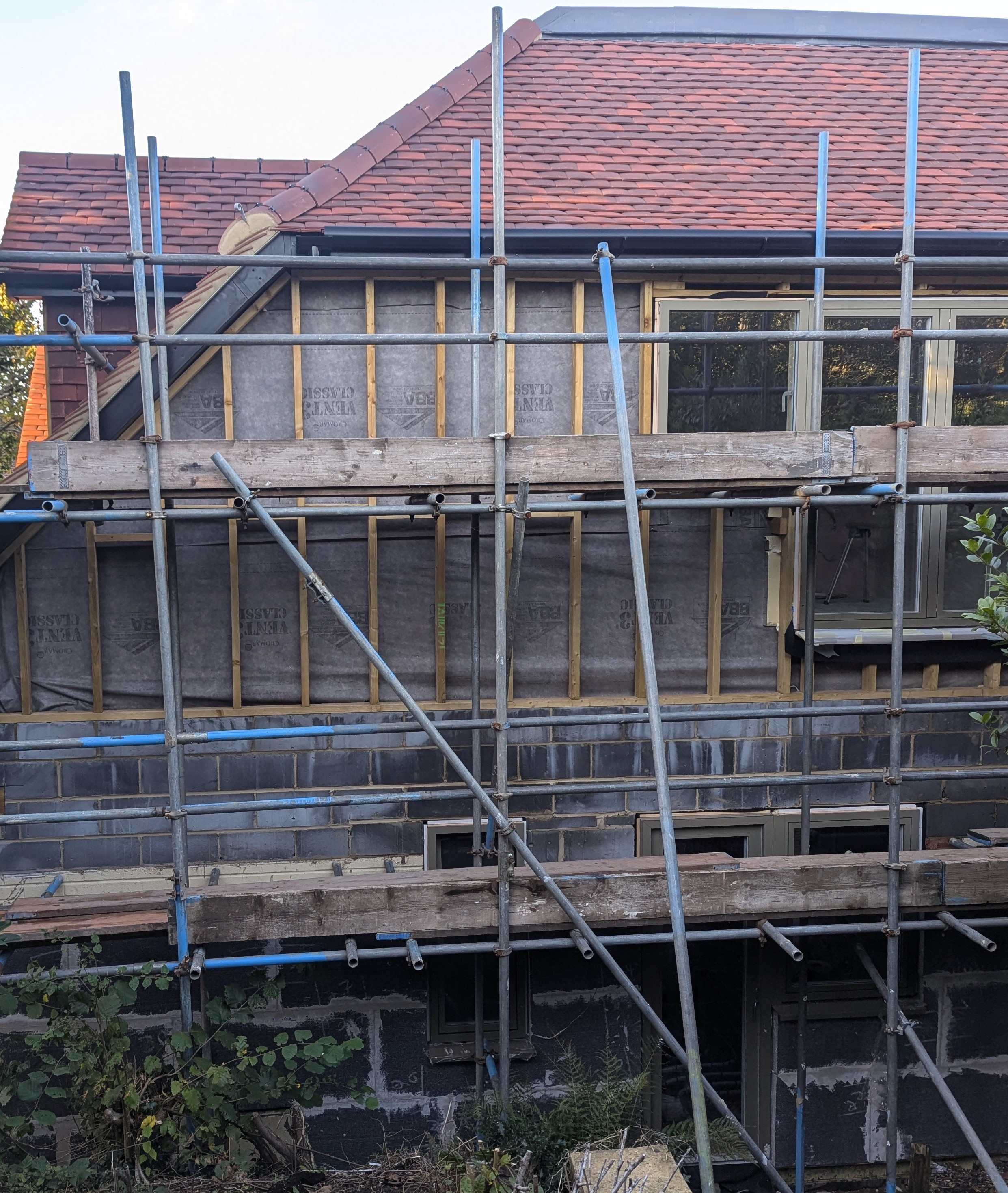

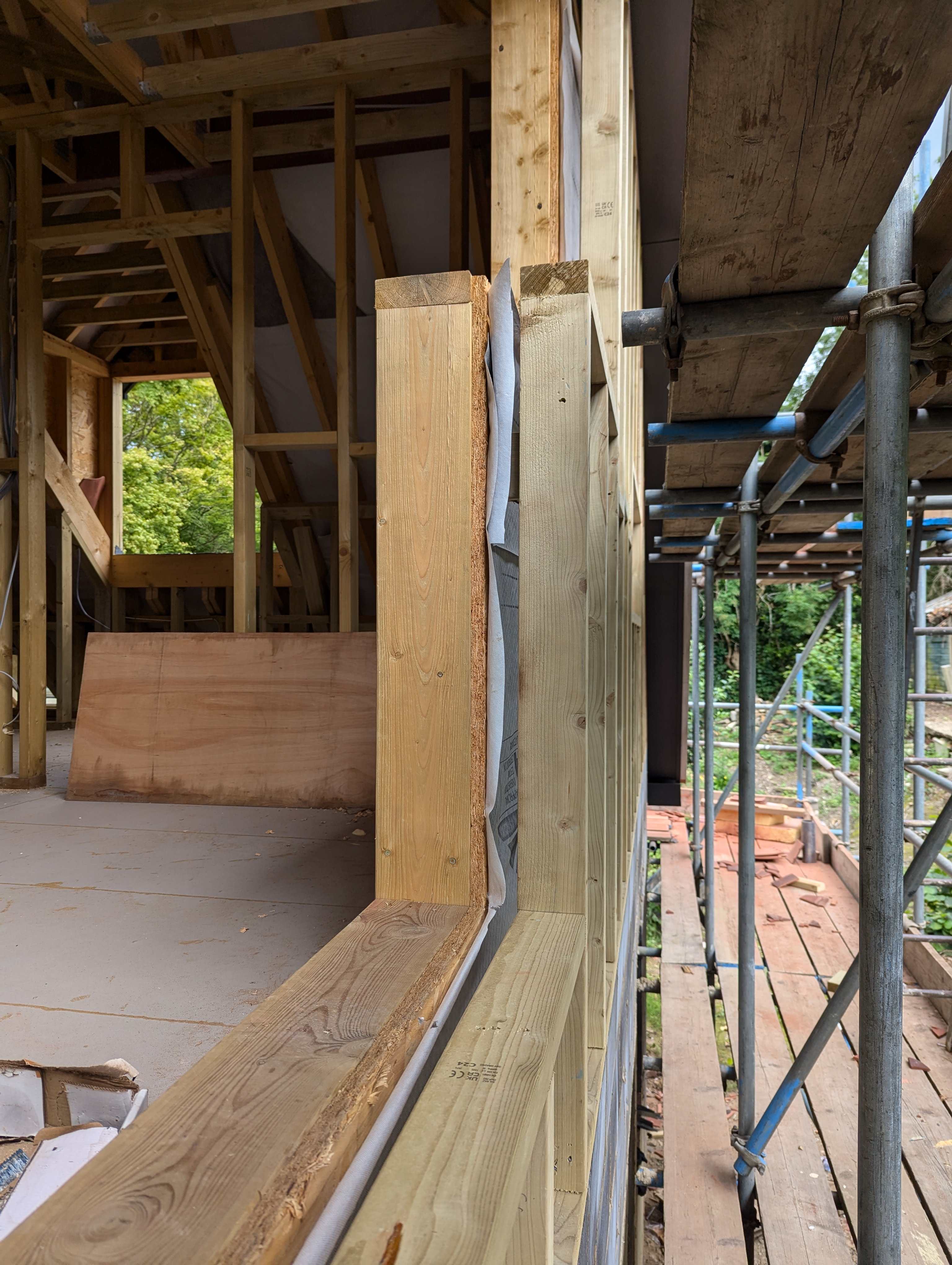

Here is a photo of the gable.
You can see the external line of studwork.
VCL laid over 22mm OSB set behind this.
Behind that is the 150mm PIR set within the internal stud wall, and faced with 50mm insulated plaster board.
The cheeks of the dormers are tile hung. You can just make one out in the photo.
The external insulation has already begun being fitted to the ground floor and can be seen in the photo.
The plan was for a silicone render over all of this.
Who did your insulation and air-tightness strategy? Do you know for certain that there is no chance of air movement in the 'sandwich'? If the air-tightness within the depth of the upper wall is not really good then the EPS could be just a fat expensive render board, potentially doing nothing to the sum total of insulation. How deep is the cavity in the gr floor walls? Then we can maybe roughly work out relative GF and FF insulation values. Without more info I think it's too early to make any call on additional insulation, or not.
Edited by Redbeard

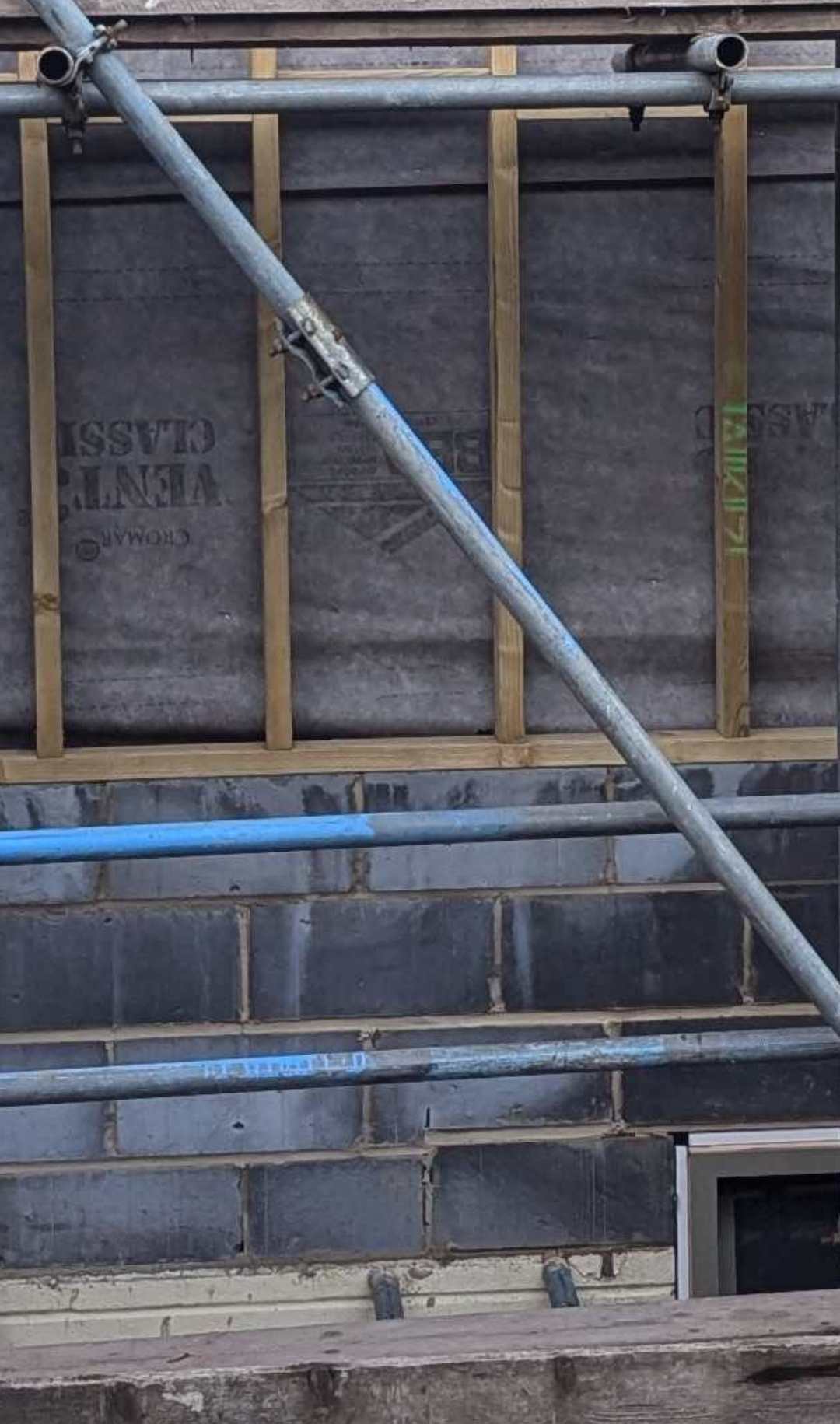

Ok so not EPS direct onto the OSB in that case. Not catastrophic but.....
Screenshot_2024-10-24-12-12-44-154_com.android.chrome-edit.thumb.jpg.feafdc3c84935a45dbeeb5a288a16f6d.jpg

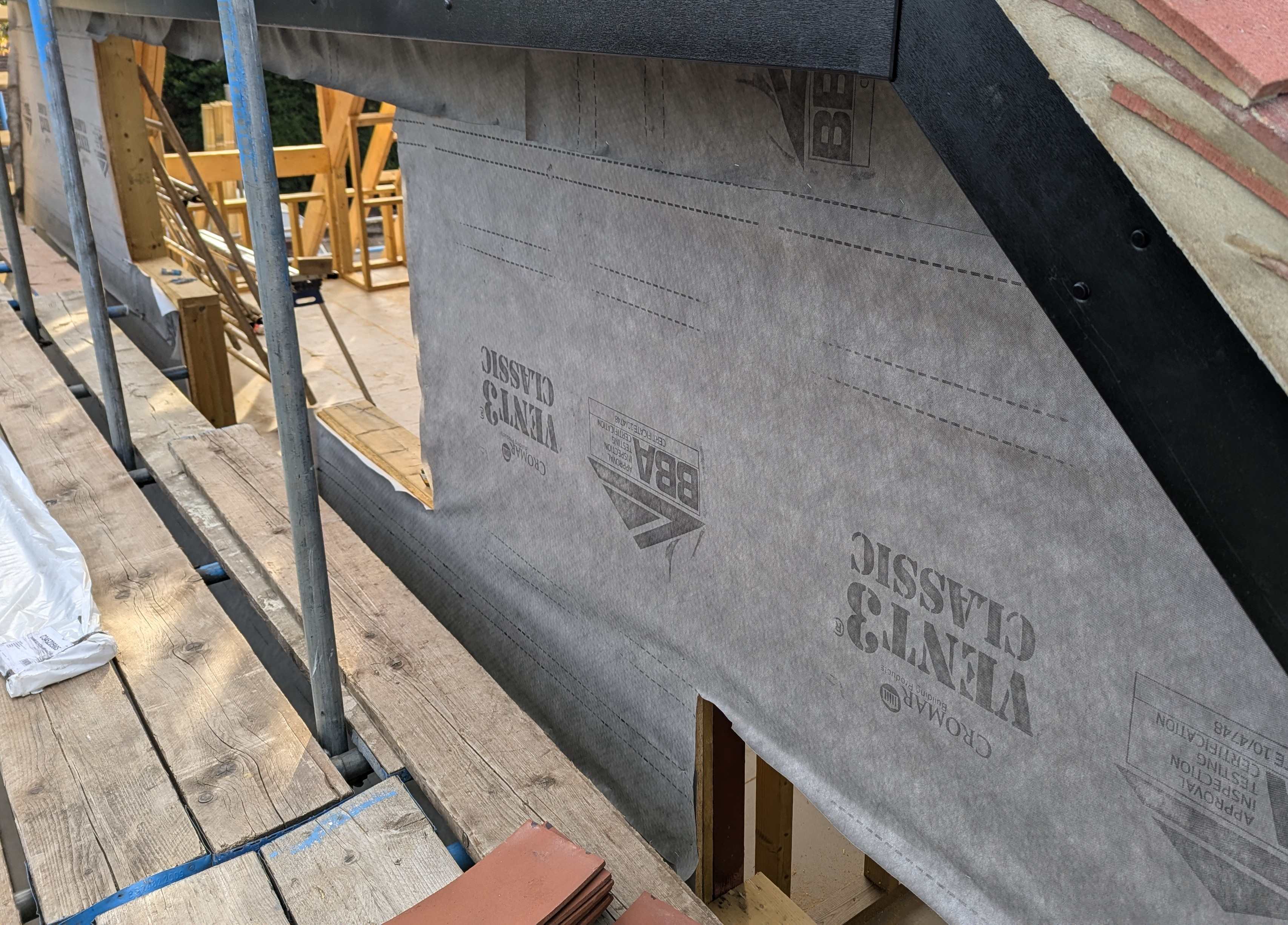

However this detail I wouldn't be too chuffed about.

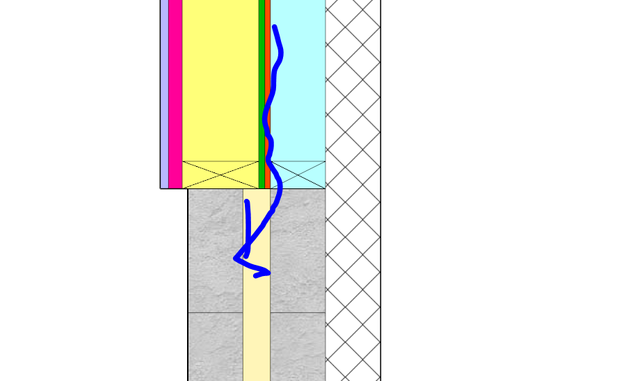

That membrane is the barrier between the water and you. Any drips that get in will run down and disappear into the old cavity by the looks of things. Not ideal and may well make itself known inside your house at a later date and you'll have no idea where the leak is coming from.
EPS over this ventilated gap  like @Redbeard mentioned will be just a render board.
I think this needs to be sorted on paper before any further work is done. Never mind insulation for now. Keeping water out is far more important. I have some suggestions but I'd like to get more photos and drawing if you have them.

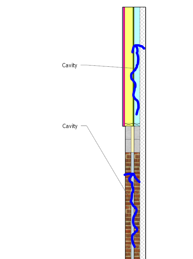

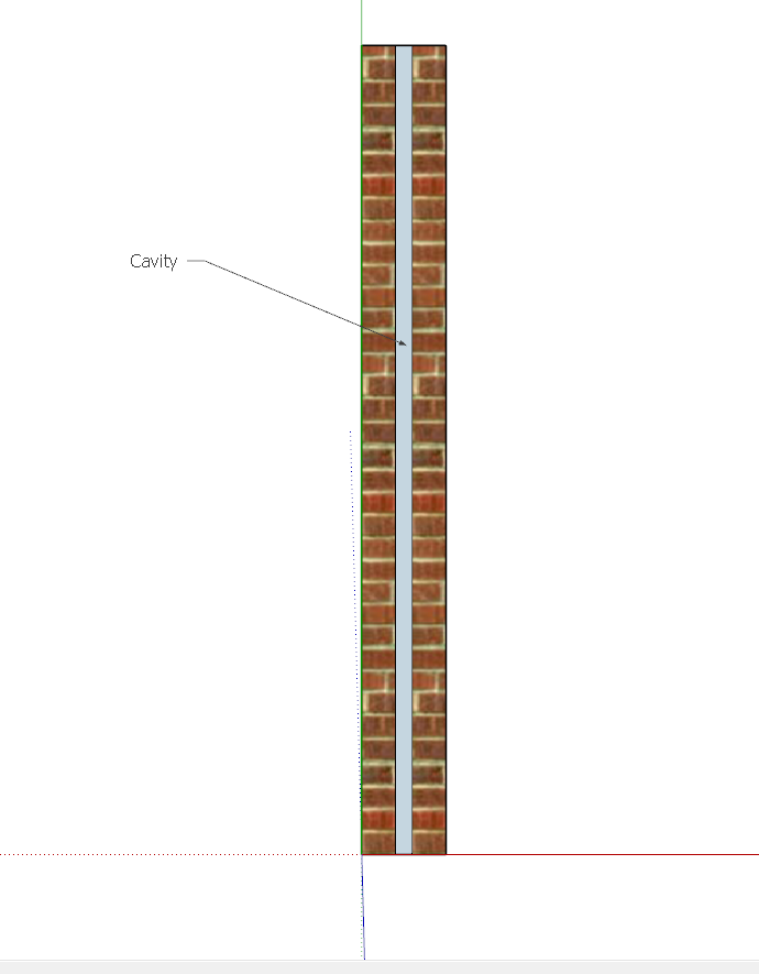

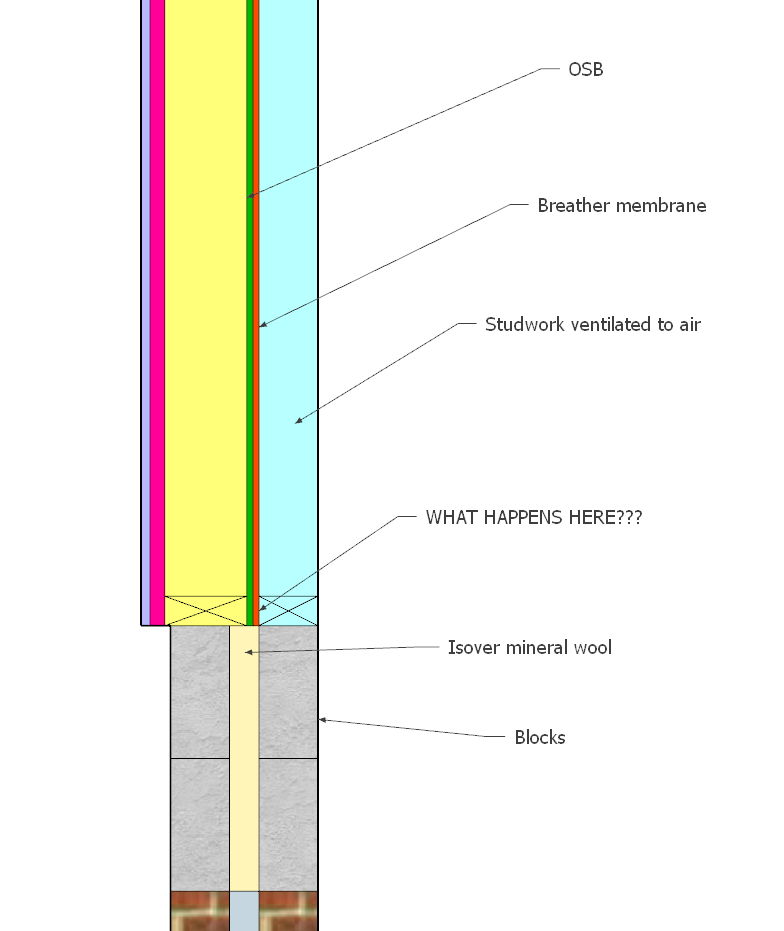

Ok a little detective work here. Your existing wall if i'm correct?
Whats's in the cavity as indicated?
This is what I think you have today???
What happens at the bottom of the studword with the membrane?
Here is your proposal as I see it today.
Not ideal at all as the ventilated cavities will make the EPS insulation almost useless as cold air will circulate behind it.
Similarly any drips that might get into the wall behind the insulation will make their way into the cavity and make the existing cavity wall damp.

The membrane that can be seen from my photo is fixed underneath the studwork that can also be seen in the photo. Unless there are any tears that I haven't seen, whist it has been exposed any rain water hitting it has not entered the cavity below.

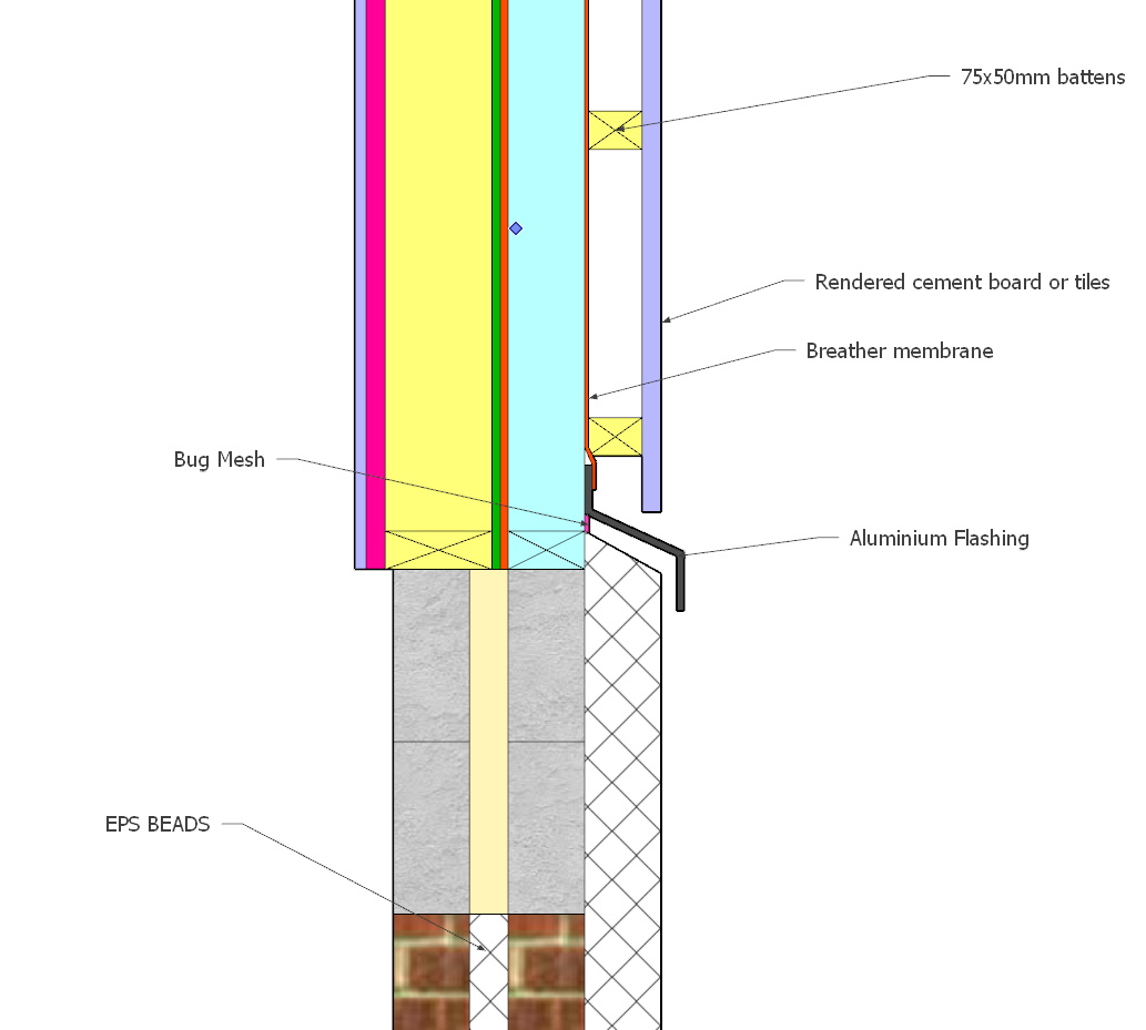

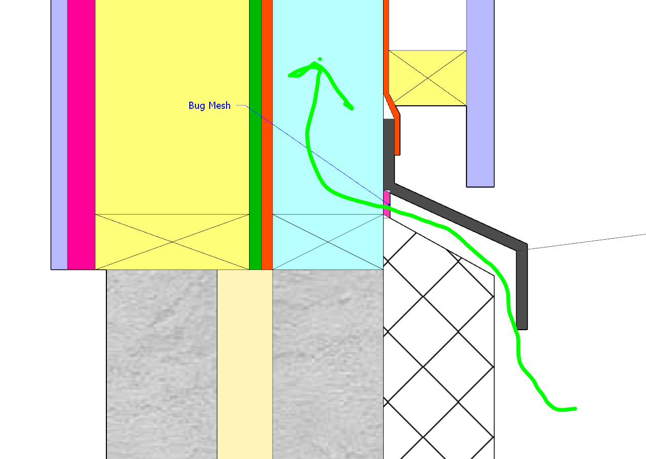

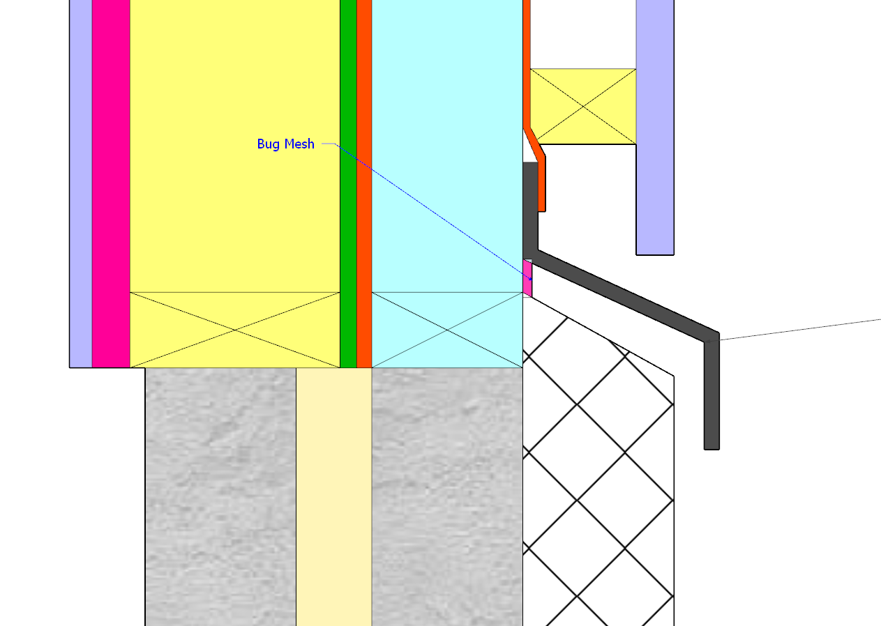

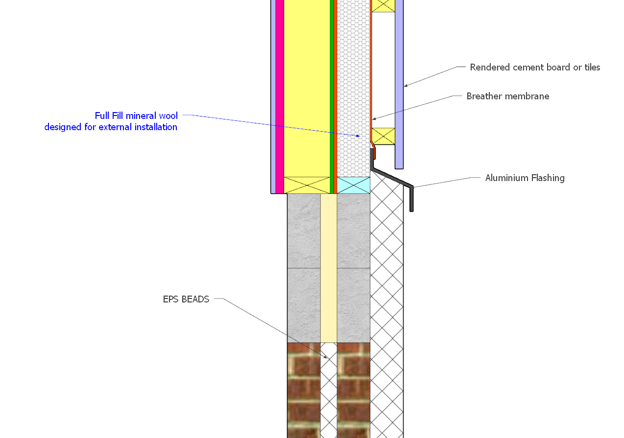

Here's my proposed solution.
Fill the existing cavity with beads.
Apply a flashing as shown to direct any drips from behing the caldding outwards.
Batten and renderboard the studs as shown.
Apply a bug mesh and leave a ventilated gap as shown above the EPS to allow the back of the studs to ventilate.
As an option you could infill the external studwork with some mineral wool. Not the stuff that is used in attics but the stuff that is designed for EWI or cavities.
run a hose on it for an hour and see where the water ends up.
Water must always drain DOWN And OUT.
At the moment it has a path IN.
I know it'a not much fun to reverse a decision but it'll be orders of multitiude cheaper to do it now than in a few years time.

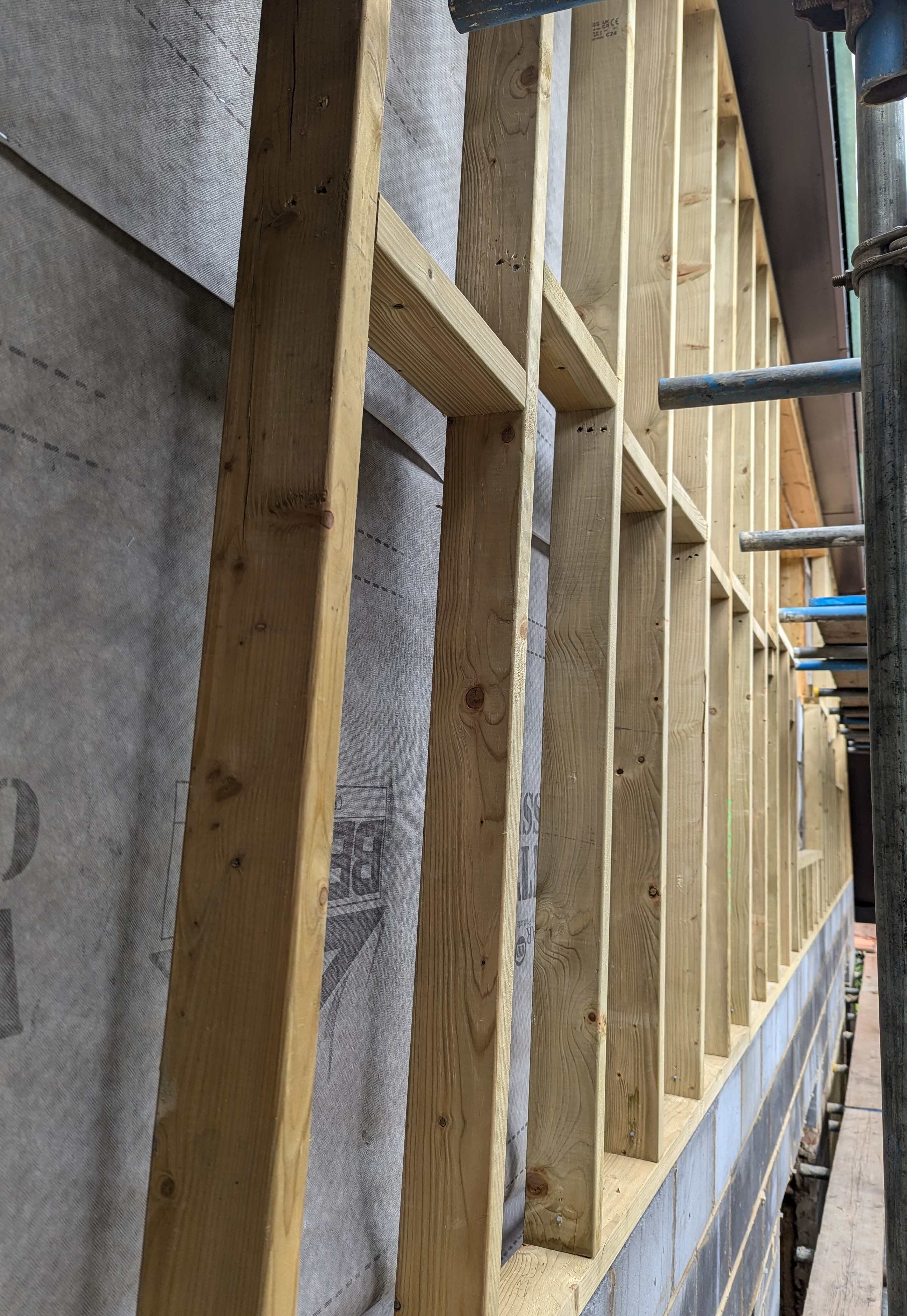

Here are some photos of the gables taken at various stages over the last few months.
I'm not around until tomorrow morning to take new photos of specific details

Unfortunately water tends to find a way in time.
Cracks in the render, gaps between boards, differential expansion and contraction of timber, foam and masonry will all stress the external weather proof layer. Eventually it will  fail.
EWI over masonry it isn't such an issue as it's very very moisture tolerant. A small leak may do little or no damage over years.
The same can't be said of timber which is a brilliant material but needs to be treated with more respect. Read about the leaky condo crisis to see what happens when you build in a damp environment without proper ventilated rain screens and appropriate drainage paths for timber frame buildings.
What I have proposed I think I'd very inexpensive, easily buildable and won't require and dismantling of what is already there. If anyone else has an improved suggestion please chip in.

I've just checked with the builders, and the breather membrane definitely overlaps the external masonry wall on the ground floor.
Their plan was to fix a concrete board to the external studwork, and then fix the EPS/EWI on top of this. Going right up to the soffit and sealing at the top.
I'll discuss your proposal with them, thanks for the detailed knowledgeable responses.
It really should go outside the EWI too. Draining into the bricks behind the EPS isn't robust solution.
That EPS won't be achieving any insulative benefit with the open cavity to the rear. Just move the cement board out a d render that instead.
