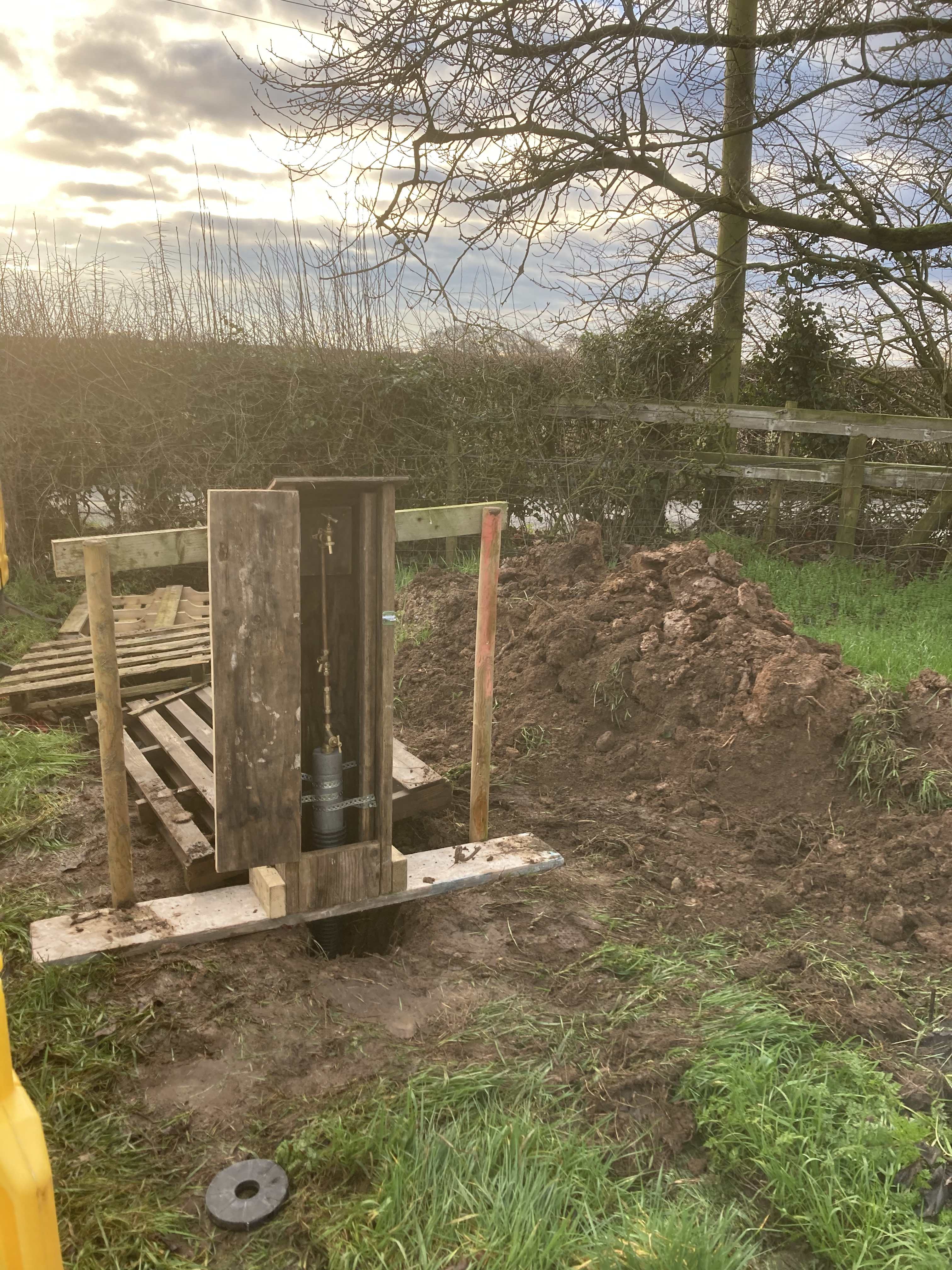

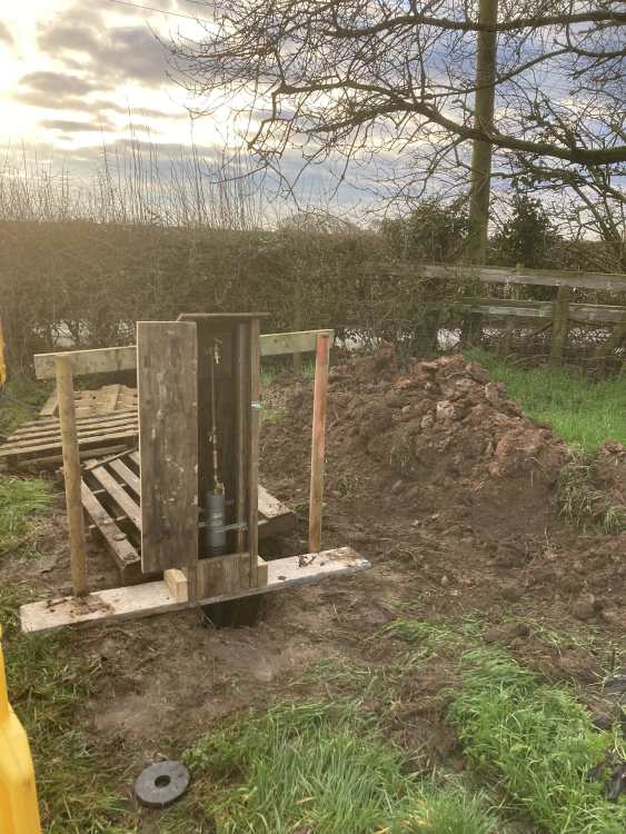

flanagaj Posted October 22, 2024 Share Posted October 22, 2024 I want to get a water connection made to the mains, and my initial plan is to simply run the laid pipe to a temporary standpipe a few meters from the mains connection. As I am going to lay a conduit as part of the ground floor slab, repurposing of the temporary feed can be done when the build is quite advanced. The question I have surrounds the use of joints underground. Repurposing the temporary supply will require the 90 degree elbow to be replaced with a straight joint. Is it ok to do this. as I currently don't see how I can avoid any joints, unless I get the water company out to remove the original pipe and connect in a new section. Will they effectively have to do two inspections? Link to comment Share on other sites More sharing options...
Conor Posted October 22, 2024 Share Posted October 22, 2024 Yes it's fine. It's normal for the water company to fit a meter box, leave a ~2m tail on the customer side, which you then connect to using a straight coupler. Link to comment Share on other sites More sharing options...
flanagaj Posted October 22, 2024 Author Share Posted October 22, 2024 19 minutes ago, Conor said: Yes it's fine. It's normal for the water company to fit a meter box, leave a ~2m tail on the customer side, which you then connect to using a straight coupler. Thanks Conor Link to comment Share on other sites More sharing options...
nod Posted October 22, 2024 Share Posted October 22, 2024 We got a temporary connection about two years ago We took advantage of the rural grant £250 including trafficked light for the road No charge for water while we where building Still waiting for a meter I simply removed the standpipe and relocated to the house slab Link to comment Share on other sites More sharing options...
Canski Posted October 22, 2024 Share Posted October 22, 2024 Not sure if I’m understanding this correctly. I found the local brewery last week. 😀😀Why not coil quite a bit of pipe up that they can connect to at a later date ? If they have to do a road crossing ask if they can mole. It cost me no extra and they finished it all in a day. OK the meter covers looked like a bomb crater but they were quick to correct the mess after one complaint. Link to comment Share on other sites More sharing options...
