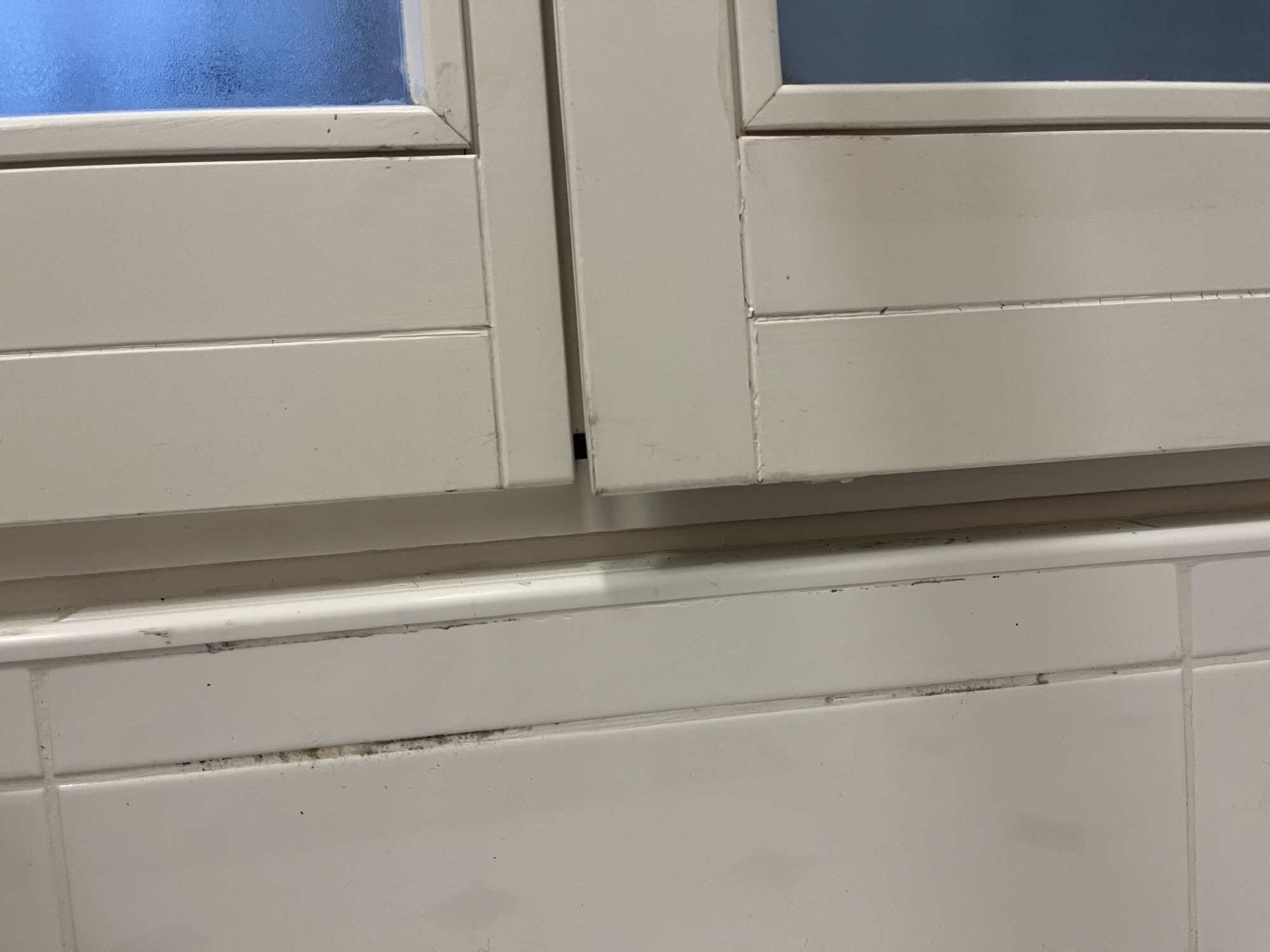

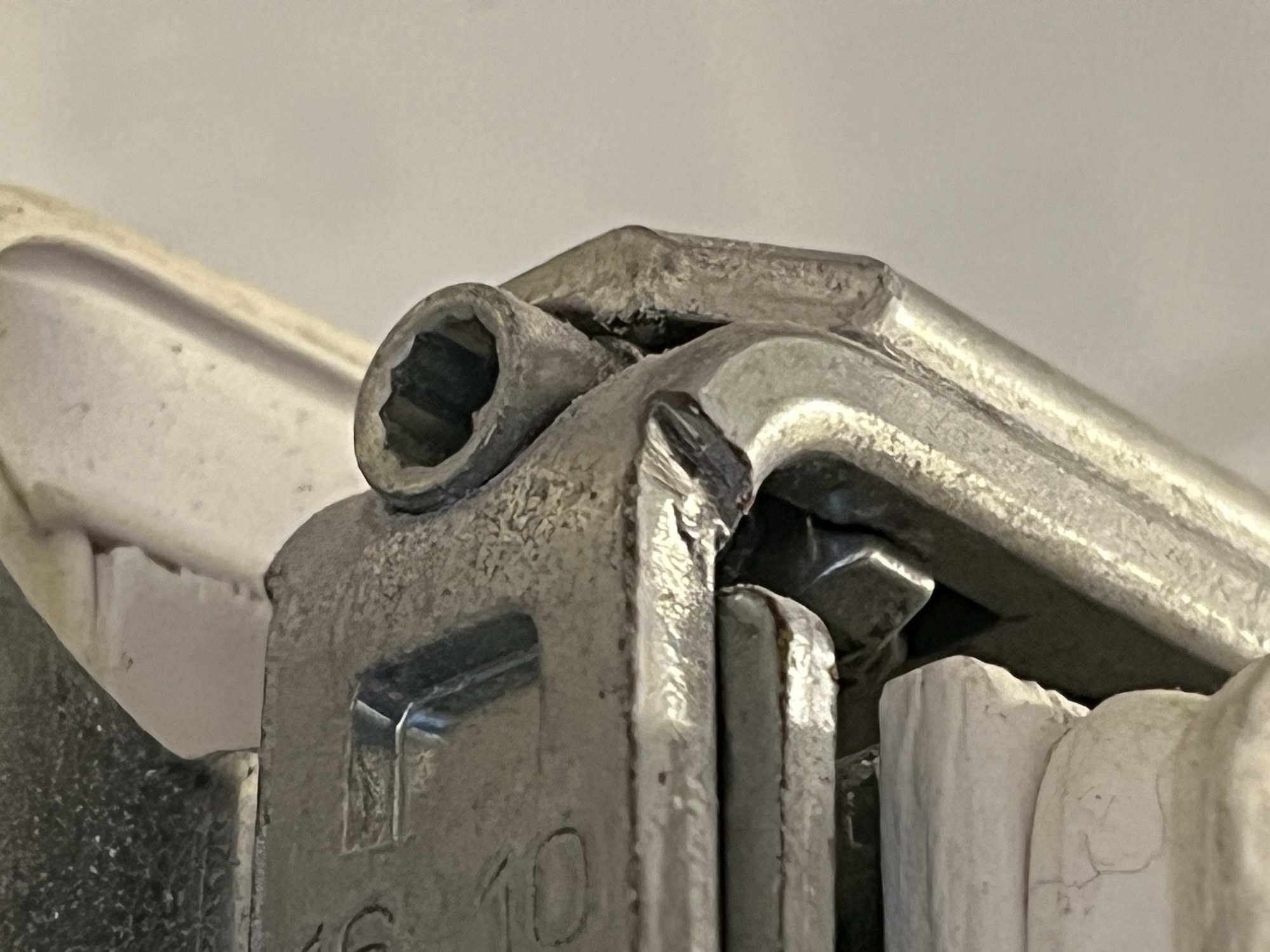

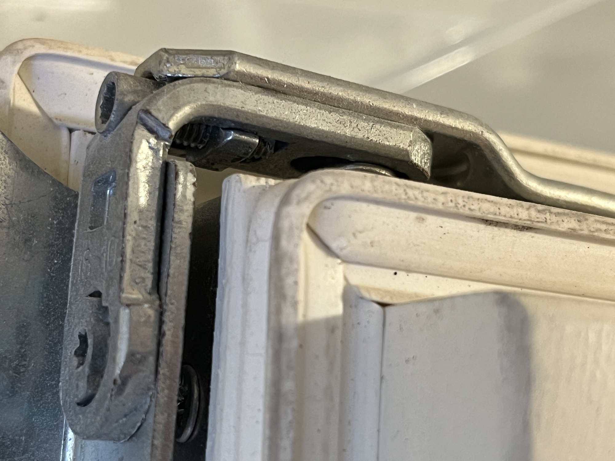

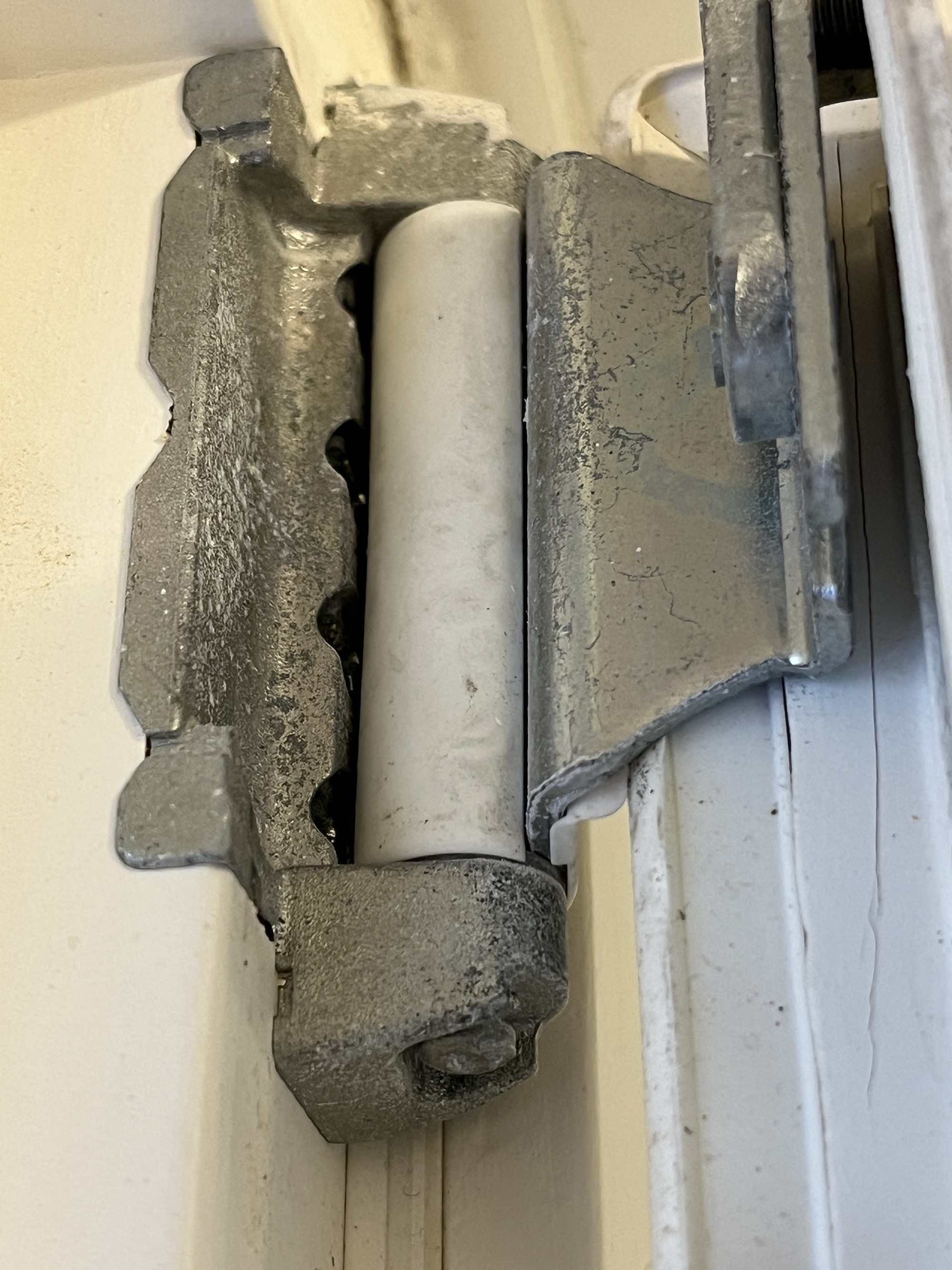

AndyG Posted October 22, 2024 Share Posted October 22, 2024 (edited) hi I have a big set of wooden double-glazed windows (fitted new in 2017) and the opening part of the window has slipped about 2cm (see photo) and so it no longer closes. If this were an IKEA cupboard door I would know which little screw to tighten to bring the door/window back up... but it's a bit more complicated. Could someone tell me if the 12 (14?) point star screw is what I need to turn to adjust the hang of the window ? And if not... any ideas how I can do it? (The window has 2 hinges, top and bottom is 300cm high) I can't find a brand name for the windows and the builder who fitted them is no longer around. Many thanks in advance Edited October 22, 2024 by AndyG Link to comment Share on other sites More sharing options...
markc Posted October 22, 2024 Share Posted October 22, 2024 Has the hinge moved or is it the plastic frame that has gone out of square? Is the hinge side still vertical/parallel to the frame? If so then you don’t adjust the hinges, you “push” the frame back into square by packing the glazing unit. Link to comment Share on other sites More sharing options...
AndyG Posted October 22, 2024 Author Share Posted October 22, 2024 24 minutes ago, markc said: Has the hinge moved or is it the plastic frame that has gone out of square? Is the hinge side still vertical/parallel to the frame? If so then you don’t adjust the hinges, you “push” the frame back into square by packing the glazing unit. Thanks for the quick reply Mark. The hinge is still straight. In fact now I look at it again to answer you question I see that the whole glazing unit can be moved back and forward about 5mm along the line of the frame... so left to right in this photo. So when I push it left, my 2cm slip at the bottom probably disappears... but it wants to hang right. Does that change your answer at all? If not, do I need professional help>? Because I don't know what "packing a glazing unit" involves! Link to comment Share on other sites More sharing options...

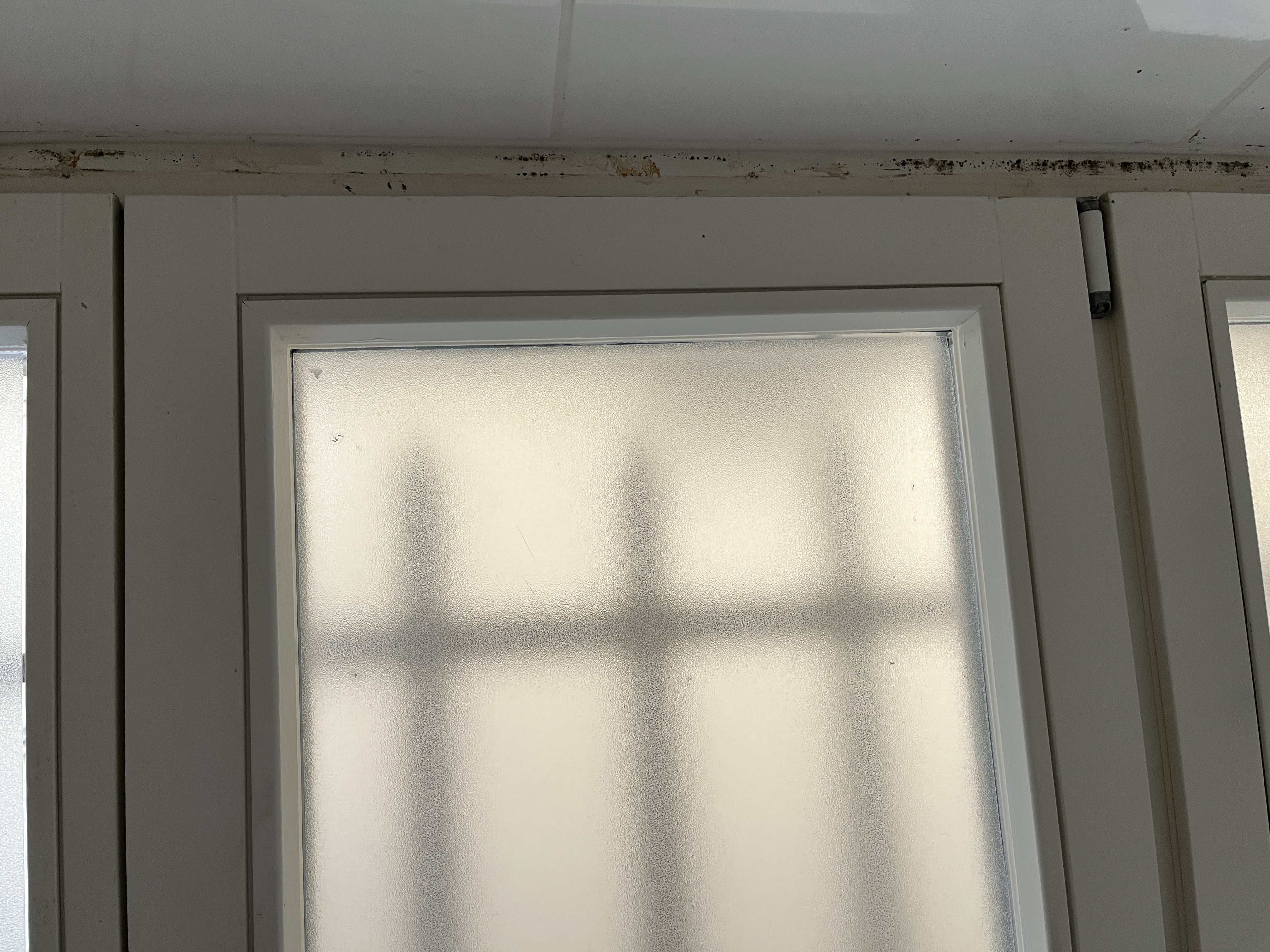

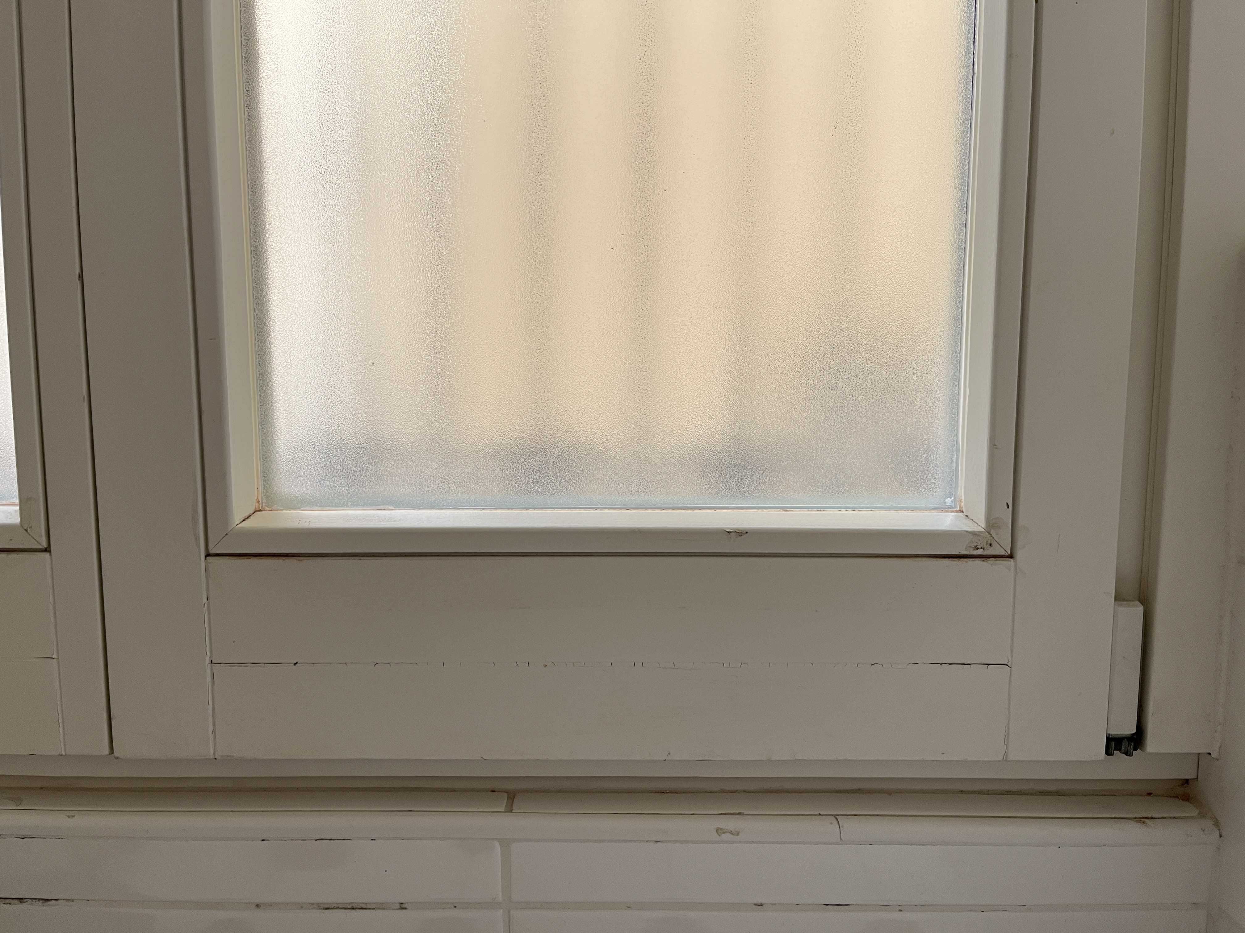

ProDave Posted October 22, 2024 Share Posted October 22, 2024 A more zoomed out photo showing the whole window and how it fits the frame all round is needed to answer if it is the hinge that has slipped or the glass within the window frame that has slipped. Link to comment Share on other sites More sharing options...
AndyG Posted October 22, 2024 Author Share Posted October 22, 2024 Difficult to get the whole window (3m high in a small room!) but this is the top and bottom while closed. Does that help? Link to comment Share on other sites More sharing options...
AndyG Posted October 22, 2024 Author Share Posted October 22, 2024 I don't think it can be the glass within the frame because the original problem is that the window barely closes any more (I have to lift and push past an obvious obstacle... but I've tried planing the bottom part of the frame and window and that made no difference. Though I admit I'm still not sure I've identified WHERE the window hits the frame when it won't close.) Link to comment Share on other sites More sharing options...
Mr Punter Posted October 22, 2024 Share Posted October 22, 2024 I think you need to heel and toe. Take out the glazing beads and redo. Lots of links on youtube. Link to comment Share on other sites More sharing options...

craig Posted October 25, 2024 Share Posted October 25, 2024 (edited) On 22/10/2024 at 08:38, AndyG said: Thanks for the quick reply Mark. The hinge is still straight. In fact now I look at it again to answer you question I see that the whole glazing unit can be moved back and forward about 5mm along the line of the frame... so left to right in this photo. So when I push it left, my 2cm slip at the bottom probably disappears... but it wants to hang right. Does that change your answer at all? If not, do I need professional help>? Because I don't know what "packing a glazing unit" involves! This likely to be lateral movement (side to side on the top hinge. Give it a half turn, then check. Edited October 25, 2024 by craig Link to comment Share on other sites More sharing options...
