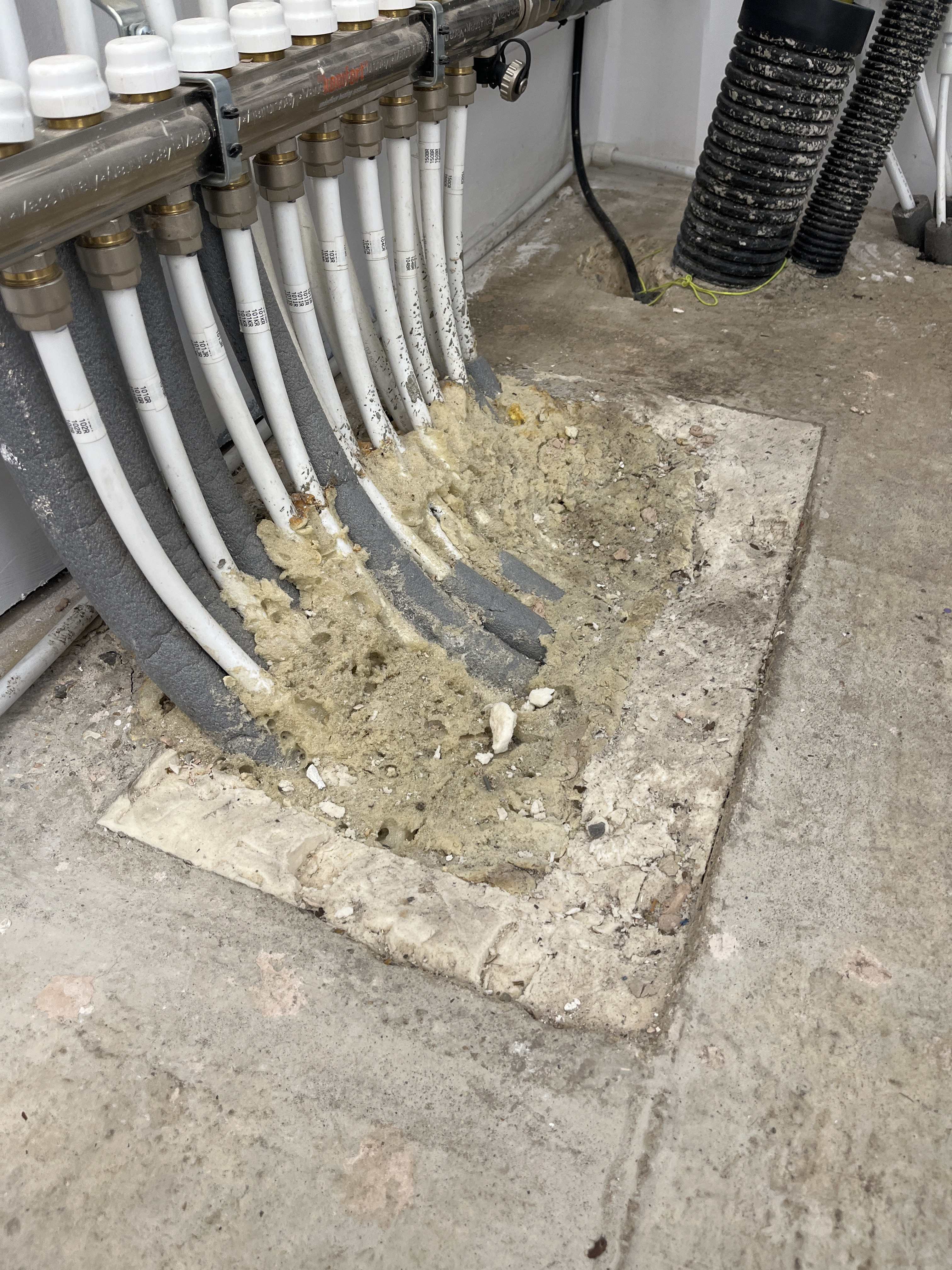

Dreadnaught Posted October 17, 2024 Posted October 17, 2024 In my Plant Room around the UFH manifold I have a big hole through the concrete floor (filled with PIR insulation). See photo. I would now like to pour a 3mm self-levelling compound across the whole floor and add LVT (stick-down), including across the area of the hole. What to do about that hole - and give a stable base for the self-levelling compound and LVT?! I am unsure.

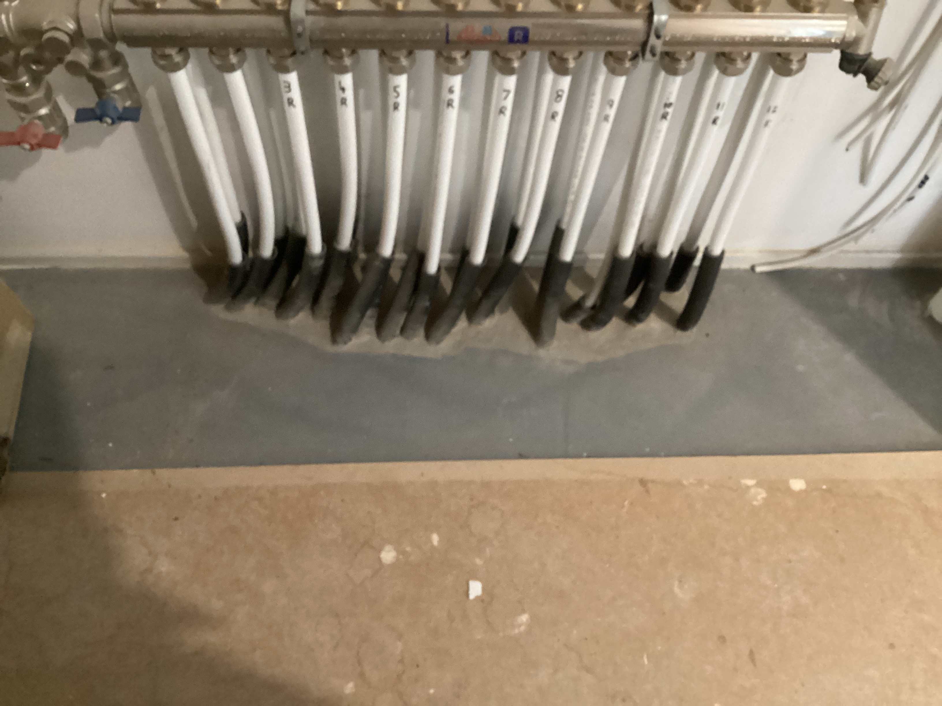

Russell griffiths Posted October 17, 2024 Posted October 17, 2024 Get down on your hands and knees, and get the hoover hose, scratch away at the insulation and hoover at the same time, don’t use anything to damage the pipes. put conduit around the pipes and make sure you have 20 mm deep clearance below finished floor level. then use a high build floor leveling compound, pour it in and crack open a bottle as you admire your masterpiece. 2

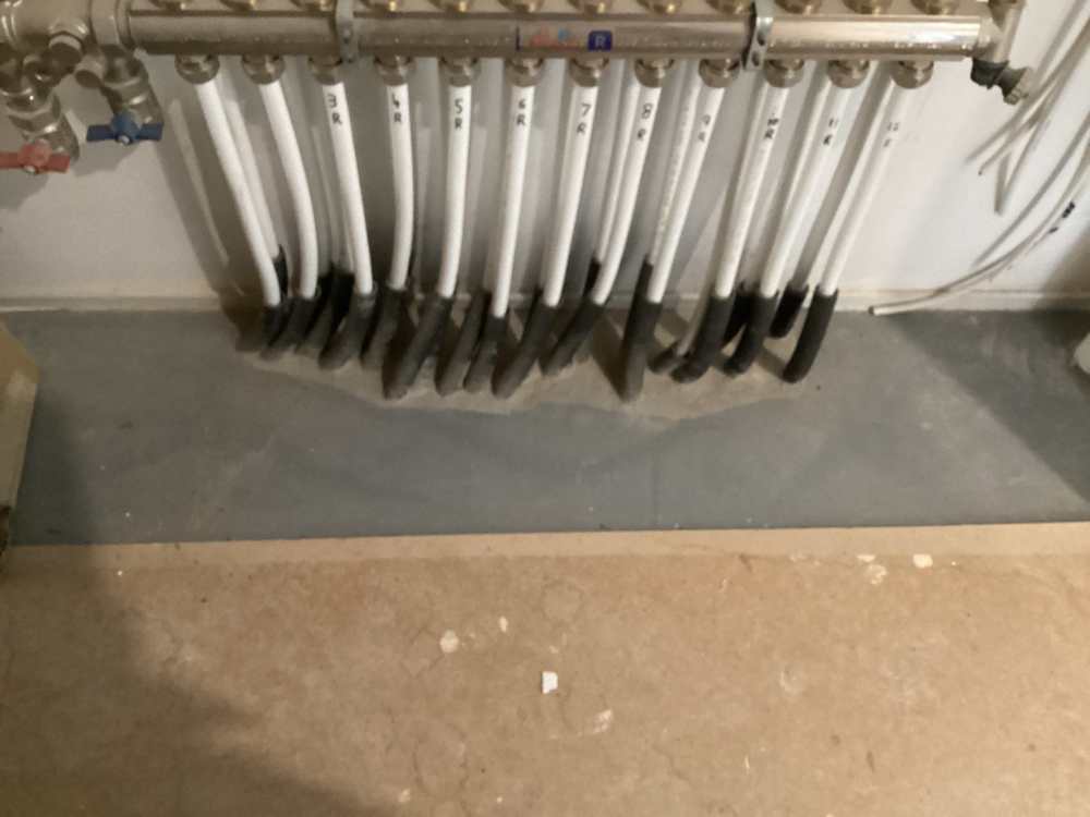

JohnMo Posted October 17, 2024 Posted October 17, 2024 Ours is just about the same, we have tiles and poured self levelling compound to level with the tiles. 1
Dreadnaught Posted October 17, 2024 Author Posted October 17, 2024 Fabulous, thanks guys. I am not sure I can match the high-levels of workmanship on display in both those, but I will do my best!
