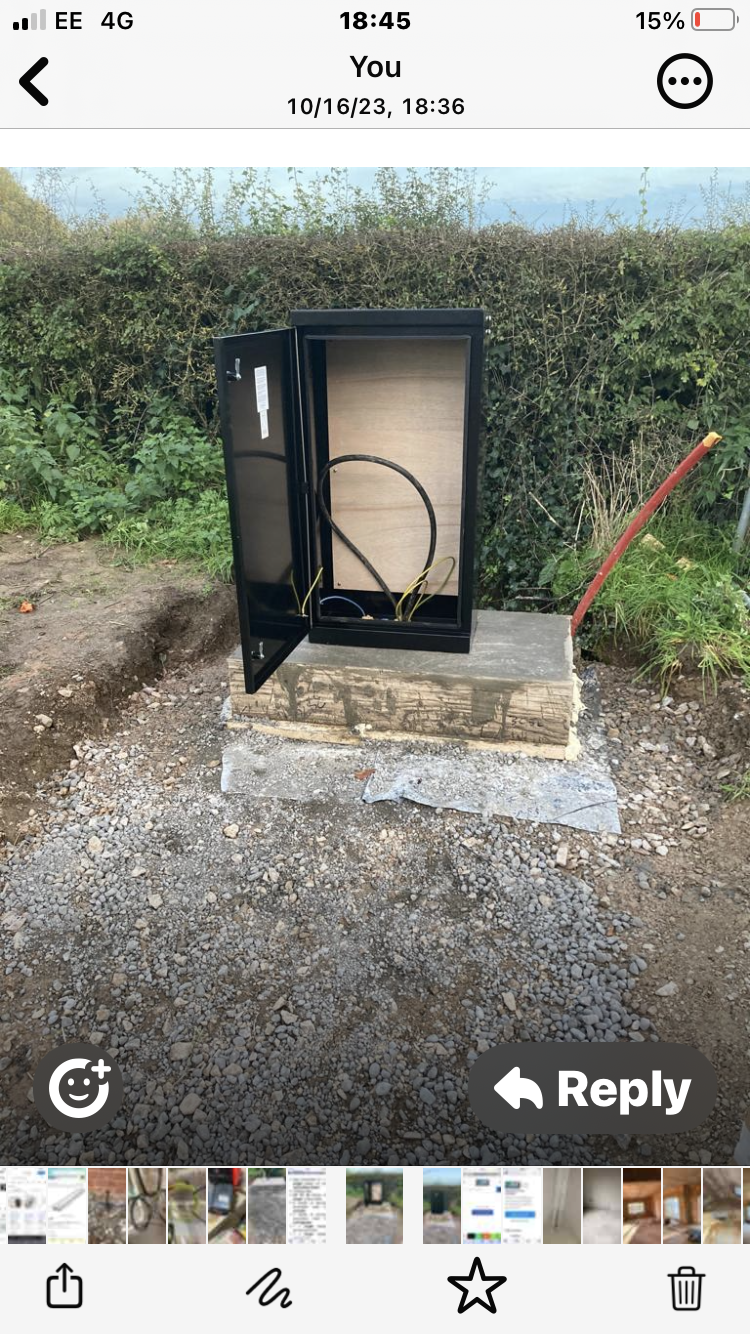

Kelvin Posted October 9, 2024 Posted October 9, 2024 (edited) I used a 44mm hockey stick for 35mm2 SWA cable. It fitted but it was hard work. If it’s into a kiosk the guys won’t care if it’s a hockey stick or the smoothwall flexible electrical ducting. I put an extra hockey stick into my kiosk just in case I had a need to run something else into it. Edited October 9, 2024 by Kelvin 1
saveasteading Posted October 9, 2024 Author Posted October 9, 2024 3 hours ago, Kelvin said: It fitted but it was hard work. So I could slide it on the end then position it for the slab pour? The flexi sounds favourite but isn't what the spec requires.
Kelvin Posted October 10, 2024 Posted October 10, 2024 (edited) If you have the cable on-site that will be easier. Just keep in mind the cable is very unwieldy. The issue we had was I put the kiosk in when the plot was still a field so just had the service cable from the pole and nothing else. I made up a template out of a sheet of plastic board marking the holes where the ducts came through the bottom of the kiosk. The spec I got from SSEN had a duct to put in the trench I couldn’t buy anywhere. When the guys came to fit the service cable they basically said as long as it’s black 😂 I had a temp CU and some sockets fitted to get us power on-site. Edited October 10, 2024 by Kelvin 2
saveasteading Posted October 10, 2024 Author Posted October 10, 2024 3 hours ago, Kelvin said: the service cable from the pole and nothing else. we are the opposite. we have to get our cable across the vendor's land by a deadline, and the kiosk built. So we will have a kiosk and our cable dangling inside it for a while and then get UKPN in. Or do we get our stuff wired up into the garage first? Decisions. The supply comes from a nearby pole and through a duct that the vendor (and neighbour) has had installed already. It doesn't quite reach the kiosk position and I have no idea if it is intact and appropriate. So I think we are best leaving an open trench behind the kiosk between it ( and our duct) and the existing duct. Your photos are really helpful and I may use them to show the groundworker if you don't mind. @Kelvin The 44mm hockey-sticks look just about ample there. What size of cable do you have? We will have 4 core 35mm2 SWA and a 16mm2 earth. Do you think an extra duct for the earth is prudent?

Kelvin Posted October 10, 2024 Posted October 10, 2024 The cable from the kiosk to the house is 35mm2. I’ll take a picture and post it shortly. Have you been asked to provide your own earth? I generally add extra ducting just because it’s hard to add it afterwards.

saveasteading Posted October 10, 2024 Author Posted October 10, 2024 ooh that is tight! here is the one I look like buying. I think this is the Kingspan standard one, and the ducts are what I thought UKPN might not like Yes this doesn't seem to be a metered box, but I found it on the supplier's page as an approved one.
Kelvin Posted October 10, 2024 Posted October 10, 2024 Yeah don’t use drainage pipe. Didn’t you get a customer works guide from UKPN that specifies what you need to do? The guide I got from SSEN says this. Your cabinet is quite big so plenty of room to get the ducting in. You could use smooth wall flexible 50mm electrical ducting into the kiosk for UKPN and your connection to the house and a 38mm hockey stick for the earth requirement to save a bit of space. The hockey sticks are mostly used to bring the cables up into a meter box on the side of a house.
saveasteading Posted October 10, 2024 Author Posted October 10, 2024 1 hour ago, Kelvin said: Didn’t you get a customer works guide from UKPN Yes . But can't find it. Your attachment is more practical I think. I've ordered the cabinet. It took two hours because the checkout price added £100 for delivery. then they agreed that was wrong and it became £12.....BUT the base price then increased by £50. Fortunately a real person agreed the price and it is now ordered. 7 to 10 days delivery. someone else said 3, and it is the same thing, sitting at the manufacturer's depot. This cabinet should be sitting at every electrical merchant for a sensible price. I expect you want figures? £584 incl VAT. It would be a bit less for the minimum size. I could easily have paid £100 more even after much searching, and some wanted £1200 or more.. Now I hope it turns up Ducts. I will take the above advice and put in a black duct 70 or 100mm for the big cables, bent to a J shape to 600 below ground. and maybe another as spare. Plus a proprietary 38mm hockey stick for the earth.
