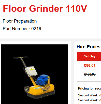

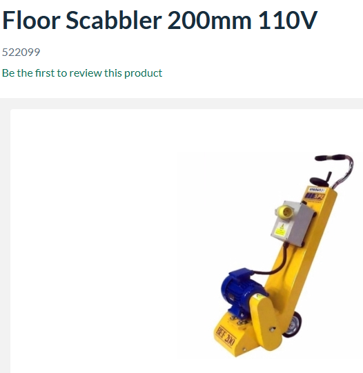

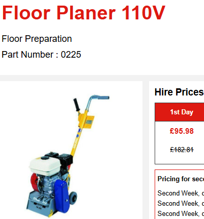

Russell griffiths Posted October 6, 2024 Posted October 6, 2024 I hired a floor scabbler to take all the snots off mine. did a180m in a day.
Dave Anderson Posted October 6, 2024 Author Posted October 6, 2024 (edited) Thanks for the idea Russell. Had a quick look and there seems to be a few 110v machines that might do it. Just wondering what sort of machine worked for you? Did you use something like this (I think you have to by carborundum or diamond blocks for it) or this or was it a heavy pneumatic scabbler? Edited October 6, 2024 by Dave Anderson duplicated image insertion
Redbeard Posted October 6, 2024 Posted October 6, 2024 Whatever type you use ensure it has good dust extraction/dampening and, because IME it is never perfect, that you have good respiratory protection as well.
