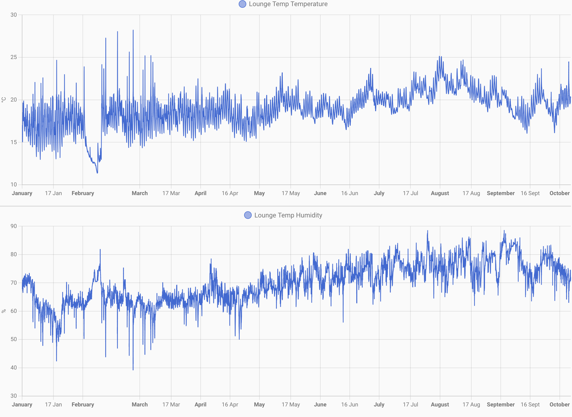

This forum is generally of the opinion that if 3-3.5ACH @ 50Pa is your building's airtightness target then MVHR is pointless, as the air entering through the fabric is bigger than the flow rate of the MVHR and the heated air will be lost faster that the MVHR unit can recover it.
My house is nowhere near 3.5ACH yet (a safe guess). So with plenty of air infiltration, why is the humidity averaging 70% in the lounge?
Lounge is south facing (spikes are when the sun hit the temperature monitor), no trickle vents, and contains a bunch of house plants.
I've been holding out that as we improve the airtightness then adding MVHR will fix this humidity, but if we're already well ventilated and this is the humidity, then MVHR is going to change nothing, right?

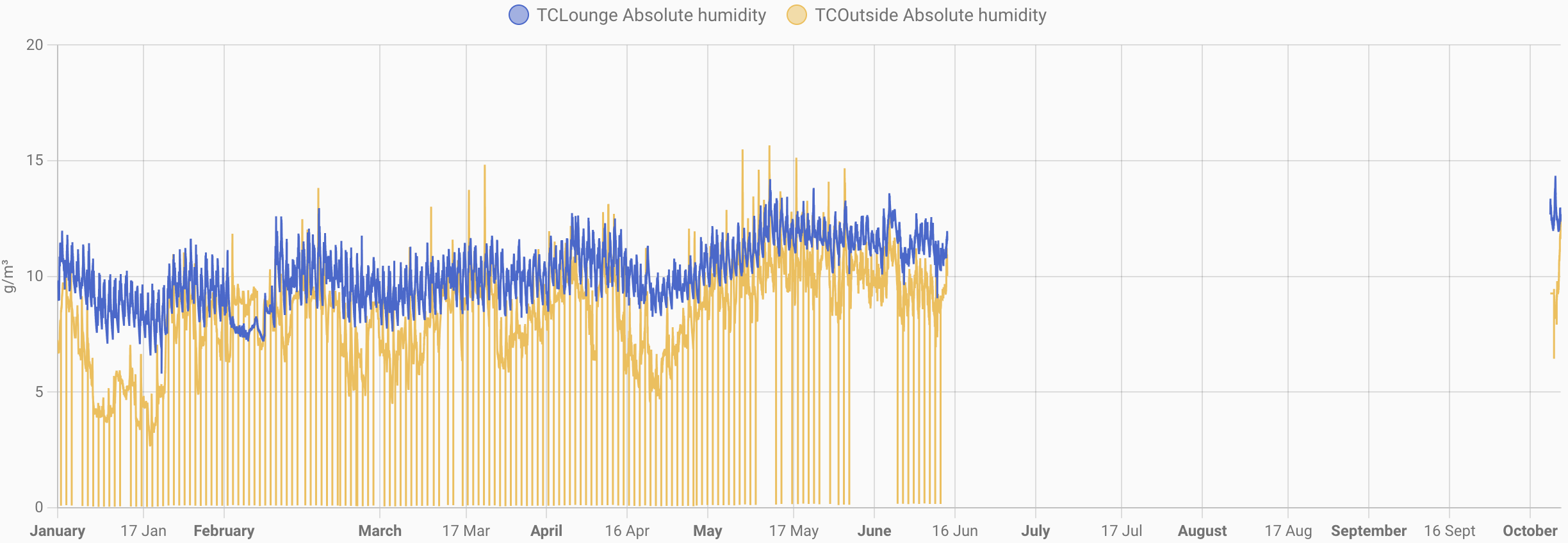

[For SteamyTea the absolute humidity is lower outside except for mid-summer. Natural ventilation between Sept-May should be bringing in less water vapour than is indoors. Battery ran out over the summer, hence the gap]

No trickle vents so how do you KNOW you it is "well ventilated"?
Up until September the cavity was open one side of the window. I stuffed it with stuff over winter but the curtains would still blow in the wind
Edit: our airbricks vent the wall as well as under the floor. They're not sheathed.
Edited by Sparrowhawk

Don't you need to measure the relative humidity instead of absolute?

1. What are you measuring temperature & humidity with, and has it been calibrated / checked for accuracy?
2. You can download a small spreadsheet from this thread that will calculate the internal RH based on the external RH & internal + external temperatures. Variation from the calculated figures are the result of lag or other moisture sources / sinks. It may be of interest.
A mix of  Zigbee temperature & humidity sensors Aqara, Tuya and a single Sonoff. I calibrated their RH reading last year using the NaCL test. The lounge has the sole Sonoff though, so I've added a Tuya to see if they match. After a night the Tuya is 0.6C / 6% RH lower than the Sonoff, which if it stays that different goes a way to explaining the higher recorded humidity in the lounge compared to the other rooms.
