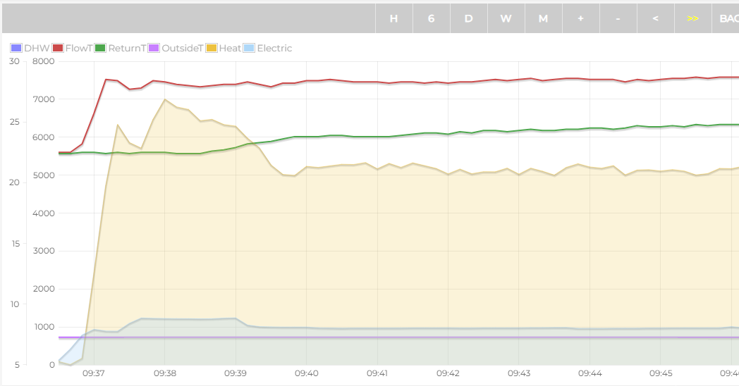

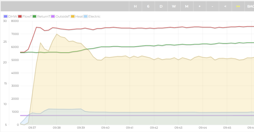

I have zero issues with the heat pump. A heat pump behaviour is different to a boiler, its output is a lot different. Most heat pumps are sub 10kW, most oil boilers are 4x the output.
You don't have lots of energy, a 6kW heat pump running at full load for 10 mins generates a max 1kWh of heat. Getting 60L of water from 21 deg to 28 is 0.5kWh, plus heating a bunch of pipes, a heat exchanger etc. That 1kWh is very quickly consumed, before any real useful work is done.
So a typical heat pump running for 10 mins looks like this
Key points are
Compressor starts at 22.5 degs return temp
At 10 mins the flow temp has increased to 28.6 degs and return temp is up to 24.8 deg.
Actual heat output after 10 mins is only 0.852kWh, so basically heating the system, and not much heat is going into the house.

 That's good data.  But after 10 minutes you have now warmed up all the water inside your house to 26.7 C average.  So even if everything was turned off at that point you would still have heat going into the house; that doesn't stop.  You will still derive benefit from all parts of the heated system that are inside the insulated fabric of the building; that energy spent heating the system was not wasted, as you seem to imply.
Posted
Expand
Not saying it's wasted, but it not enough to be properly useful. It better to have a slightly longer run, the remainder run time is all useful heat. Its getting the correct balance between heating stuff up and heating heating stuff up and adding heat to the house
a few runs at similar average outside temps, only change from first and send two runs was a slight change to compressor stop hysteresis to get a longer run. The compressor start hysteresis remained the same
7.8 deg OAT, short runs (10 to 15 mins duration), 9.1kWh electric 44.2kWh heat delivered - short runs (space heat CoP 4.86)
7.5 deg OAT, longer runs runs (15 mins plus duration), 5.7kWh electric 27.8kWh heat delivered - longer runs (space heat CoP 4.89)
slightly colder day at 6.8 deg OAT, again longer (35 mins plus duration) runs, 6.8kWh electric 33.8kWh heat delivered - longer runs (space heat CoP 4.97)
On all occasions above is run full WC mode, house remains at a stable 20.5 degs. Difference between 7.8 and 7.5 deg day is a reduction of 40% electrical use. Which is huge. CoP stays similar, CoP increase on the 6.8 deg day, is due to slightly cooler day leading to longer run times and less standby time.
