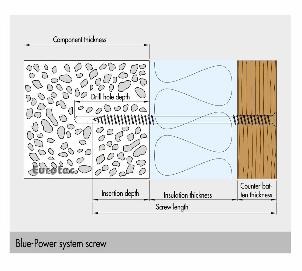

Nick Laslett Posted October 4, 2024 Posted October 4, 2024 (edited) I like these screws from Swiftfix. These are the same screws @Chanmenie used. https://www.swiftfix.co.uk/7-4-x-180mm-TX40-Blue-Power-Timber-to-Masonry-Screws-Box-of-100-p141442218 https://www.swiftfix.co.uk/7-4-x-200mm-TX40-Blue-Power-Timber-to-Masonry-Screws-Box-of-100-p141878417 Strong, have good corrosion resistant coating. I think these are the ones I used to fit the battens for my cladding, but would have to check. I alternated my fixings between the web and the concrete. Also did a few holes with the spiral fasteners. Rawlplug 80mm SPIRAL FIXING FOR EPS. https://shop.rawlplug.co.uk/facade-insulation-fixings/facade-insulation-accessories/iso-plug-plastic-screw-in-fixings/r-iso-plug-insulation-fixings/spiral-fixing-for-eps-80mm-box-of-40-r--iso--plug--80 So for example a 2 metre batten, with 400mm spacing would have 3 concrete screws, 3 in the web, or 3 spiral if not on a web point. Batten spacing would be 400mm, but for where boards joined, I would double batten. Edited October 4, 2024 by Nick Laslett 2

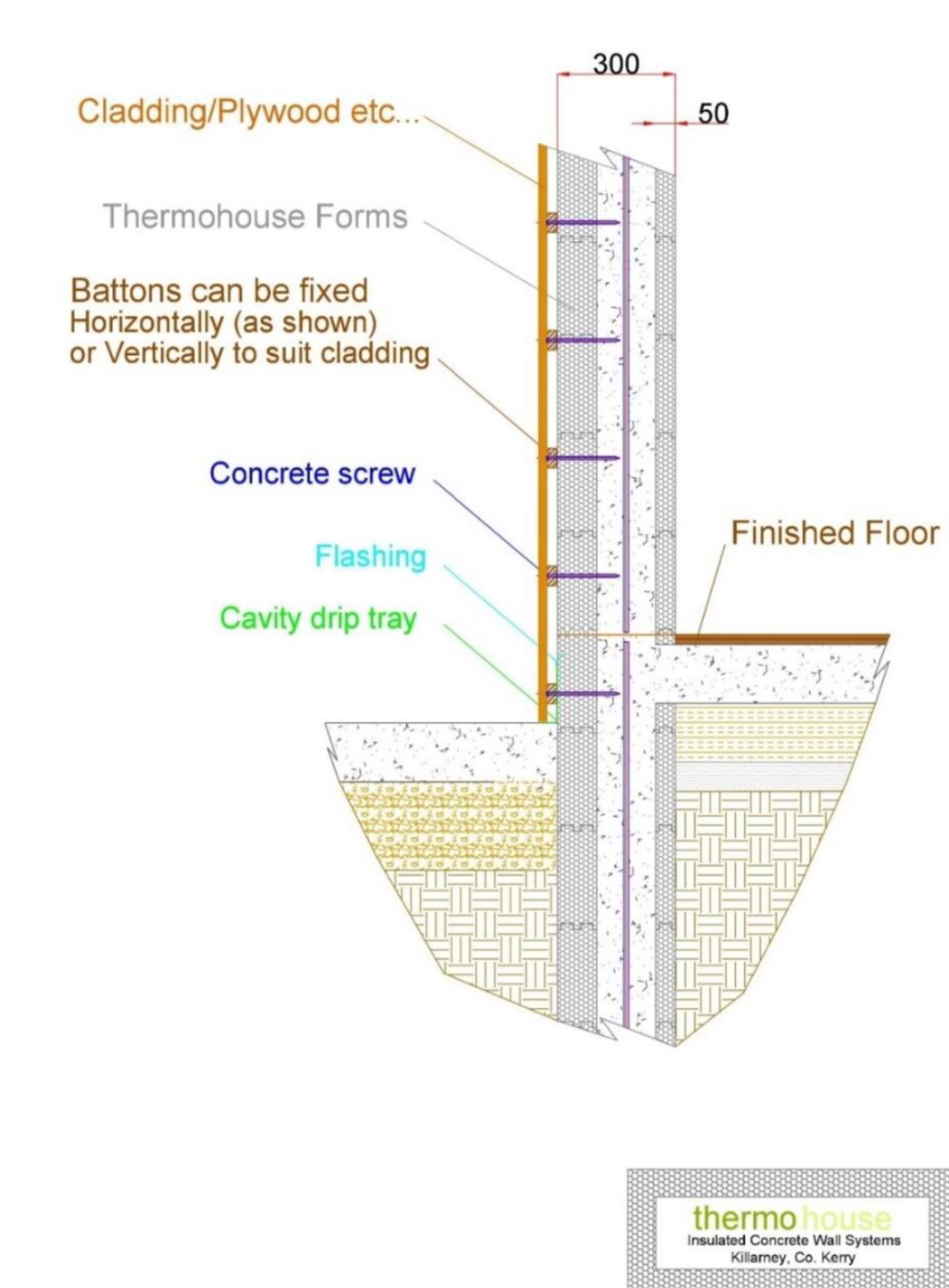

Nick Laslett Posted November 7, 2024 Posted November 7, 2024 (edited) @Gus Potter, thank you for the model. If it is of interest here are some specifics from the data sheet for the Eurotec screws. https://app.nextpim.de/Cloud/6118eacef55a4834b44c3623/a3ba70a2-990d-432c-fb8c-08d79e6bb09c/Product_data_sheet_Blue-Power_Systemschraube_EN_06_2023.pdf For fastening timber substructures to concrete. When the system is installed on façade insulation, the insulation absorbs a proportion of the transverse forces. The insulation product must therefore have a compressive strength of at least 50 kPa at 10% compression. Static Values For fixing in Concrete C20/25 Tensile load bearing capacity = 2.5kN Shearing load bearing capacity = 0.75kN The manual from the ICF supplier doesn’t really go into any great details about fixing external timber battens. The two biggest challenges were finding a concrete screw long enough to go through a 25mm batten and 100mm EPS, + 50mm minimum fixing depth, and the need for some kind of external weather rating. The Eurotec screws are rated for C4 environments and appear to be designed for going through 100mm+ of insulation, then affixing into concrete. One of the things I liked about the Thermohouse ICF blocks was the specification of the EPS, they have a compressive strength of 150 kN/m2 at 10% compression, EPS density of 24kg/m3. Edited November 7, 2024 by Nick Laslett 1
Gus Potter Posted November 7, 2024 Posted November 7, 2024 54 minutes ago, Nick Laslett said: The manual from the ICF supplier doesn’t really go into any great details about fixing external timber battens. The two biggest challenges were finding a concrete screw long enough to go through a 25mm batten and 100mm EPS, + 50mm minimum fixing depth, and the need for some kind of external weather rating. The Eurotec screws are rated for C4 environments and appear to be designed for going through 100mm+ of insulation, then affixing into concrete. One of the things I liked about the Thermohouse ICF blocks was the specification of the EPS, they have a compressive strength of 150 kN/m2 at 10% compression, EPS density of 24kg/m3 Nick (fixings) they won't commit to. This is not part of their design liability. This is completely understandable, they are just giving a representative example. Fixings are rated in two not least general ways. One is the exposure rating.. your C4 wet dry.. near the sea (salt air for example) the other is strength. The ICF folk can't be expected to recommend fixings for all the different combinations of insulation and wall cladding. For all. Most structural fixings these days are based on the Eurocode design and have what is call a European Technical Approval (ETC). Hilti et al have a link on their web site to which states how their fixings are tested and in what environment they are appropriate for. These are hard reading and difficult to navigate if you are not familiar with the terms and notation. Your easy way around this is to treat the fixings like a dowel supporting a flying shelf. The compressive strength of the insulation can be neglected for the most part. The higher the compressive strength of your insulation the lower the thermal resistance.. think of insulation like cells in the body.. the cell walls are more conductive. A higher strength insulation needs more and smaller cell walls. Now maybe you don't need millions of fixings? .. which technically could introduce repeating thermal bridges. Can you design the cladding like a curtain wall / rain screen panel where the panels are supported at the bottom ( carries the weight) and the top fixings just stop it pealing off in the wind? Maybe look at this in a different way? 1
