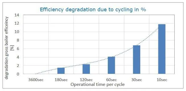

John Carroll Posted December 26, 2025 Posted December 26, 2025 (edited) From some horse's mouth re cycling and boiler efficiency degradation. Edited December 26, 2025 by John Carroll
marshian Posted December 26, 2025 Author Posted December 26, 2025 14 minutes ago, John Carroll said: From some horse's mouth re cycling and boiler efficiency degradation. Seen that before - my take away is that above 60 mins cycle time there is no efficency degradation - anything below that there is and the shorter the cycle the greater the eff loss
JohnMo Posted December 26, 2025 Posted December 26, 2025 Just now, marshian said: Seen that before - my take away is that above 60 mins cycle time there is no efficency degradation - anything below that there is and the shorter the cycle the greater the eff loss Definitely found that with mine, certainly once you get cycle times below about 10 mins, you may as well give up.

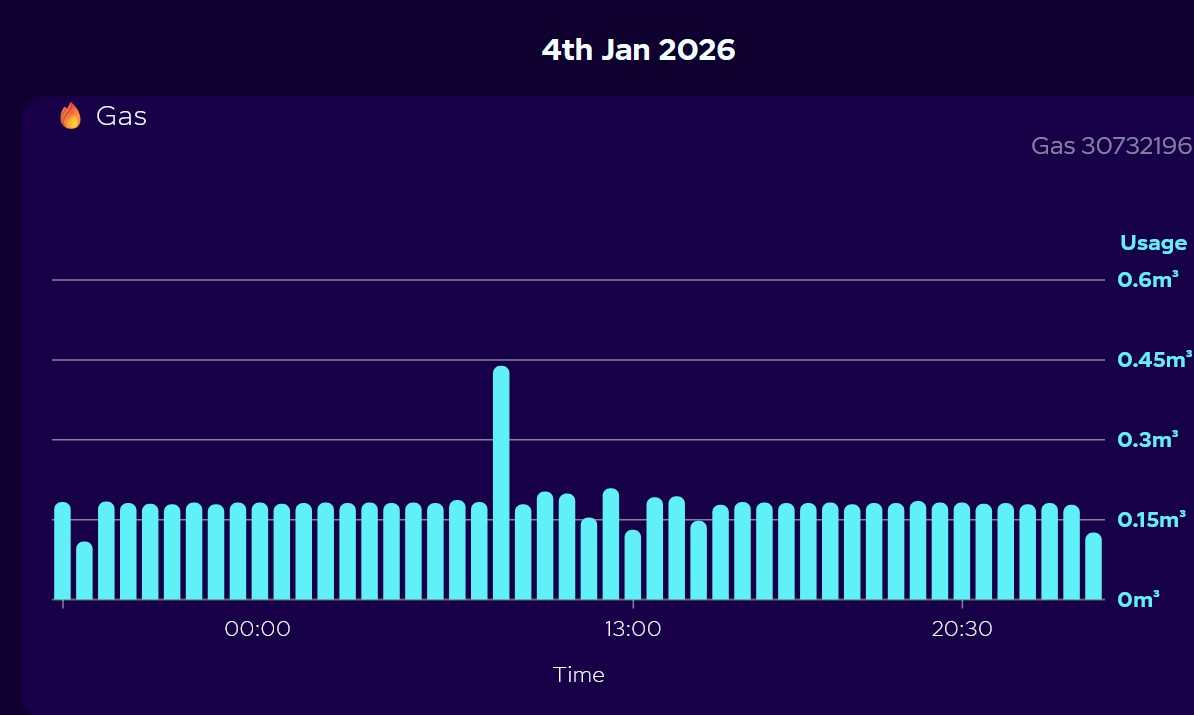

marshian Posted January 5 Author Posted January 5 OAT overnight -4.4 Deg C highest temp in the day -0.2 Deg C but it wasn't there for long All internal room temps held nice and stable Boiler ran from Midnight to just before 10am with one burn (it finished that burn just before the HW cycle was scheduled probably due to OAT warming up or the modulation blips threw the flow temp over target. Avg energy usage for that period 3.81 kWh That's quite impressive considering the modulation hiccups it has on a regular basis Looking like my heat loss calcs are a little more than actual ~4.25 kWh @ -2.5 OAT From my Octopus account Gas usage over the 24 hr period Overall the whole day saw the boiler do 7 cycles (normal is 20 to 24) Bloody modulation blips annoy me still..............
John Carroll Posted January 5 Posted January 5 31 minutes ago, marshian said: OAT overnight -4.4 Deg C highest temp in the day -0.2 Deg C but it wasn't there for long All internal room temps held nice and stable Boiler ran from Midnight to just before 10am with one burn (it finished that burn just before the HW cycle was scheduled probably due to OAT warming up or the modulation blips threw the flow temp over target. Avg energy usage for that period 3.81 kWh That's quite impressive considering the modulation hiccups it has on a regular basis Looking like my heat loss calcs are a little more than actual ~4.25 kWh @ -2.5 OAT From my Octopus account Gas usage over the 24 hr period Overall the whole day saw the boiler do 7 cycles (normal is 20 to 24) Bloody modulation blips annoy me still.............. If you ran from midnight to 10 AM, 10hrs, with a energy consumption of 3.81kWh then the average heat demand/boiler output was only 0.381kW, if the average power consumption was 3.81kW then the 10hr energy consumption was 38.1kWh.
marshian Posted January 5 Author Posted January 5 13 minutes ago, John Carroll said: If you ran from midnight to 10 AM, 10hrs, with a energy consumption of 3.81kWh then the average heat demand/boiler output was only 0.381kW, if the average power consumption was 3.81kW then the 10hr energy consumption was 38.1kWh. Avg energy consumption was 3.81 kWh Total Consumption was 38.1 kWh (38.1 divided by 10 hrs) 1

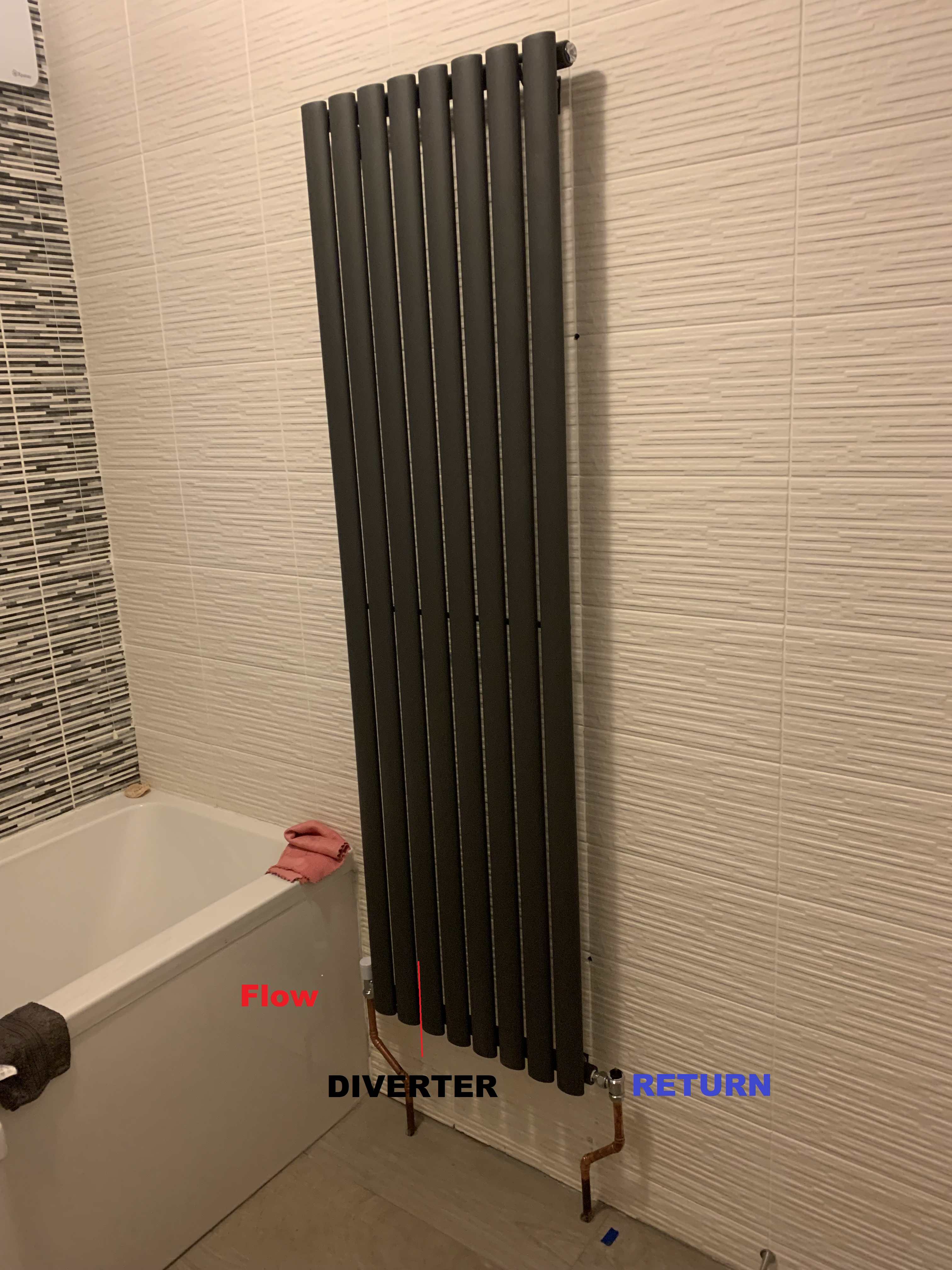

marshian Posted January 6 Author Posted January 6 I'm debating upgrading the two bathroom rads They are verticals - I purchased them in 2023 when I was still using the previous glow worm boiler that couldn't cope with a flow temp below 45 and I had to fit aftermarket diverters to make them work properly (picture below was from a thread on rubbish quality rads) Last winter I was transitioning from scheduled heating at higher temps to 24/7 with weather compensation so the bathroom temps were a lot warmer Now I've been running flow temps in the winter of low to mid 30's the bathrooms only reach 21 deg C - personally I find that OK but Mrs Alien feels that they need to be warmer (she does however like a long bath. They are rated at 0.89 kW at T50 - heat loss of the bathrooms is pretty much identical at 220 w What I'm trying to get my head round is how much larger a rad I need to get to a target of 23 Deg C with my current flow temps (I know I can get a double version of the on I have and Mrs Alien is happy with the asthetics.............. The current rads wouldn't go to waste as one could replace a towel rail rad in downstairs toilet and another in the utility room (both the towel rails used to be in the bathrooms but couldn't get the rooms to temp at 45 deg flow temps so were relocated to replace 1980's single panel single convectors rads rather than wasted) The utility room in particular has additional heat sources, tumble drier, Freezer, Fridge and washing machine so needs very little additional heat I might ask ChatGPT to see if it can work out what wattage I need to hit 23 seeing as that's the current trend for everything PS No the rooms wouldn't be continually heated to 23 - I'd manage the rooms temps with a setback when not bathing!!!
SimonD Posted January 6 Posted January 6 (edited) 25 minutes ago, marshian said: What I'm trying to get my head round is how much larger a rad I need to get to a target of 23 Deg C with my current flow temps (I know I can get a double version of the on I have and Mrs Alien is happy with the asthetics.............. With a flow return 35/30 something like DT50 output of 1985. Have a look and play with the attached spreadsheet. What I've generally found with radiators is that as soon as you get into the 35 and below flow temp and DT5 the sizes start to get quite ridiculous, especially with warmer rooms - e.g. with this one the conversion factor is 0.115 bathroom rad size estimate.ods Edited January 6 by SimonD
marshian Posted January 6 Author Posted January 6 11 minutes ago, SimonD said: With a flow return 35/30 something like DT50 output of 1985. Have a look and play with the attached spreadsheet. What I've generally found with radiators is that as soon as you get into the 35 and below flow temp and DT5 the sizes start to get quite ridiculous, especially with warmer rooms - e.g. with this one the conversion factor is 0.115 bathroom rad size estimate.ods 17.46 kB · 1 download Hmm that's interesting - Thank you A double version of what I currently have 1600 x 472 has an claimed output of 1579 w I could easily increase the height to 1800 x 472 and that has a claimed output of 1750 w It seems neither will get me to target (closer but no cigar as they say)
