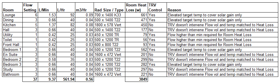

marshian Posted March 7, 2025 Author Posted March 7, 2025 (edited) 26 minutes ago, John Carroll said: Do you know the total T50 rated output of those 9 rads and what room/house temp you are aiming for. Yes I do - actually every damn rad dimensions and T50 output is in a spreadsheet I used it when I was working with the heat loss v rad output at various flow temps to work out where I needed to target the flow temp for the weather compensation at -2.4 Deg OAT Some of the individual rads I've tweaked the flow rates from where it was but overall system balance has remained the same. Front Hall, Toilet, Utility and Study remain on scheduled heating (heat loos of those rooms is a lot more because 3 external walls all on north facing side of the house All other rooms 24/7 Heat loss is overstated due to the software wanting higher ACH than I was comfortable with..... I also utterly badgered the dining room calc gave it a vaulted ceiling with no heated room above - Ooops True heat loss is absolute max 4.0kWh at -2.4 Deg C OAT (probably 3.6 kWh based on actual energy used if my monitoring is more accurate) Rooms & Rads.xlsx Edited March 7, 2025 by marshian Forgot target room temps
John Carroll Posted March 7, 2025 Posted March 7, 2025 I just used 12 rads output (ignored the ones in yellow) and calculated for a 9 rad output, I reckon that the 12 rads have a total T50 rating of ~ 17.6kW so 9 rads = 13.21kW (T50), the required max output seems to be ~ 4.77kW for those 12 rads = ~ 3.58kW for 9 rads. The required flowrate (for 9 rads) is ~ 0.475m3/hr, this then results in flowtemp/returntemp/dT/rads output. 41.55C/35.1C/6.48C/3.58kW At a (your) flowrate of 0.4m3/hr and flowtemp of 28.9C gives (my calcs) flowtemp/returntemp/dT/rads output. 28.9C/26.42C/2.48C/1.15kW Your data gave a calculated flowrate of only 0.06m3/hr (15% of 0.4m3/hr) flowtemp/returntemp/dT/rads output. 28.9C/20.4C/8.5C/0.6kW clearly something amiss somewhere? WC Rooms & Rads Mars Rev1.xlsx
marshian Posted March 11, 2025 Author Posted March 11, 2025 On 07/03/2025 at 20:45, John Carroll said: I just used 12 rads output (ignored the ones in yellow) and calculated for a 9 rad output, I reckon that the 12 rads have a total T50 rating of ~ 17.6kW so 9 rads = 13.21kW (T50), the required max output seems to be ~ 4.77kW for those 12 rads = ~ 3.58kW for 9 rads. Wrote a long reply and for some reason the forum or I had a blip and it never posted.......... Rooms/areas highlighted in are the hallway, stairwell and upstairs landings - they are all supplied by one ground floor rad I've amended the file to clarify which rads are 24/7 and which rads are scheduled (so only heated when needed) Rooms & Rads.xlsx On 07/03/2025 at 20:45, John Carroll said: The required flowrate (for 9 rads) is ~ 0.475m3/hr, this then results in flowtemp/returntemp/dT/rads output. 41.55C/35.1C/6.48C/3.58kW At a (your) flowrate of 0.4m3/hr and flowtemp of 28.9C gives (my calcs) flowtemp/returntemp/dT/rads output. 28.9C/26.42C/2.48C/1.15kW Your data gave a calculated flowrate of only 0.06m3/hr (15% of 0.4m3/hr) flowtemp/returntemp/dT/rads output. 28.9C/20.4C/8.5C/0.6kW clearly something amiss somewhere Well I'm not following that and I need to get my head round it One thing I have noticed is on PP3/6 the m3/hr number varies a lot - can be as low as 0.3 m3/hr to as much as 0.6 m3/hr which is also confusing me!!
John Carroll Posted March 11, 2025 Posted March 11, 2025 1 hour ago, marshian said: Wrote a long reply and for some reason the forum or I had a blip and it never posted.......... Rooms/areas highlighted in are the hallway, stairwell and upstairs landings - they are all supplied by one ground floor rad I've amended the file to clarify which rads are 24/7 and which rads are scheduled (so only heated when needed) Rooms & Rads.xlsx 12.37 kB · 1 download Well I'm not following that and I need to get my head round it One thing I have noticed is on PP3/6 the m3/hr number varies a lot - can be as low as 0.3 m3/hr to as much as 0.6 m3/hr which is also confusing me!! Will get back re rad outputs later. Re the pump, Are you saying that PP3 gives a flowrate of 0.3m3/hr and PP6 gives a flowrate of 0.6m3/hr? or, is the flowrate fluctuating while the setting is set on any one of the PP3 to PP6 settings?

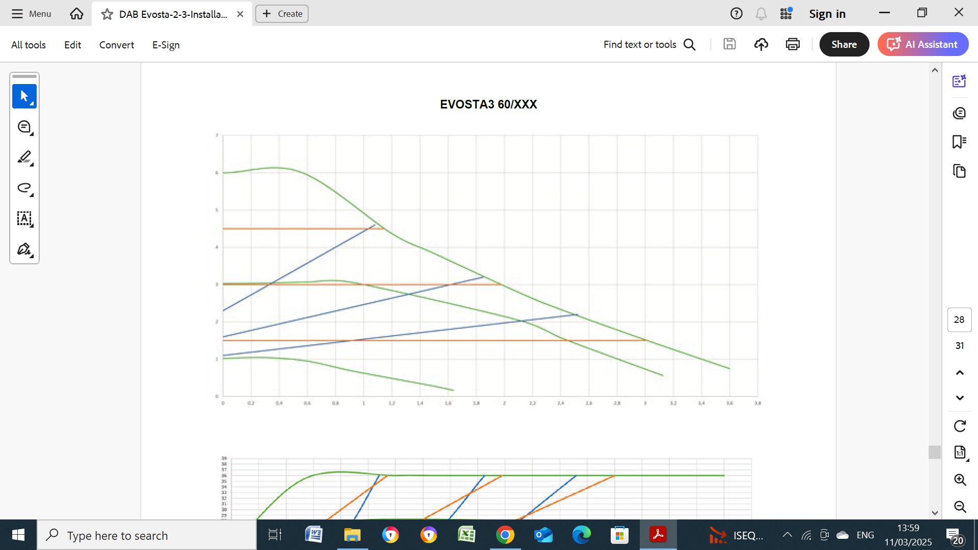

marshian Posted March 11, 2025 Author Posted March 11, 2025 50 minutes ago, John Carroll said: Will get back re rad outputs later. Re the pump, Are you saying that PP3 gives a flowrate of 0.3m3/hr and PP6 gives a flowrate of 0.6m3/hr? or, is the flowrate fluctuating while the setting is set on any one of the PP3 to PP6 settings? On PP3 (out of 6) I've been checking pump parameters and I'm seeing variation from 0.3 m3/hr to 0.6 m3/hr on the same setting (ie unchanged) I maybe expect a smidge more flow when all rads are in circuit and maybe a smidge less flow when it's just the 24/7 rads in circuit but not that level of change....... I need to get my head round the PP element of pump control
John Carroll Posted March 11, 2025 Posted March 11, 2025 (edited) 1 hour ago, marshian said: On PP3 (out of 6) I've been checking pump parameters and I'm seeing variation from 0.3 m3/hr to 0.6 m3/hr on the same setting (ie unchanged) I maybe expect a smidge more flow when all rads are in circuit and maybe a smidge less flow when it's just the 24/7 rads in circuit but not that level of change....... I need to get my head round the PP element of pump control I think I know exactly how PP control is supposed to work. If you look at the attachments, it will become pretty clear. On the graphs, the red line shows what the actual flow&head is as the pump ramps up in speed, the blue line is the PP setting, on PP2, zero flow is 1.6M & 3.2M is 1.85m3/hr, as the pump speed ramps up the actual flow and calculated PP flow become exactly the same at only one head, where the red&blue lines intersect, you can see more definition in the calculations. On CP2 you got a flow 0.5m3/hr at @ 3M head & 15W, these all correspond to exactly the very accurate Wilo data for my 6M wilo Yonos Pico so that flow and head are quite correct IMO. On PP2, using that flow&head, 0.5m3/hr@3.0M, results in a flow/head of 0.403m3/hr@1.95M and on PP3, 0.535m3/hr@3.44M. IF the flow&head are steady in CP mode then the should also, too, be steady in any PP mode, (a gradual change will take place if say TRVs are closing in etc.) Note though that the PP2 & PP3 settings are taken from the 3 standard settings shown in the screenshot but doesn't really matter as there shouldnt be any fluctuating PP settings. Dab Evosta3 PP2 Rev 0.xlsx Dab Evosta3 PP3 Rev 0.xlsx Edited March 11, 2025 by John Carroll
John Carroll Posted March 12, 2025 Posted March 12, 2025 This Graph is based on what may be the 6 PP settings, just change the values to see the effect on the head/flow. Dab Evosta3 PP Various Rev 0.xlsx

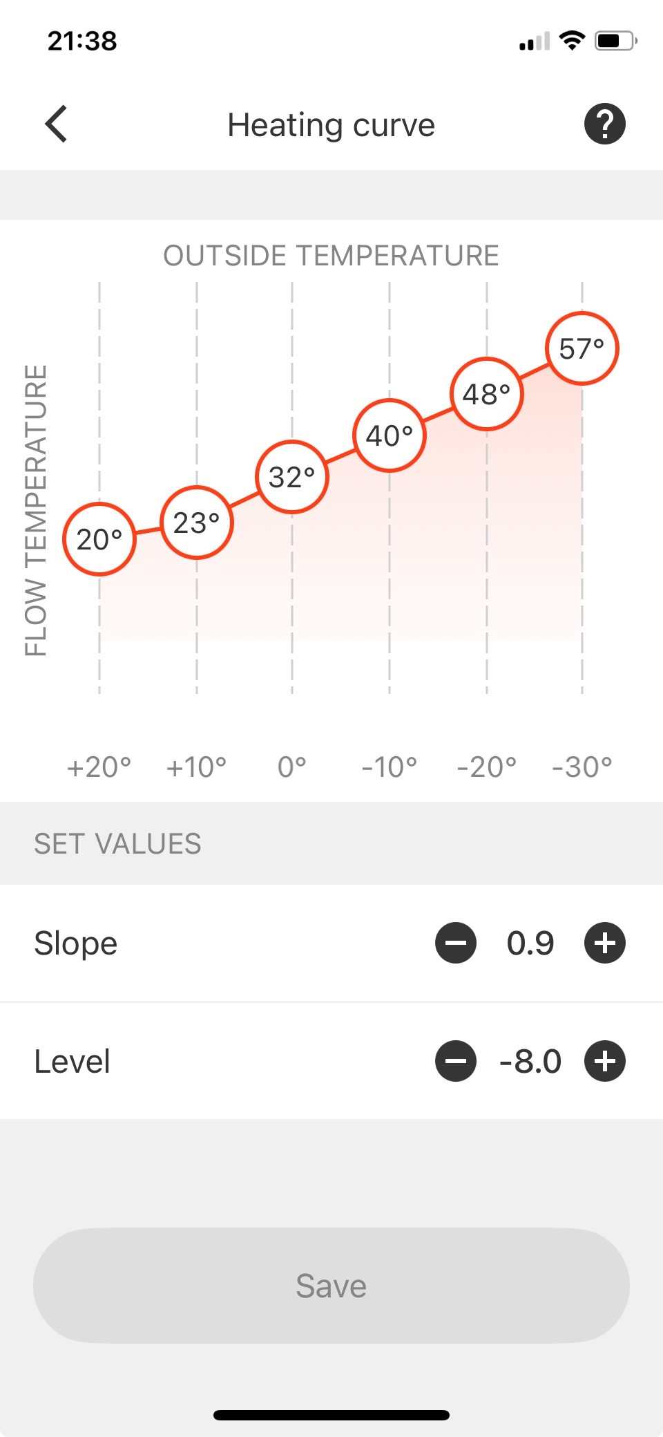

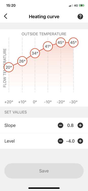

Sparrowhawk Posted June 20, 2025 Posted June 20, 2025 Good read @marshian, and that matches my experiences very closely. My heating curve ended up as Slope: 1.6 and Level: -7. It's still not perfect, as on days with lots of solar gain it overheats, while on other days, which are warmer outside but with no solar gain, the house is too cold. But I don't think that's fixable until we have better insulation and draft proofing. @Oz07 In my case we left the heating on 24/7 (previous years manually turned on/off) and our usage went from 13,300kWh to 14,500kWh - but the house was always comfortable, whereas in the previous year it had been down to 15C many winter evenings, and we were wearing coats indoors. This is still below the 16,500 kWh it was in 2021 when we tried to have it warmer with the old boiler.
marshian Posted June 20, 2025 Author Posted June 20, 2025 10 minutes ago, Sparrowhawk said: Good read @marshian, and that matches my experiences very closely. My heating curve ended up as Slope: 1.6 and Level: -7. It's still not perfect, as on days with lots of solar gain it overheats, while on other days, which are warmer outside but with no solar gain, the house is too cold. But I don't think that's fixable until we have better insulation and draft proofing. South facing rear of the house with french doors in both Dining Room and Living Room means solar gain is a useful bonus but doesn't really overheat until we are out of the heating season. What has really surprised me is how effective WC is in meeting the heating needs there were only a couple of times when it got caught out with big temp swings in a very short space of time But my manual weather compensation that I was doing before would have been caught out too 🙂 10 minutes ago, Sparrowhawk said: @Oz07 In my case we left the heating on 24/7 (previous years manually turned on/off) and our usage went from 13,300kWh to 14,500kWh - but the house was always comfortable, whereas in the previous year it had been down to 15C many winter evenings, and we were wearing coats indoors. This is still below the 16,500 kWh it was in 2021 when we tried to have it warmer with the old boiler. I think that's the benefit of WC and 24/7 - house temps are amazingly stable and as a result you can run slightly lower target room temps and it feels fine. I'm comfortable in temps from 17 to 19 with no drafts (lack of air movement makes a huge difference to comfort levels at lower room temps) Downside is Mrs Alien is slightly more sensitive to room temps and to her "toasty" is 22 and "Freezing" is 19 but she's getting used to the new regime and back end of winter had stopped declaring the house to be "like an ice box" at 20)

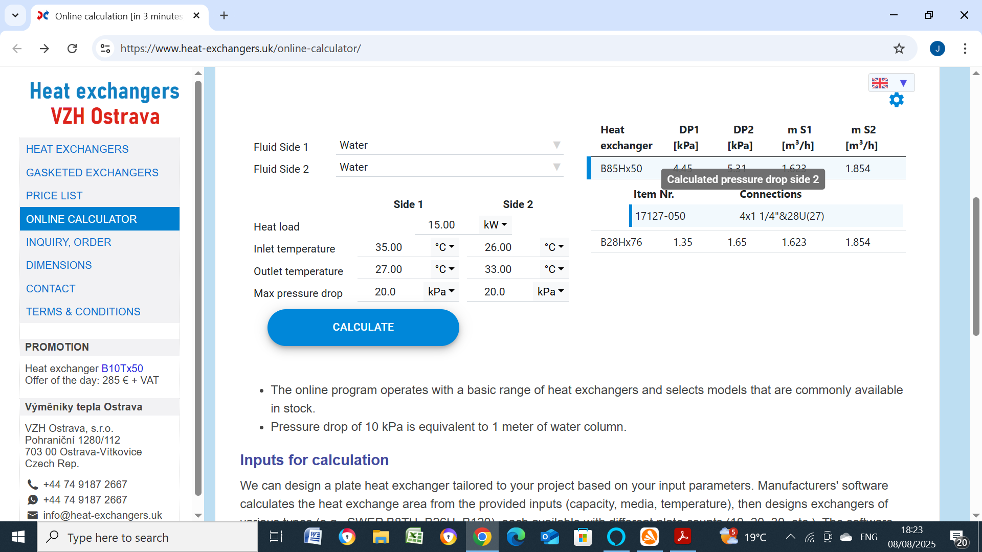

marshian Posted August 6, 2025 Author Posted August 6, 2025 I'm thinking this kit (20 Plate 15kW unit rather than the 30 Plate 20kW) because the boiler is 16kW - I'm not sure how much benefit I'd get from the 30 plate version but it's only £60 plus vat more https://beetbg.com/products/dhw-plate-loading-20xplate-kit?srsltid=AfmBOoodTI_0ue5CDsk2tfjQHhl6sCoT7GMV-jrUXRcS5F1xDFg7Ym7l DHW Cylinder Plate Loading 20 x Plate Kit - For up to 15kW heat load Heat Pump, Boiler £450 plus the vat Consists of the following 1x 20xPlate SWEP E8TH Heat Exchanger 1x EPP Hard Shell Insulation Jacket 4x 22mm x 3/4" Flat Faced Unions 1x DAB Bronze Pump 2x 22m Pump Valves 1x 22mm
JohnMo Posted August 6, 2025 Posted August 6, 2025 4 minutes ago, marshian said: not sure how much benefit I'd get from the 30 plate version but it's only £60 plus vat more The more surface area your heat exchanger has, the closer the approach temperature is (basically the difference between input and output temperature). Not done the maths, but 20 plate say 6 degs, and 30, 3 degs approach or a similar ratio, so 4 compared 2 etc. SWEP have an online calculator where you can put in all the figures and actually check. If I did it I would use the heat exchanger I have, which a large 40 plate (11m²). 1
marshian Posted August 6, 2025 Author Posted August 6, 2025 20 minutes ago, JohnMo said: The more surface area your heat exchanger has, the closer the approach temperature is (basically the difference between input and output temperature). Not done the maths, but 20 plate say 6 degs, and 30, 3 degs approach or a similar ratio, so 4 compared 2 etc. SWEP have an online calculator where you can put in all the figures and actually check. If I did it I would use the heat exchanger I have, which a large 40 plate (11m²). my boiler seems to work on CH with a delta between flow and return of 7 Deg - if the delta narrows it will cycle so maybe 20 plate will be more suitable - just trying to get my head round it so thanks for your contributions
JohnMo Posted August 6, 2025 Posted August 6, 2025 5 minutes ago, marshian said: my boiler seems to work on CH with a delta between flow and return of 7 Deg - if the delta narrows it will cycle so maybe 20 plate will be more suitable - just trying to get my head round it so thanks for your contributions Lots of dT's at play. Boiler dT, dT between boiler flow and the water the other side of the heat exchanger (approach temp). dT from boiler is driven, by boiler algorithm, so flow rate and also how quickly whatever you are heating (air from radiators or water in cylinder) can take that heat away. You know from experience for example, that to stop your boiler from cycling when doing CH while wanting to do low flow temps, you had to up the size of some/all your radiators. Your cylinder heat exchanger is exactly the same. Big HE allows low flow temps AND allows boiler to manage the boiler dT. A smaller HE demands a higher flow temp to enable boiler to manage its own dT with cycling. 1
John Carroll Posted August 8, 2025 Posted August 8, 2025 (edited) On 06/08/2025 at 11:52, marshian said: I'm thinking this kit (20 Plate 15kW unit rather than the 30 Plate 20kW) because the boiler is 16kW - I'm not sure how much benefit I'd get from the 30 plate version but it's only £60 plus vat more https://beetbg.com/products/dhw-plate-loading-20xplate-kit?srsltid=AfmBOoodTI_0ue5CDsk2tfjQHhl6sCoT7GMV-jrUXRcS5F1xDFg7Ym7l DHW Cylinder Plate Loading 20 x Plate Kit - For up to 15kW heat load Heat Pump, Boiler £450 plus the vat Consists of the following 1x 20xPlate SWEP E8TH Heat Exchanger 1x EPP Hard Shell Insulation Jacket 4x 22mm x 3/4" Flat Faced Unions 1x DAB Bronze Pump 2x 22m Pump Valves 1x 22mm I'd definitely agree that a E8TH x 20, approx 0.6m2 heating surface would be pretty useless in getting a close approach temperature for you, I don't know why the manufacturers specify these (20)kW etc ratings which only apply at extremely high dts at something like 40C. As stated above the bigger (within reason) the better. Here is one that should give 15.0kW output with a approach temperature of ~ 2C, its a B85H x 50, 3.13M2. which might suit your conditions, if you select price list you can calculate the heating surface for any required PHEX, they also seem to suggest a B28H x 76, at 4.75M2. Its probably best to email your requirements to them and possibly to Nordic as well as UK Heat Exchangers. Edited August 8, 2025 by John Carroll
marshian Posted August 9, 2025 Author Posted August 9, 2025 14 hours ago, John Carroll said: I'd definitely agree that a E8TH x 20, approx 0.6m2 heating surface would be pretty useless in getting a close approach temperature for you, I don't know why the manufacturers specify these (20)kW etc ratings which only apply at extremely high dts at something like 40C. As stated above the bigger (within reason) the better. Here is one that should give 15.0kW output with a approach temperature of ~ 2C, its a B85H x 50, 3.13M2. which might suit your conditions, if you select price list you can calculate the heating surface for any required PHEX, they also seem to suggest a B28H x 76, at 4.75M2. Its probably best to email your requirements to them and possibly to Nordic as well as UK Heat Exchangers. I’m slightly confused (nothing unusual there!!!) water flow temp to the PHE has to be above the target tank temp no mater how efficient or how much surface area it has so if I want water at lets say 45 deg C then the flow temp needs to be above that I’m not looking to heat the radiator circuit with a PHE - the boiler copes nicely with a flow temp from 25 to 35 for the rad circuit (it doesn’t mind a delta of anywhere between 5 & 7 deg as long as the circuit is unrestrictive (ie full circuit available to it) needed to heat water today quickly this morning - tank temp start 25 deg (flow temp ramped to max 80) had a 10 deg delta at the boiler at the end of the 30 min cycle) and had the usual issue of a massive overshoot of tank temp (stat set to 50 deg) top got to 57 before bottom got to 50 and it used 4.88 kWh of gas heating with a lower flow temp (62 Deg C) stat would have switched off at 50 with virtually no difference between top and bottom of the tank and used 1 kWh less energy (this is how I do my water heating in the winter to shorten the cycle time and get back to CH before the house temp drops) My existing tank coil I think is maybe a 3kW one - certainly looking at similar tanks for sale the coil surface area is going to be maybe 0.5 m2 if that. I’d like to get away from high flow temps but still heat in a shorter time period - my thought was either new tank with heat pump compatible coil size 3m2 surface area or PHE with similar surface area and bronze pump to circulate Ideal world I’d like to achieve flow temp of less than 55 deg C and a target tank temp of 50 deg C with 115 litres of water at 25 deg C heated in a maximum of 30 mins max with one boiler cycle (ie it fires once and runs till stat satisfied - not cycle several times to achieve the target) If I tried to do that with current set up I estimate that HW cycle would need to be 90 mins and the boiler would fire maybe 3 or 4 times with ever shorter burn lengths and still wouldn’t achieve the target tank temp although it would probably be close)

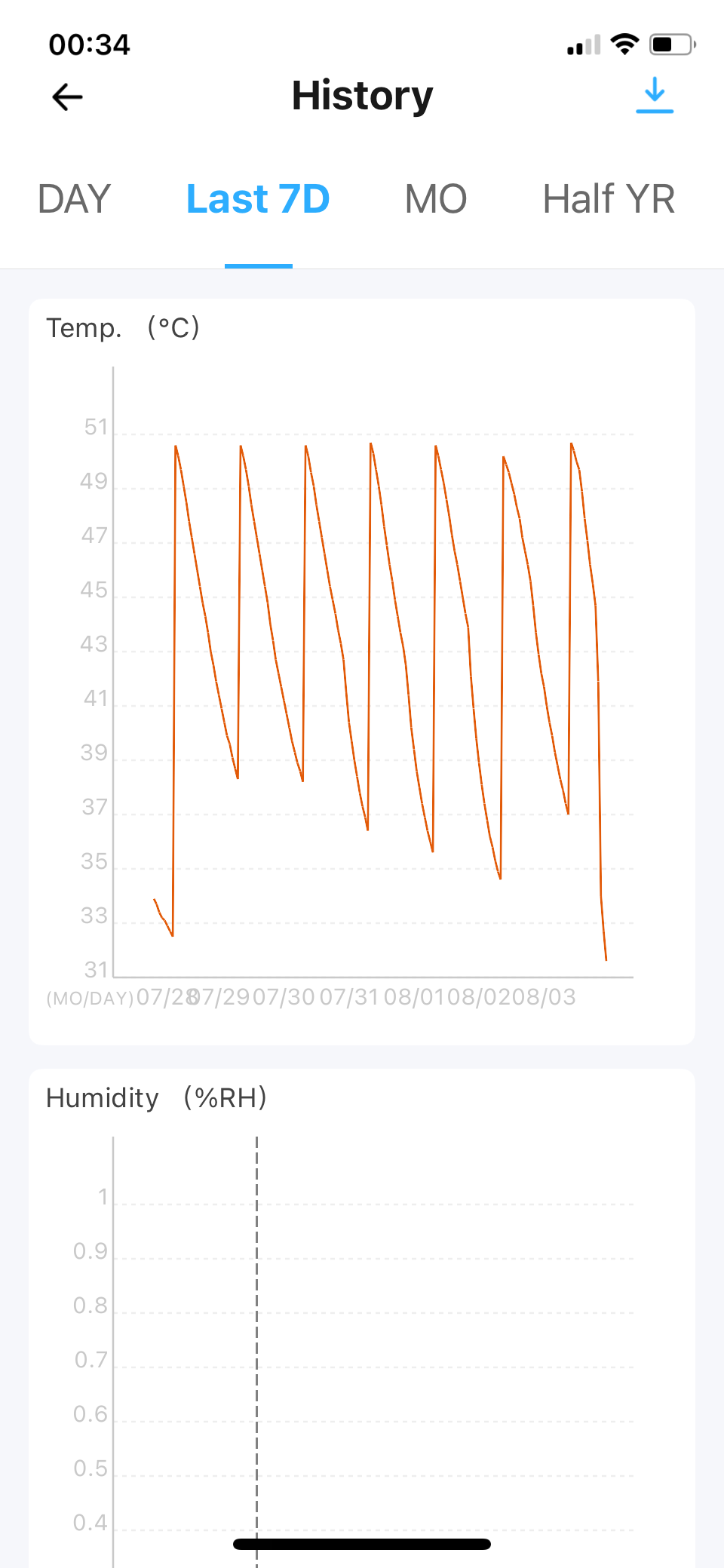

marshian Posted August 9, 2025 Author Posted August 9, 2025 Stats from this morning (all Deg C) peak/end temps taken just before cycle ended start Tank Top (start) 31.3 Tank Bottom (start) 26.2 flow temp peak 77.5 return temp peak 66.4 Tank Top (near end) 55.2 Tank Bottom (near end) 47.6 my temp monitoring records all temps on the hour every hour (you can see current temp at any time but the data is only logged at hourly intervals) Does mean I have a really clear knowledge of my tank temp losses over time)
