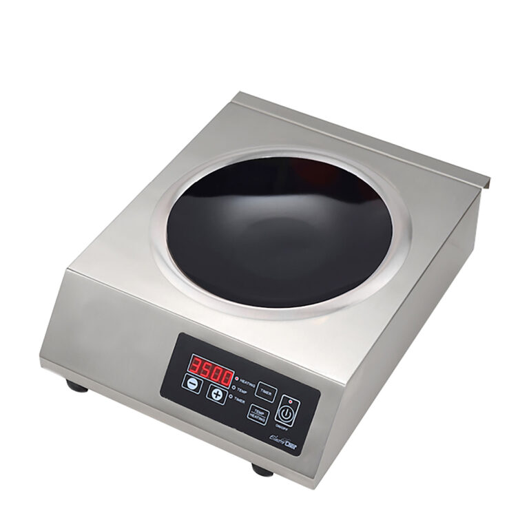

Nick Thomas Posted September 25, 2024 Posted September 25, 2024 52 minutes ago, allthatpebbledash said: But we love to cook with gas. Woks and Karahi require it for the true chefs and authentic recipes. Not to mention to make a good chai. Up to you of course, but just in case you weren't aware, you can get specialised induction hobs for at least woks, e.g: I have a friend who absolutely refuses to switch; I'm beginning to suspect she just likes the gas fumes ^^. No idea about karahi though. Best of luck with the refit! Keep us updated. 1
