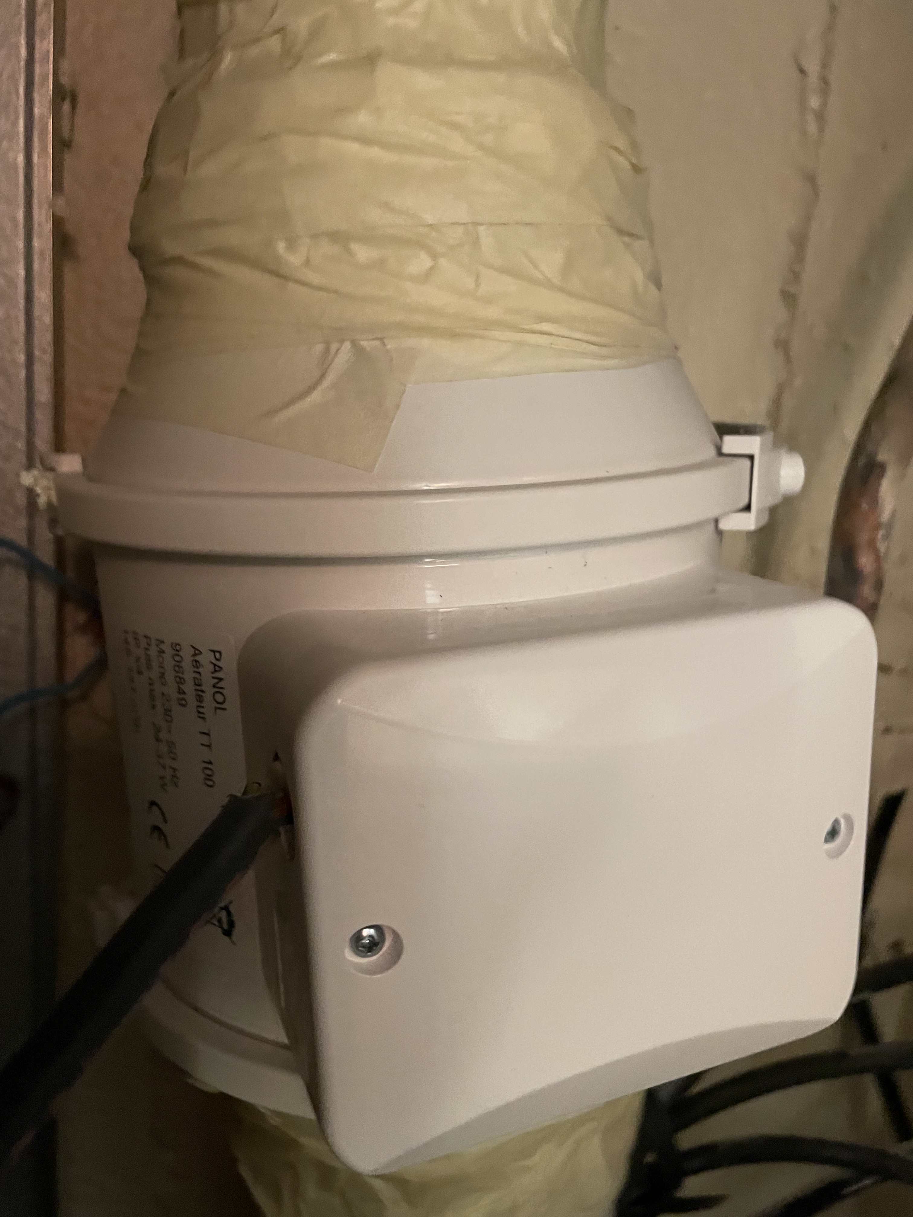

Garald Posted September 21 Share Posted September 21 I returned from travel to be greeted by a strange trac-trac-trac ventilation noise (even though I had set the PIV to a minimum). It seems to come not from the main PIV unit as such, but from this duct going next to it: (Yes, both the PIV unit and this are above a kitchenette‘s false ceiling.) What is this? Whom to call? What is the issue likely to be? Link to comment Share on other sites More sharing options...
ProDave Posted September 21 Share Posted September 21 That's an in line fan. You need to oncouple the ducts both ends and work out if it is the fan itself that has failed or something in duct catching on the fab blades. Link to comment Share on other sites More sharing options...
Garald Posted September 21 Author Share Posted September 21 (edited) 12 minutes ago, ProDave said: That's an in line fan. You need to oncouple the ducts both ends and work out if it is the fan itself that has failed or something in duct catching on the fab blades. Is this something I can do myself, or should I call a technician? Also, I take this is connected to the kitchen extractor (which I barely ever turn on) rather than to the PIV? Edited September 21 by Garald Link to comment Share on other sites More sharing options...

Mike Posted Sunday at 22:42 Share Posted Sunday at 22:42 On 21/09/2024 at 09:35, Garald said: Also, I take this is connected to the kitchen extractor (which I barely ever turn on) rather than to the PIV? It's an extractor fan (with a 2-year warranty): http://www.panol.fr/product.php?productid=17793 And that tape is not good. Link to comment Share on other sites More sharing options...
Garald Posted Sunday at 23:16 Author Share Posted Sunday at 23:16 32 minutes ago, Mike said: It's an extractor fan (with a 2-year warranty): http://www.panol.fr/product.php?productid=17793 Right, but what would it ever be a part of? It wouldn't be a part of the PIV system, and I don't think it would be part of the smell extractor in the kitchen, would it? Perhaps that tube goes all the way to the laundry room, where there is an unnecessary extractor fan that is on all the time? >And that tape is not good. Shoddy workmanship I take? What should they have used instead? Link to comment Share on other sites More sharing options...
Mike Posted Tuesday at 20:07 Share Posted Tuesday at 20:07 On 23/09/2024 at 01:16, Garald said: Right, but what would it ever be a part of? It wouldn't be a part of the PIV system, and I don't think it would be part of the smell extractor in the kitchen, would it? Perhaps that tube goes all the way to the laundry room, where there is an unnecessary extractor fan that is on all the time? More commonly kitchen or bathroom, but could be utility. You'll need to trace the duct or thread something along it if you want to know. Or test the airflow at the grille - that is, see if a piece of tissue paper 'sticks' to the grille when the fan is on, and falls off if you turn it off. On 23/09/2024 at 01:16, Garald said: Shoddy workmanship I take? What should they have used instead? Poor choice of material, in particular. Provided the duct & fan fit together then use either an aluminium foil HVAC tape or, since it won't be running at a high temperature, an airtightness tape such as Pro Clima Tescon Vana. Link to comment Share on other sites More sharing options...
Garald Posted Wednesday at 18:02 Author Share Posted Wednesday at 18:02 In the end, it turns out to be a duct for an extractor fan in my vestibule/laundry room. It’s unclear that I actually need an extractor fan there; the dryer is one of those new models that condense humidity and store it in a receptacle that then needs to be emptied, rather than release it in the surrounding air. What do you think? Link to comment Share on other sites More sharing options...
Mike Posted Wednesday at 18:09 Share Posted Wednesday at 18:09 4 minutes ago, Garald said: the dryer is one of those new models that condense humidity I agree that it's not required while you have that type of dryer. Link to comment Share on other sites More sharing options...
Garald Posted Wednesday at 20:46 Author Share Posted Wednesday at 20:46 Very well. Should I just figure out how to turn off both the extractor in the picture and the fan in my entryway/laundry for good? Or do I need to pay someone to actually remove that duct and both fans and close the fan outlet? (That is, can a duct that just sits there make trouble in the long run?) Link to comment Share on other sites More sharing options...
Mike Posted Wednesday at 22:50 Share Posted Wednesday at 22:50 In France a laundry room does normally have mechanical extract fitted - I think the regs (DTU 68.3) require that - so I'd disable it and probably block the exit from the house in a reversible way, rather than strip everything out and seal it off permanently. 1 Link to comment Share on other sites More sharing options...
Garald Posted Thursday at 05:04 Author Share Posted Thursday at 05:04 6 hours ago, Mike said: In France a laundry room does normally have mechanical extract fitted - I think the regs (DTU 68.3) require that - so I'd disable it and probably block the exit from the house in a reversible way, rather than strip everything out and seal it off permanently. Ah, so the important thing is to block the *exit* from the house? It’s a pity if one can’t remove the bit of pipe photographed here - one could then shift the VMI, which is now fitted in an extremely cramped way (one needs to twist the filter to change it). Link to comment Share on other sites More sharing options...

Mike Posted Thursday at 11:27 Share Posted Thursday at 11:27 5 hours ago, Garald said: Ah, so the important thing is to block the *exit* from the house? The perimeter of the heated envelope is the best place, in terms of minimising heat loss. Blocking it at both ends could lead to greater condensation (than otherwise) between the blockages. 4 hours ago, Garald said: I've found the regulations, but I am not getting any hits for "laundry" (buanderie): https://dn790002.ca.archive.org/0/items/dtu-237-www.-engcopilot.-com-nf-dtu-59.1-p-1-1/DTU_292_WWW.ENGCOPILOT.COM-NF DTU 68.3 P1-1-2.pdf Buanderie wouldn't necessarily be mentioned - utility rooms (with a water supply) fall under the definition of salle d'eau - https://www.batiment-ventilation.fr/outils/faq/dans-larrete-de-mars-1982-quelle-est-la-difference-entre-une-salle-deau-et-une-salle-de-bains-105 (a room other than the kitchen or WC, equipped with a water supply, but without a bath or shower) I'm not an expert on the text (and don't have time to read it!), however it could be because you only tracked down part 1-1-2, or because my memory is wrong (since I have a VMC double-flux). For a more definitive view, polish off your French and ask at the forumconstruire (which comes up with this, and others: https://www.forumconstruire.com/construire/topic-395665-bouche-extraction-buanderie.php) 1 Link to comment Share on other sites More sharing options...
