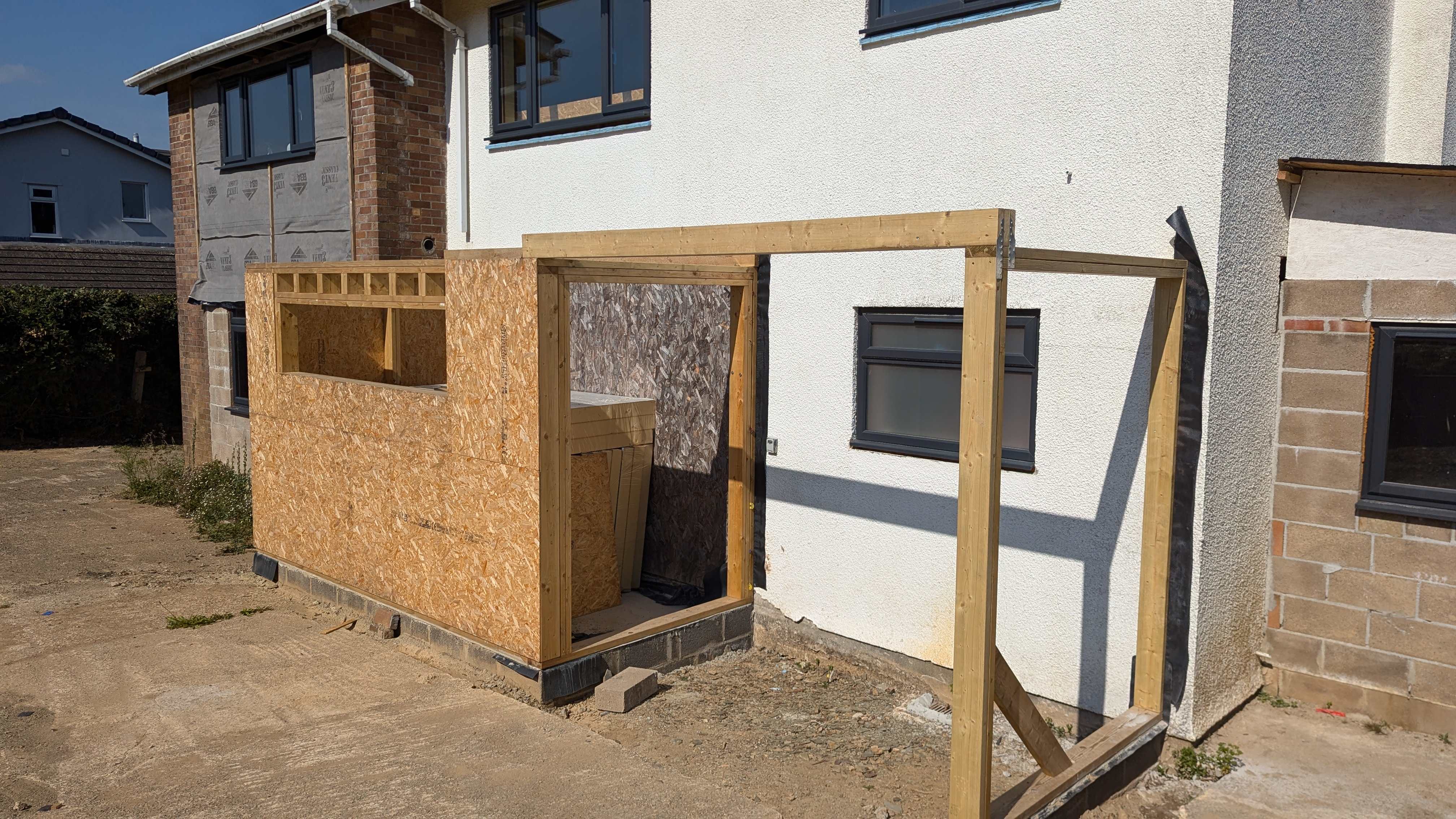

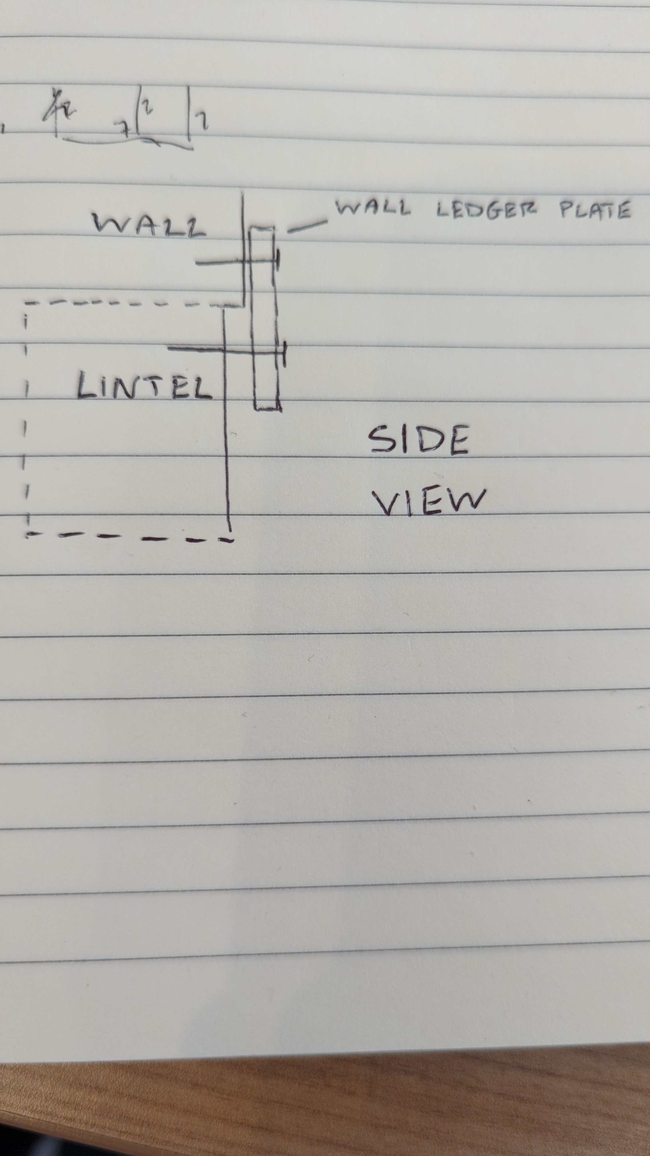

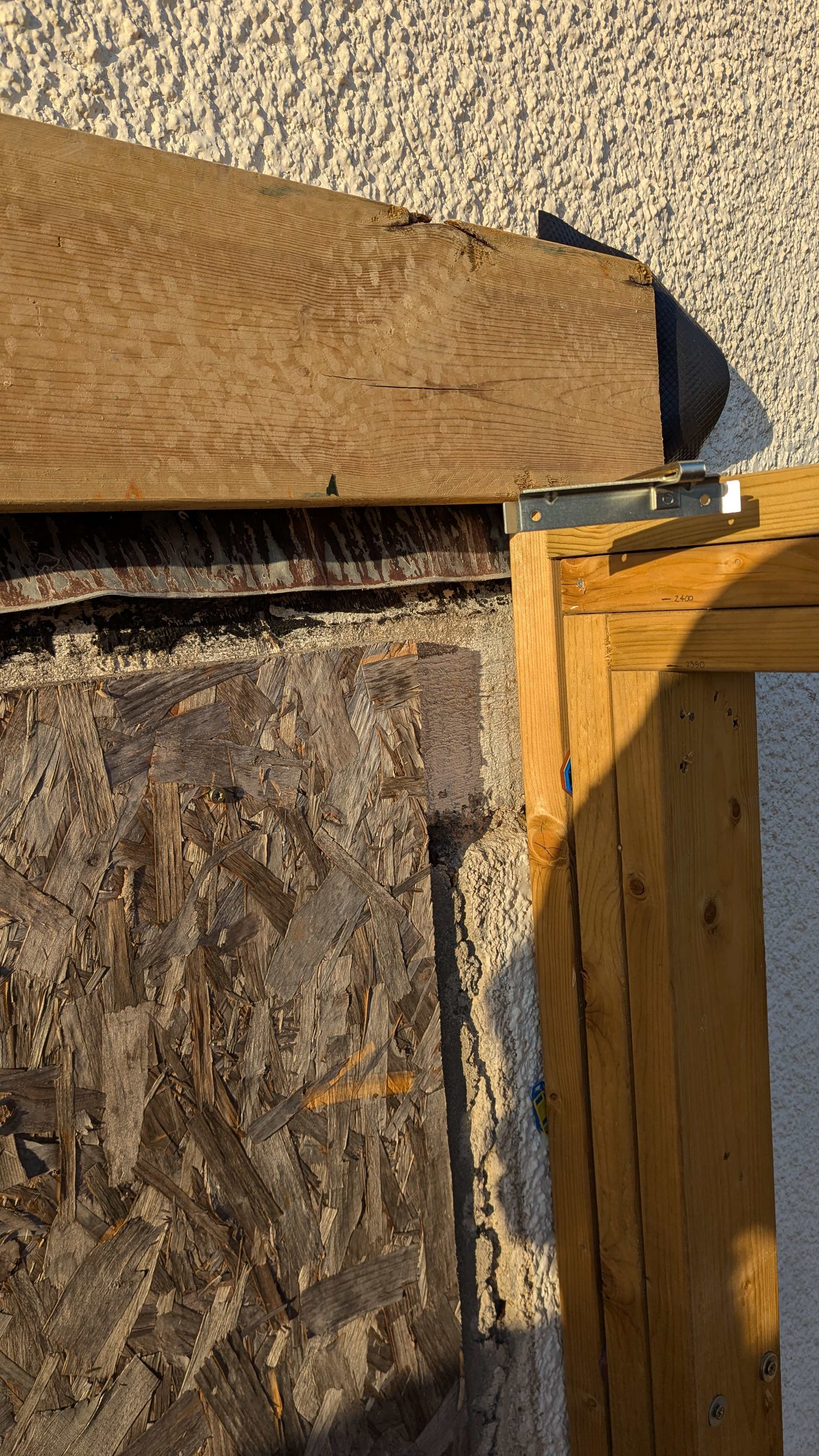

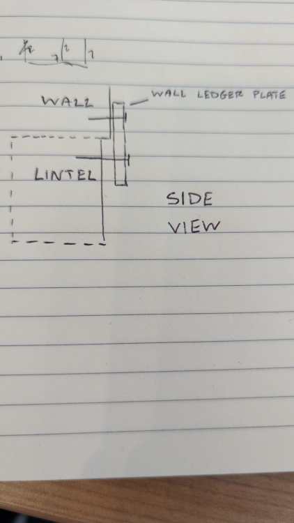

Rick734 Posted September 19 Share Posted September 19 Morning folks, Hoping for some assistance with this one, I need to bolt a ledger plate to the front wall of the house to take the roof joists for the new porch (which is approx 7m long x 2m deep i.e. not massive roof load). My problem is that at the height I want it, the ledger plate sits partly in front of an existing concrete lintel which I'd need to bolt into (as well as the wall above) to secure the wall plate. Lintel is pretty massive at around 280h and 240d and I'd only need to bolt into the top half of it...anyone know if that's a good idea or alternatively if there's a better solution? You can see most of the height of the lintel below the unfixed wall plate (which needs to drop down a bit further)... Link to comment Share on other sites More sharing options...

Russell griffiths Posted September 19 Share Posted September 19 What does the lintel span, if it’s only a short opening then I think the risk of damage to the lintel is minimal i would use a resin and threaded rod not a bolt that expands. Link to comment Share on other sites More sharing options...
joe90 Posted September 19 Share Posted September 19 1 minute ago, Russell griffiths said: would use a resin and threaded rod not a bolt that expands. +1 1 Link to comment Share on other sites More sharing options...
Rick734 Posted September 19 Author Share Posted September 19 12 minutes ago, Russell griffiths said: What does the lintel span, if it’s only a short opening then I think the risk of damage to the lintel is minimal i would use a resin and threaded rod not a bolt that expands. Thanks, it spans approx 3.6m which is the opening from the porch into the hall. Happy to go the resin route, was just debating the pros and cons of either so thanks. Link to comment Share on other sites More sharing options...
Russell griffiths Posted September 19 Share Posted September 19 That’s a big opening I might stop and re think this situation, we don’t know enough about the whole job. can you not enlarge that timber so it spans the same opening and only needs the fixings into the brickwork above. 1 Link to comment Share on other sites More sharing options...
saveasteading Posted September 19 Share Posted September 19 Ahhh. precast lintels usually have tensioned wire in them. cut that and it loses lots of the strength. I think (!) the wires are in the middle, so drilling at 1/4 to 1/3 points might be safest. use the smallest fixing that will work x maybe more of them. I agree threaded rod and epoxy. 1 hour ago, Russell griffiths said: I might stop and re think this situation, we don’t know enough about the whole job. agreed. Is there another way? Link to comment Share on other sites More sharing options...
Rick734 Posted September 19 Author Share Posted September 19 (edited) Thanks Russell/Save, it is a decent size opening and agreed definitely not ideal to drill into it. Might be able to keep the ledger plate high enough to just fix into the blockwork if I can use long leg joist hangars to drop down to the right level - any idea if that's acceptable? I guess they'd be hanging down off the bottom of the ledger plate by approx 150mm to get the heights right...maybe could fix another piece of timber to the bottom of it for extra strength/rigidity...does that make sense? Something like this: Edited September 19 by Rick734 Link to comment Share on other sites More sharing options...

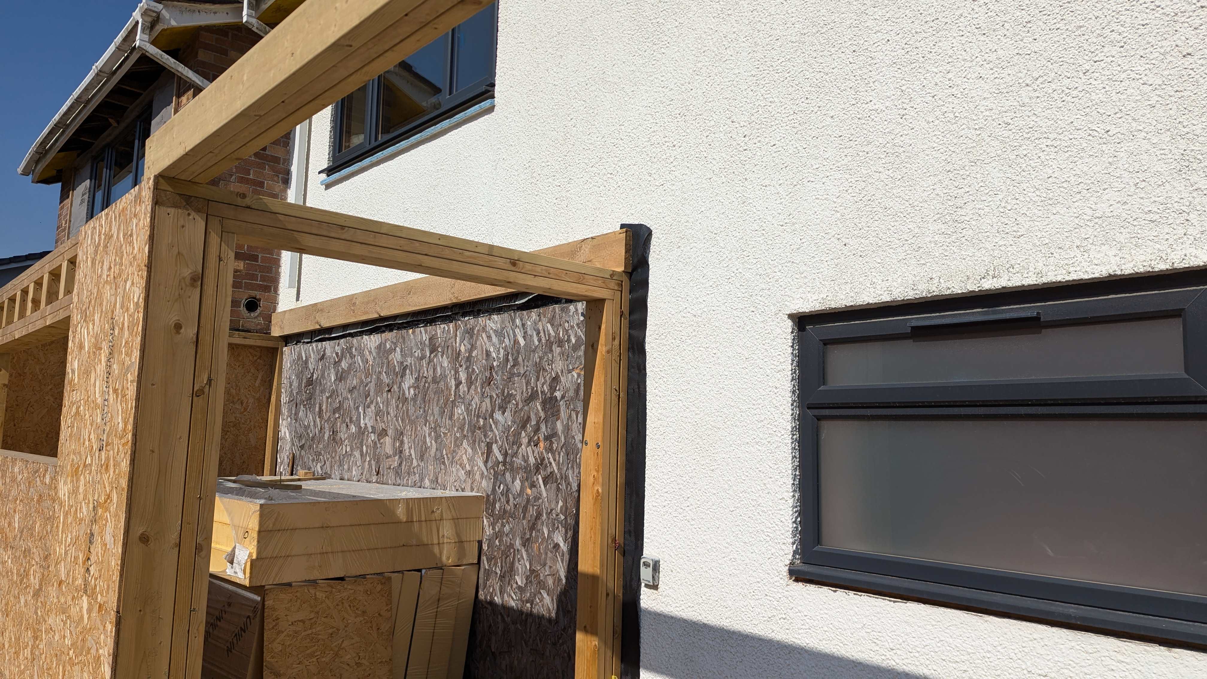

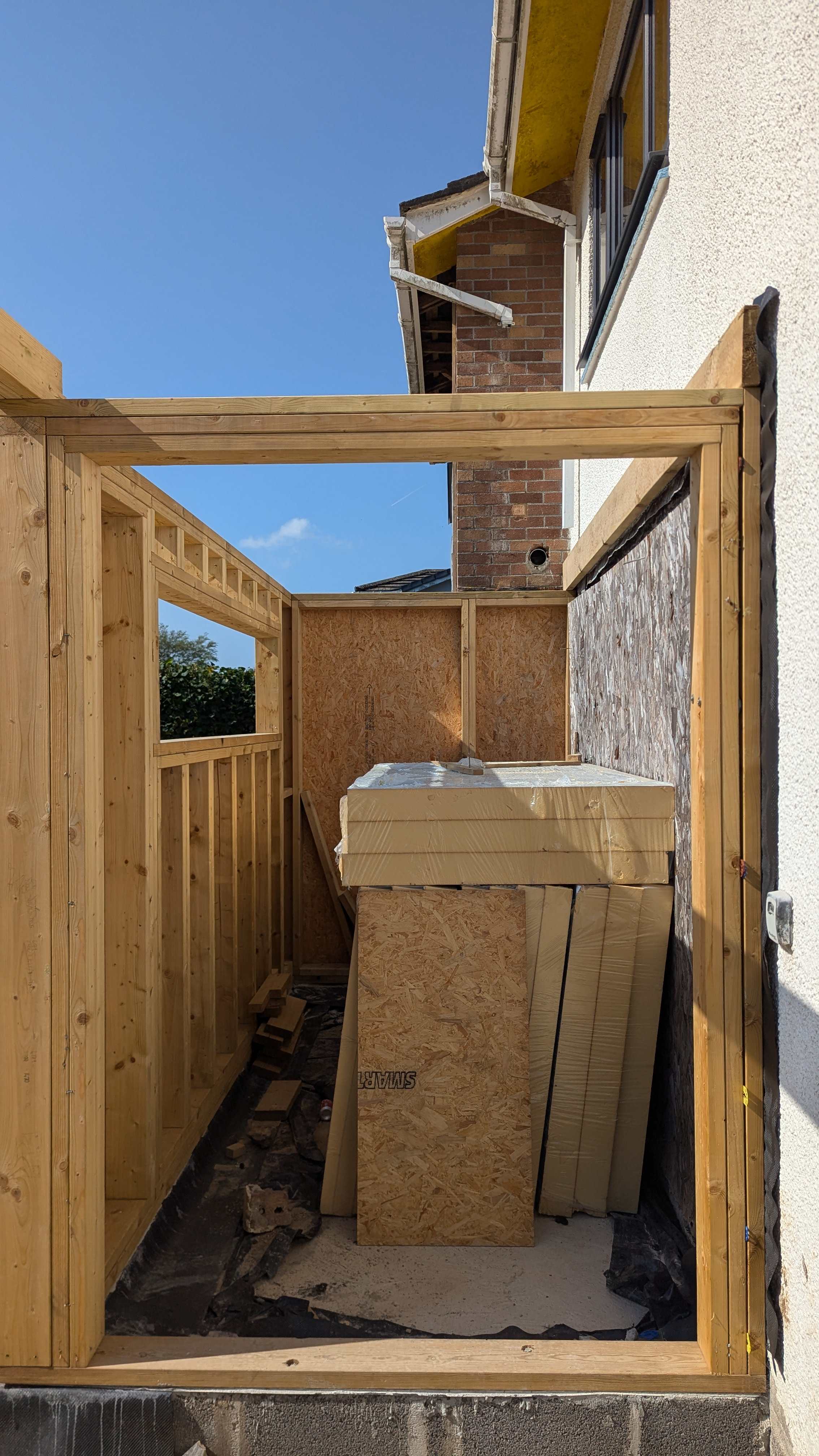

Rick734 Posted September 20 Author Share Posted September 20 @Russell griffiths Images attached - overall porch size is 7.2x2m approx. So pretty small as flat roofs go. Having looked at it last night I think I might go down the route of lifting the ledge plate just enough to get all fixings into the blockwork, and then use a long-leg joist hanger to drop down below the bottom of it to take the roof joists at the right height. Sound sensible? Link to comment Share on other sites More sharing options...
