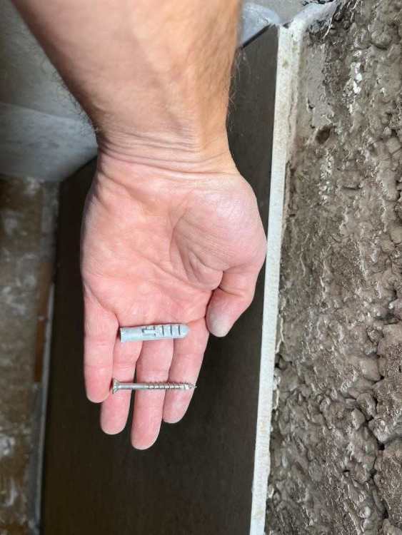

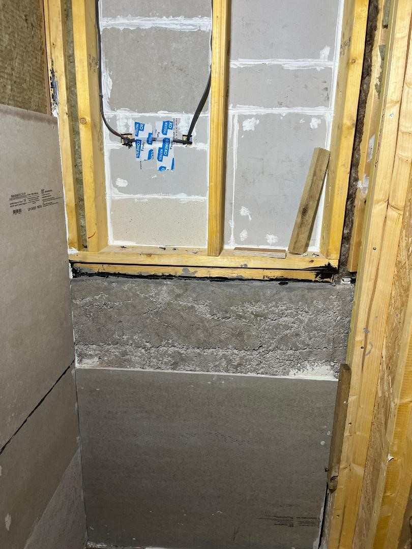

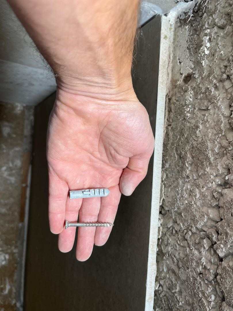

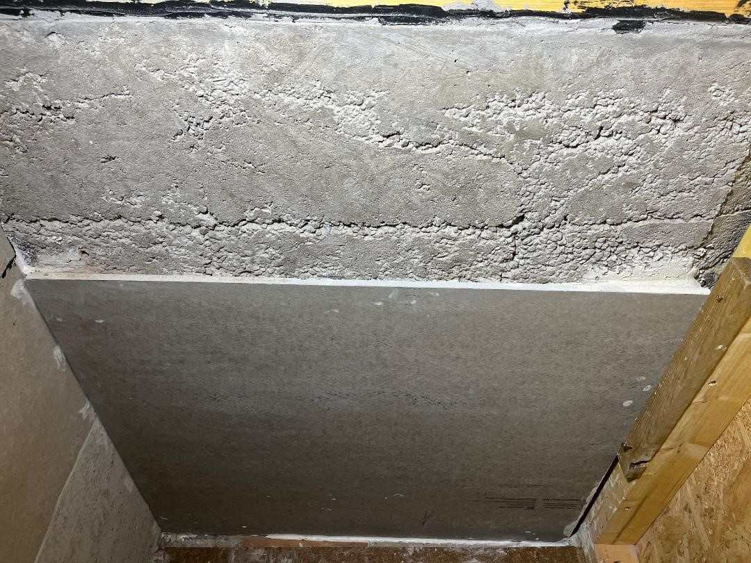

markharro Posted September 18, 2024 Author Posted September 18, 2024 Thanks @Russell griffiths and @Alan Ambrose here is where I have got to so far. Next step to screw the board to the concrete. I have the fixings in the photo - the SS screws are 50mm. Will these be long enough? Also how many screws and what pattern for this section of board which is 800mm high by 900mm wide? thanks,

Russell griffiths Posted September 19, 2024 Posted September 19, 2024 Roughly every 200mm you can go 150 around the perimeter, but if it’s well stuck on thats ott, every 300 would still be ok. are you boarding over that timber ? if so I would have boarded that first to make sure your lower wall is in line.
markharro Posted September 19, 2024 Author Posted September 19, 2024 Thanks @Russell griffiths thats helpful. What about the screw length though - would 50mm be enough? Yes boarding up over the timber. I see what you mean about starting there and working down.....next time I will know better. I have planed the studs so that an 18mm ply spacer should level the board with the one below - hopefully!
