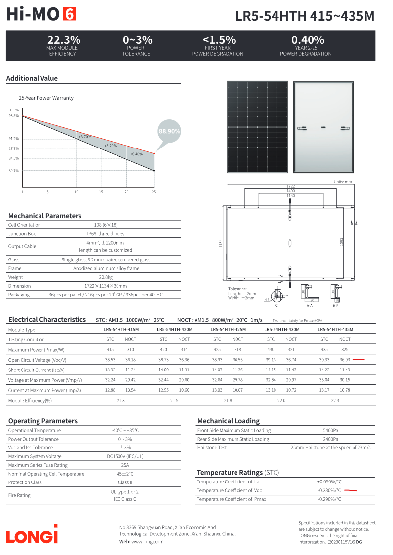

Marvin Posted Sunday at 21:15 Share Posted Sunday at 21:15 I have 16 Longi 320W panels and wish to add some more but they are now discontinued I have found the LONGi Solar Hi-MO 6 435WP Black Frame PV Module LR5-54HTH-435M (435Watt) Technical details: 320Watts panels 435Watt panels STC NOCT STC NOCT Power 320 237.1 Power 435 325 Voc\V 40.9 38.2 Voc\V 39.33 36.93 Vmp\V 33.9 31.3 Vmp\V 33.04 30.15 Is it ok to mix them? If not, what specification would be better if I cannot obtain exactly the same. If so what are the pros and cons. Any guidance would be appreciated. M Link to comment Share on other sites More sharing options...
Mattg4321 Posted Monday at 06:14 Share Posted Monday at 06:14 (edited) I wouldn’t mix those on the same MPPT, but somebody more experienced than me with PV might come along and say that’s wrong. I’d imagine that the output of the newer panels would be compromised, and dragged down to the output of the old panels. You may even be nearing the max MPPT voltage rating anyway. On a separate MPPT or inverter, of course, crack on - subject to DNO approval if grid tied. Edited Monday at 06:15 by Mattg4321 1 Link to comment Share on other sites More sharing options...

Dillsue Posted Monday at 17:18 Share Posted Monday at 17:18 Easiest way to add the bigger panels is to wire them to a separate MPPT input on your existing inverter. Next easiest, but may not be ideal, is to get someone to calculate the output for the various panel combinations to see if they can be wired to your existing inverter, if no spare MPPT input. Next is to replace your inverter with one that has a spare MPPT input. Lastly add optimisers/micro inverters which allows you to mix and match panels freely Link to comment Share on other sites More sharing options...

Marvin Posted Monday at 21:03 Author Share Posted Monday at 21:03 Thanks for all the replies. I am a little ahead of the game with some items: The DNO permission is based on the maximum the inverter will allow to supply back to the grid which is 6000W The Inverter can cope with 7980 Watts of panels in the UK. The Inverter has 2 strings (MTTP) which can run up to 4000W max each. The existing set up has 16 x 320Watt panels = 5120W which is 64% of potential String 1 7 panels 2,240 Watts 56% String 2 9 panels 2,880 Watts 72% The Inverter is capable of taking the amperage. The solar DC cable is 6mm and about two separate 27m loops The AC cable from the inverter is 22m of 6mm clipped direct with some conduit/trunking - easily capable of taking 6kW. Hi @JohnMo Thanks for the link. I have now read it and it is clear to me. I will now calculate what the results would be. Link to comment Share on other sites More sharing options...

SimC Posted Tuesday at 18:07 Share Posted Tuesday at 18:07 (edited) On 15/09/2024 at 22:15, Marvin said: 320Watts panels 435Watt panels STC NOCT STC NOCT Power 320 237.1 Power 435 325 Voc\V 40.9 38.2 Voc\V 39.33 36.93 Vmp\V 33.9 31.3 Vmp\V 33.04 30.15 Another significant parameter is the current under STC and NOCT conditions. As the new and old panels will be wired in series for each string, the same current value will pass through all the panels in a string. The best match will be if the new and old panels would naturally produce the same current at the various insolation levels say 200W/m2 to 1000W/m2. Some manufacturers show an insolation/current/voltage graph on the data sheet, but not Longi. Have you got the full data sheet for the existing panels? Current of the new panels, Imp = 13.17 A (STC) and 10.78 A (NOCT). The string voltage is then the summation of all the panels in that string which must not exceed the capabilities of the inverter, even under open circuit conditions at low temperature (Voc - (Voctempco * (25 - - 20 degC)). For the new panels this equates to:- 39.33 - ((-0.23% * 39.33) * (45)) = 39.33 + 4.07 = 43.40 V per panel. Edited Tuesday at 18:08 by SimC 1 Link to comment Share on other sites More sharing options...

Marvin Posted 20 hours ago Author Share Posted 20 hours ago On 17/09/2024 at 19:07, SimC said: Have you got the full data sheet for the existing panels? the 320 Watt panels are also Longi. Longi 320W.pdf Link to comment Share on other sites More sharing options...
