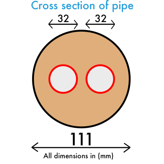

Post and beam Posted September 9, 2024 Posted September 9, 2024 I have seen 32mm pipe pairs in 125mm, 140mm and 160mm so far. For a relatively mild Hertfordshire installation is it necessary to go for the thickest insulation or is this overkill. Dont want to skimp on this element.

Post and beam Posted September 10, 2024 Author Posted September 10, 2024 (edited) On 09/09/2024 at 22:52, G and J said: How long a run are you looking at between the ASHP and the house? Expand 8 metres in a direct line so a little more than that to account for the Bends at each end to get up through the block & beam. Thats 8 metres to the manifold under the stairs. On 10/09/2024 at 06:34, JohnMo said: how big is your heat pump? Expand 7kW Vaillant Edited September 10, 2024 by Post and beam
JohnMo Posted September 10, 2024 Posted September 10, 2024 On 10/09/2024 at 07:56, Post and beam said: 7kW Vaillant Expand Sounds big pipe. I am doing about 16m each way to the 3 port valve and have used 28mm Hep2O, have it all in 25mm thick armaflex closed cell insulation, the underground parts is within 110mm flexible duct with the ends seals with stainless steel mesh and spray foam.
Post and beam Posted September 10, 2024 Author Posted September 10, 2024 What is the detrimental affect of too big a bore pipe, if any ?

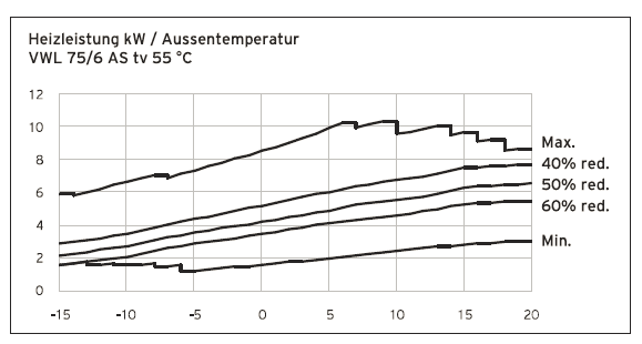

sharpener Posted September 10, 2024 Posted September 10, 2024 (edited) On 10/09/2024 at 12:19, JamesPa said: More heat loss because the water spends more time in the pipe Expand Right answer for the wrong reason! Assuming the flow temp is the same then the dwell time does not matter. The heat loss is more bc for a given delta T and insulation thickness (measured radially) there is more surface area to lose it through. 7kW Vaillant can put out 10kW under reasonable conditions so needs 28mm pipework. For 5C dT the rule of thumb says 22mm is good up to 6kW and 15mm up to 3. Edited September 10, 2024 by sharpener

sharpener Posted September 10, 2024 Posted September 10, 2024 Rate of heat loss (in kW) is what you need to worry about, it is quantifiable as additional cost. OTBE this will be proportional to exposed surface area. Hence smaller pipework better. Temp drop of water in pipe will be proportional to heat loss, and multiplied by vol flow rate in l/hr /860 will equal the heat loss in kW. So temp drop inversely prop to flow rate for a given heat loss. Not in itself important assuming it is small compared with dT across the HP. Not directly a measure of heat loss hence not a measure of avoidable cost. Volume of pipework is however dead volume which we can assume has to be heated to flow temp once per cycle and mostly lost when HP stops. This is a direct function of pipe size, small pipe is better.
