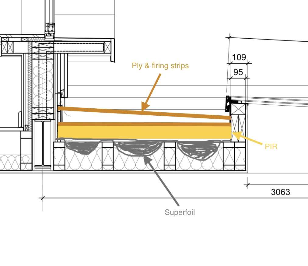

G and J Posted October 4, 2024 Share Posted October 4, 2024 1 hour ago, SBMS said: A 150mm upstand for skylight? As I understand it that’s the minimum for a rooflight. But your PIR depth isn’t governed by the height of your upstand. Your 150mm upstand is from the finished surface of the roof (ie above your insulation). I can move the skylight up to preserve the 150mm upstand around the skylight if I thicken the flat roof, what I can’t do is raise the parapet as that risks us contravening our planning permission. So I guess knowing how big the upstand (watertight layer to parapet) has to be helps me understand what I’ve got to work with. Link to comment Share on other sites More sharing options...
SBMS Posted October 5, 2024 Share Posted October 5, 2024 2 layers of superfoil on top of joists and 90mm PIR is 0.11 u value. You can reduce the PIR if you’re willing to accept a reduced u value. I think you’ll get that without having to modify your parapet wall. You might have to lift your roof light upstand a bit. That roof (like mine was) will be difficult to ventilate. I switched to a warm roof for this reason. Link to comment Share on other sites More sharing options...
G and J Posted October 5, 2024 Share Posted October 5, 2024 1 hour ago, SBMS said: 2 layers of superfoil on top of joists and 90mm PIR is 0.11 u value. You can reduce the PIR if you’re willing to accept a reduced u value. I think you’ll get that without having to modify your parapet wall. You might have to lift your roof light upstand a bit. That roof (like mine was) will be difficult to ventilate. I switched to a warm roof for this reason. I have looked at Superfoil. I’m guessing you mean the Superfoil laid directly onto the top of the joists, taped to be your airtight layer, then PIR on top, then ply, then furring strips, then ply, then EPDM? Link to comment Share on other sites More sharing options...
G and J Posted October 5, 2024 Share Posted October 5, 2024 4 minutes ago, G and J said: I have looked at Superfoil. I’m guessing you mean the Superfoil laid directly onto the top of the joists, taped to be your airtight layer, then PIR on top, then ply, then furring strips, then ply, then EPDM? Like this I mean…. Link to comment Share on other sites More sharing options...

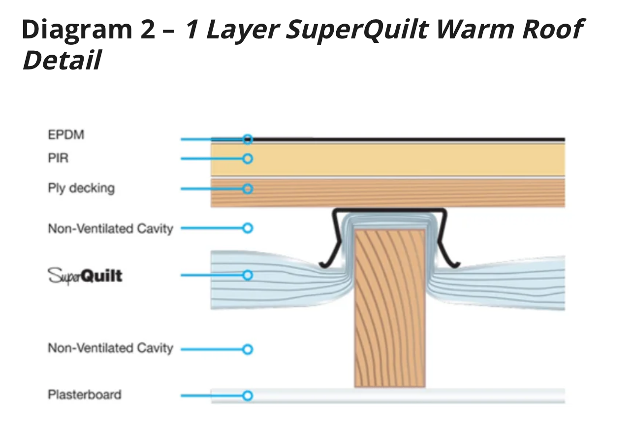

SBMS Posted October 5, 2024 Share Posted October 5, 2024 3 minutes ago, G and J said: Like this I mean…. Example roof makeup, no ventilated cavity needed, similar to your makeup diagram I think From https://ybsinsulation.com/wp-content/uploads/2022/03/SuperQuilt-Data-Sheet-V3-Feb-2019.pdf there’s also a detail with 4 layers of super foil between and over which hits 0.11. It indicated that a non ventilated cavity works on that as well which would mean your roof height wouldn’t change at all? Worth a chat to confirm with YBS that no ventilation is required? also superfoil acts as a vcl when taped. Link to comment Share on other sites More sharing options...
G and J Posted October 5, 2024 Share Posted October 5, 2024 22 minutes ago, SBMS said: Example roof makeup, no ventilated cavity needed, similar to your makeup diagram I think From https://ybsinsulation.com/wp-content/uploads/2022/03/SuperQuilt-Data-Sheet-V3-Feb-2019.pdf there’s also a detail with 4 layers of super foil between and over which hits 0.11. It indicated that a non ventilated cavity works on that as well which would mean your roof height wouldn’t change at all? Worth a chat to confirm with YBS that no ventilation is required? also superfoil acts as a vcl when taped. Ah I see, thank you. I can understand the ply to distribute the weight (of, in our case, a few pigeons and a very occasional window cleaner’s feet), but doesn’t that mean that the ply layer cannot breath at all? Does that matter? Also, are those clips standard things? I’ll be onto Superfoil on Monday (lucky Superfoil lol). Link to comment Share on other sites More sharing options...

JohnMo Posted October 5, 2024 Share Posted October 5, 2024 1 minute ago, G and J said: Also, are those clips standard things? Clip can be purchased from super foil, I didn't bother, as they would fit our fat joists. So just stapled onto the vertical face of each joist. On a big roof the clips would be better and quicker. Link to comment Share on other sites More sharing options...
SBMS Posted October 5, 2024 Share Posted October 5, 2024 4 minutes ago, G and J said: Ah I see, thank you. I can understand the ply to distribute the weight (of, in our case, a few pigeons and a very occasional window cleaner’s feet), but doesn’t that mean that the ply layer cannot breath at all? Does that matter? Also, are those clips standard things? I’ll be onto Superfoil on Monday (lucky Superfoil lol). I dont think the ply sub deck needs to breathe (or rather, is susceptible to condensation and therefore needs airflow to ventilate) because it’s on the warm side of the insulation. Link to comment Share on other sites More sharing options...
G and J Posted October 5, 2024 Share Posted October 5, 2024 6 minutes ago, JohnMo said: Clip can be purchased from super foil, I didn't bother, as they would fit our fat joists. So just stapled onto the vertical face of each joist. On a big roof the clips would be better and quicker. That sounds good. I’m not sure how thick the top chord of our posijoists will be, so that’s another bit of info on my info shopping list. I think Superfoil only needs 20mm unventilated airgap to achieve max. R value so that should be ok. We’re lucky it’s only a tiny area - 3m x 5m with about a third of that taken up by a skylight, so I won’t even need that many staples. Link to comment Share on other sites More sharing options...
G and J Posted October 5, 2024 Share Posted October 5, 2024 5 minutes ago, SBMS said: I dont think the ply sub deck needs to breathe (or rather, is susceptible to condensation and therefore needs airflow to ventilate) because it’s on the warm side of the insulation. So is this an example of the one third/two thirds rule? In which case I need a goodly bit of PIR to keep the ply warm. Which superfoil variant did you use? Link to comment Share on other sites More sharing options...
saveasteading Posted October 5, 2024 Share Posted October 5, 2024 I wouldn't use superfoil at all, let alone multiple layers. The figures are theoretical. It has to be loose. You show mineral insulation somehow placed around it. I might use it on a garden shed, but more likely would use bubblewrap. You are better off with filling the whole void with pir or mineral wool. 1 Link to comment Share on other sites More sharing options...
SBMS Posted October 5, 2024 Share Posted October 5, 2024 3 minutes ago, saveasteading said: I wouldn't use superfoil at all, let alone multiple layers. The figures are theoretical. It has to be loose. You show mineral insulation somehow placed around it. I might use it on a garden shed, but more likely would use bubblewrap. You are better off with filling the whole void with pir or mineral wool. Challenge here is ventilating a cold roof makeup? We found it difficult to detail with a parapet wall hence switched to warm roof. I’m not sure what you mean when you say the figures are theoretical? All figures are theoretical. Don’t think he’s planning on mineral wool in between rafters as well? I wouldn’t, Not needed to achieve u value and becomes a hybrid roof then Link to comment Share on other sites More sharing options...
G and J Posted October 5, 2024 Share Posted October 5, 2024 1 minute ago, saveasteading said: I wouldn't use superfoil at all, let alone multiple layers. The figures are theoretical. It has to be loose. You show mineral insulation somehow placed around it. I might use it on a garden shed, but more likely would use bubblewrap. You are better off with filling the whole void with pir or mineral wool. Hmmmmm. If the joists are only 202mm and I fill the void with mineral wool I’ll not get a good u value at all. The context is that we also have a large set of patio doors in that area, so I’m having a fret that that area will be the coldest bit of the house. Link to comment Share on other sites More sharing options...
saveasteading Posted October 5, 2024 Share Posted October 5, 2024 1 minute ago, G and J said: I’ll not get a good u value at all The foil figures are imaginary. Forget them. Pir above and wool in the gaps is good...what makes you think otherwise? The saving on superfoil will go a long way to your heating bill. Link to comment Share on other sites More sharing options...
G and J Posted October 5, 2024 Share Posted October 5, 2024 23 minutes ago, saveasteading said: The foil figures are imaginary. Forget them. Pir above and wool in the gaps is good...what makes you think otherwise? The saving on superfoil will go a long way to your heating bill. So build up from top would be…. EPDM Ply PIR (tapered to save the thickness of furring as it is only a small area. VCL - i.e. airtight layer Ply Posi-joists Mineral wool stuffed in everywhere I can get it inc. around MVHR ducts and plenums. And the theory is that as long as I get enough PIR on top without too much cold bridging then the VCL will stay warm enough to avoid any form of condensation. Am I close? Link to comment Share on other sites More sharing options...
Iceverge Posted October 5, 2024 Share Posted October 5, 2024 9 minutes ago, G and J said: So build up from top would be…. EPDM Ply PIR (tapered to save the thickness of furring as it is only a small area. VCL - i.e. airtight layer Ply Posi-joists Mineral wool stuffed in everywhere I can get it inc. around MVHR ducts and plenums. And the theory is that as long as I get enough PIR on top without too much cold bridging then the VCL will stay warm enough to avoid any form of condensation. Am I close? That'll be fine. Personally I would always prefer a ventilated gap above a drainage plane but what you've got will work. Link to comment Share on other sites More sharing options...
