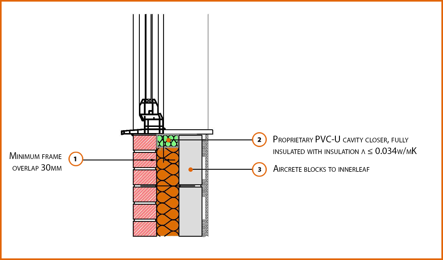

JohnMo Posted August 31, 2024 Share Posted August 31, 2024 2 hours ago, Oz07 said: Sorry i was just thinking of the effect on the door frame The example from the OP is a twin skin block and brick with insulated cavity. The external skin is isolated from the building by cavity insulation first, any openings in the cavity are blocked off with cavity closers. Windows and doors straddle the insulation, so as not to compromise or generate a new thermal bridge. Example Link to comment Share on other sites More sharing options...
SBMS Posted September 1, 2024 Author Share Posted September 1, 2024 23 hours ago, JohnMo said: The example from the OP is a twin skin block and brick with insulated cavity. The external skin is isolated from the building by cavity insulation first, any openings in the cavity are blocked off with cavity closers. Windows and doors straddle the insulation, so as not to compromise or generate a new thermal bridge. Example @JohnMo this detail would be okay for non ground floor.. but on ground floor there won’t be cavity insulation under the door.. with a 200mm cavity and potentially a 160mm door track, what’s supporting the track over the cavity? Would you recommend a structural cavity closer? Or take the floor insulation and screed to the outer brick skin (dropping the inner block a course or so)? Is PIR and screed enough to carry the weight of the doors? Link to comment Share on other sites More sharing options...
