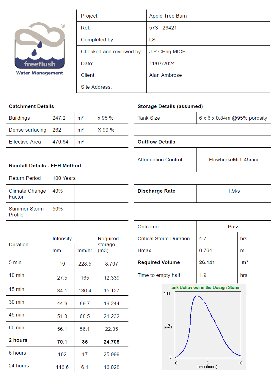

Alan Ambrose Posted August 22, 2024 Posted August 22, 2024 (edited) Well this is topical as I'm hoping to put most of my surface water drainage to bed today. I'll add to the thread if the OP is willing as it's on topic. >>> 27 cube ! Is it for a block of 25 flats ? Thats mad, so your 'SE' is saying you need 27 thousand litres of storage to catch the water that used to fall on the footprint of your building ? The 'SE', as you put it, is a fairly well known firm of SEs. I suspect that many SEs use an external web service anyway as it's a specialised calc. Of course, to be able to compare houses & attenuation tanks you need to know the catchment areas (roof & hard surfaces e.g. driveway), the ground conditions & the allowed nozzle rate. The location, and therefore storm rates, will make some difference too. I'm on clay with an apparent high GW level so similar to @SBMS. I thought my SE's number sounded high and I was interested in how it was calculated, so I had another calc done by Freeflush (dumb name I think) for £100. I should say that I am very inquisitive and interested in how everything works and am treating the house build as a big learning exercise. I was also looking for clues in order to modify the SE's proposed design a little. I supplied the roof and drive areas and the location, Freeflush did the rest. As it happens I also had the FEH13 & 22 numbers from WHS which I puchased for £7. Freeflush came up with 26 m^3 and used the FEH13 numbers - so very similar to the SE. The FEH22 numbers will be a little different. Freeflush's calc sheet below and I've also added the FEH13 numbers from WHS for anyone who is curious. The big result I got back was that both the SE and Freeflush had treated the permeable driveway and patio as impermeable as @SBMS suggested above. @SBMS - do you have your areas for comparison? It would be good to bottom out why we have such different attenuation volumes. FEH_Point_Rainfall_FEH13_AM (anonymised).xlsx Edited August 22, 2024 by Alan Ambrose 1
saveasteading Posted August 22, 2024 Posted August 22, 2024 13 minutes ago, Alan Ambrose said: treated the permeable driveway and patio as impermeable That may be reasonable in that the stored volume of water will not permeate thriugh your clay at any useful rate. Ie critical storms these days are very heavy downpours, but tne soakaway amount will remain slow.
Alan Ambrose Posted August 22, 2024 Posted August 22, 2024 @saveasteading - yep, that sounds a reasonable assumption. @Dave Jones >>> so flow can be top or bottom to suit. So, you think this detail into crates will work OK? I'm concerned about the inlet pipe getting backed up as the tank fills and causing the inlet flow rate to diminish a lot.

SBMS Posted August 22, 2024 Author Posted August 22, 2024 (edited) 10 hours ago, Alan Ambrose said: do you have your areas for comparison? @Alan Ambrose, our ground floor sqm footprint is 206m2 (garage + ground floor). My basic maths: my 206m2 / your 470m2 = 43%. So of your 24.7m3 storage would be around 43% at 10.6m3. Then there's the discharge rate - mine is 2.6l/s whereas yours is 1.9l/s. my 2.6 / your 1.9m2 = about 136%. So that 10.6m3 is about 7.8m3. I'm not sure why the figures I've tried to normalise above are still double when removing the 'permeable' area, and adjusting for the lower discharge rate.. However I suspect that the simulation isn't linear (i.e. half the sqm doesn't yield half the required attenuation) and is possibly more like an exponential curve... someone smarter than me can answer that? What I would say is counting your permeable areas as impermeable seems up for debate and might drastically reduce your storage requirements. Secondly - how did they calculate your discharge rate? Our site is currently brownfield and they adjusted it 'up' as if it was greenfield (so there is a betterment), but still theres a 30% difference.. maybe one to investigate? And finally, the great irony in all this, is that currently, every single bit of our site - where the house is going, the driveway and our garden - totally 1500sqm - is currently a thick concrete slab (brownfield, former piggery and stores) with some rudimentary drainage discharging to the local beck about 160m away. The site never floods, and neither does the beck, so anything we do - probably even without attenuation - might be entirely unnecessary?? Edited August 22, 2024 by SBMS

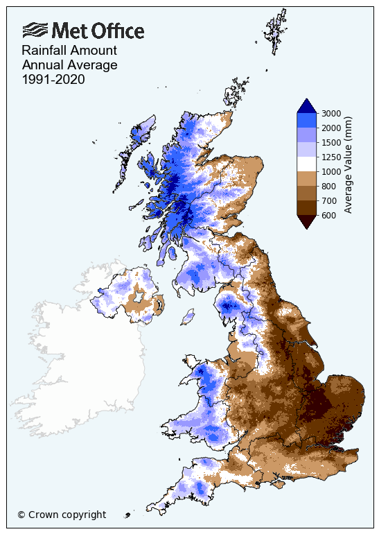

saveasteading Posted August 22, 2024 Posted August 22, 2024 It depends on rainfall rates as well. This is not related to annual rainfall. For example SE England gets occasional very intense storms, hence flooding in London, Tunbridge Wells and Hastings recently. Allow 0.022 litres/ second/m2 for London but just 0.016 along the more consistently wetter west coast. 2 hours ago, SBMS said: The site never floods, The point of the retention is to protect downstream. eg The Glastonbury Levels get flooded because water reaches there so quickly form the catchment area. Development. and farmers ploughing downhill. and streams being cleared cause the same rain to flow faster to one place. A particular location may have local rainfall effects but the map used is more general with rainfall isopleths, one of my favourite words. I would cut and paste the chart, but the new 'improved' Windows 11 doesn't seem to have a 'snip' function. 1
Alan Ambrose Posted August 24, 2024 Posted August 24, 2024 (edited) >>> It depends on rainfall rates as well. >>> isopleths ooo, errr Here's the overall rainfall map and a 'storm map' I found in here: https://www.sciencedirect.com/science/article/pii/S2212094721000372. If I've understood correctly, in the 2nd map the East of UK gets v. few 50mm storms compared with the West. Edited August 24, 2024 by Alan Ambrose 1
