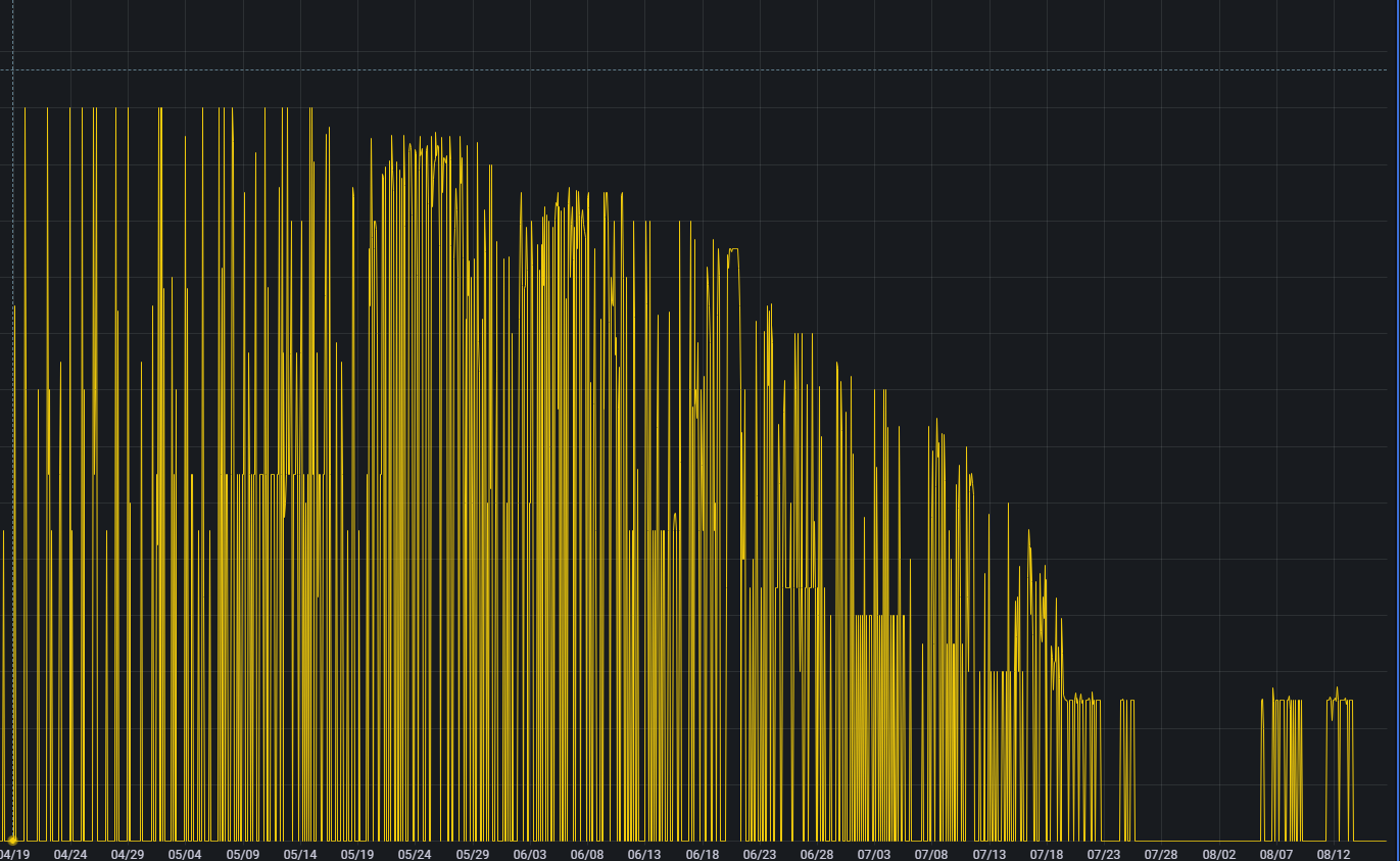

Using the controller "commissioning wizard" I see the flow rate was flickering on and off at 5l/min, which is about the lowest value it can sense.
Looking back through grafana, I see prior to May it would peak at about 12l/min but then steadily declined month on month until the errors started.

Looks like steady decline in flow rate, for both the high and low peaks - do you have zones switched off, or heating fluid getting more viscous?

Hmmm well 10 weeks running it with the flow sensor disabled it seems to be performing just fine, so I'm still inclined to think it's a sensor failure. Ideally I'd borrow a replacement to test - they're not cheap, and a bit of a pain to get hold of.  I only really need it to get more accurate energy delivery estimates from the controller.

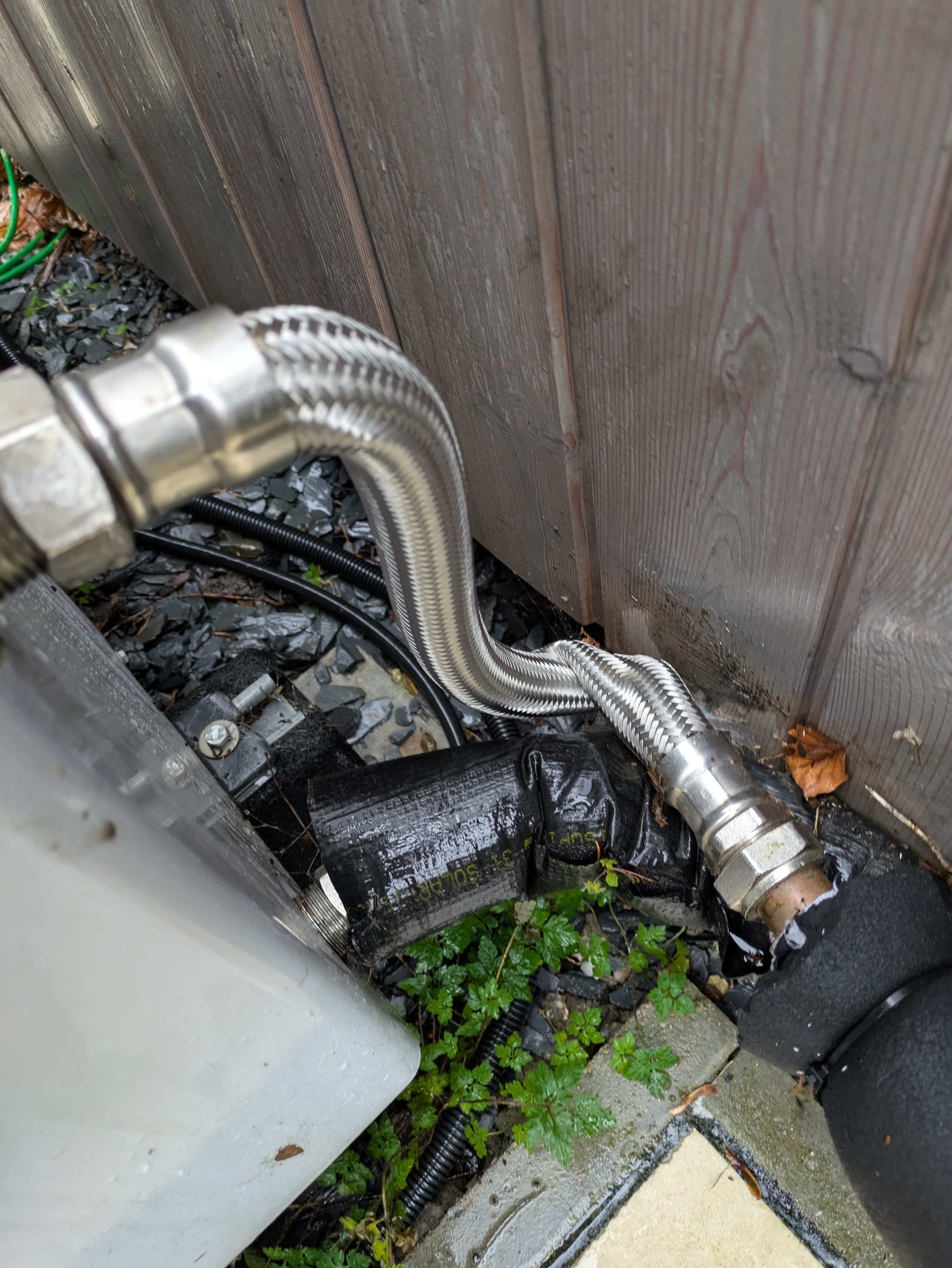

Finally got some real progress on this. I decided to check the flexi pipes again, and after removing the insulation jacket discovered this
It was incredible how hidden this was under the insulation. The fact the flow decreased over time suggests it was slowly twisting itself into this shape, and May - Aug is cooling season so perhaps these flexi pipes are more prone to doing this when cooling rather than heating. (I think the issue was introduced when I had anti-freeze valves installed the year before).
Disconnecting the pipes from the outdoor unit and running mains water through the circuit, the (existing) flow sensor started reading 1-2V (so 10-30 l/min) again, but with the flexis connected to it (open to air far end) it would stay stuck at 0.3V which seems it's base output for flow rate below its minimum sensitivity.
So The existing hose seems permanently kinked, doesn't  seem like it can be salvaged.
That can’t happen can it? Seems utterly bizarre.
@Russdl thanks! And yes, utterly bizarre.
All I can think is the compression joint to the 28mm was not quite tight enough so over a number of expansion and contraction cycles it was pushing against it and managed to rotate on it, a bit like a ratchet.
The fact I do DHW reheat and space cooling on higher outputs during cheap over night electric (and this happened exactly in cooling season, starting May) perhaps compounding it.
It must have had a pretty bad kink to start and then this just collapsed it.
The other thing I noticed is the pipe seems to have lost a lot of its "flex", almost like it has perished and seized up a bit

I definitely wouldn't have the Flexi on a curve, they definitely aren't like hydraulic hoses, so more likely to collapse over time.

I would strongly suspect the tight curve on the flexible hoses and the tube inside collapsing. The angle changes need to be taken up with solid elbows, the flexible is there to absorb vibration and noise transfer, not really to change direction.
