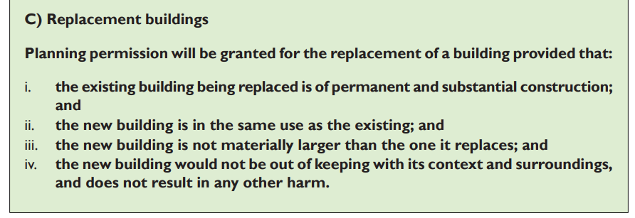

IanR Posted August 14, 2024 Share Posted August 14, 2024 (edited) If there has been a continued use, then it may be worth a conversation with the LPA, as you are not at risk of losing the rights to that Use. Your LPA may have a Policy in their Adopted Local plan, that gives more information on how they may would approach it. You'd be searching for something like "replacement buildings in the countryside/green belt". My LPA's policy is as follows: This gives a little more flexibility than a like for like replacement. Personally, if I was replacing like-for-like I wouldn't approach the LPA, knowing that if someone did complain I could put in a retrospective that would be approved. If I was going to rebuild materially different, I'd probably apply for planning. Difficult to advise, my LPA has, over the last few years, made it more and more difficult to talk to anyone. To do similar I'd have to submit a pre-planning advice, just to speak with someone, then submit a planning app if they said it was needed. Hence if you are confident it would get approved, just get on and do it and wait for them to contact you. The closer you are to the original, the less reasons you give them for a rejection. Edited August 14, 2024 by IanR 1 Link to comment Share on other sites More sharing options...

willow171 Posted August 14, 2024 Author Share Posted August 14, 2024 21 minutes ago, IanR said: If there has been a continued use, then it may be worth a conversation with the LPA, as you are not at risk of losing the rights to that Use. Your LPA may have a Policy in their Adopted Local plan, that gives more information on how they may would approach it. You'd be searching for something like "replacement buildings in the countryside/green belt". My LPA's policy is as follows: This gives a little more flexibility than a like for like replacement. Personally, if I was replacing like-for-like I wouldn't approach the LPA, knowing that if someone did complain I could put in a retrospective that would be approved. If I was going to rebuild materially different, I'd probably apply for planning. Difficult to advise, my LPA has, over the last few years, made it more and more difficult to talk to anyone. To do similar I'd have to submit a pre-planning advice, just to speak with someone, then submit a planning app if they said it was needed. Hence if you are confident it would get approved, just get on and do it and wait for them to contact you. The closer you are to the original, the less reasons you give them for a rejection. Thank you, I will have a look for the LPA policy. Link to comment Share on other sites More sharing options...
