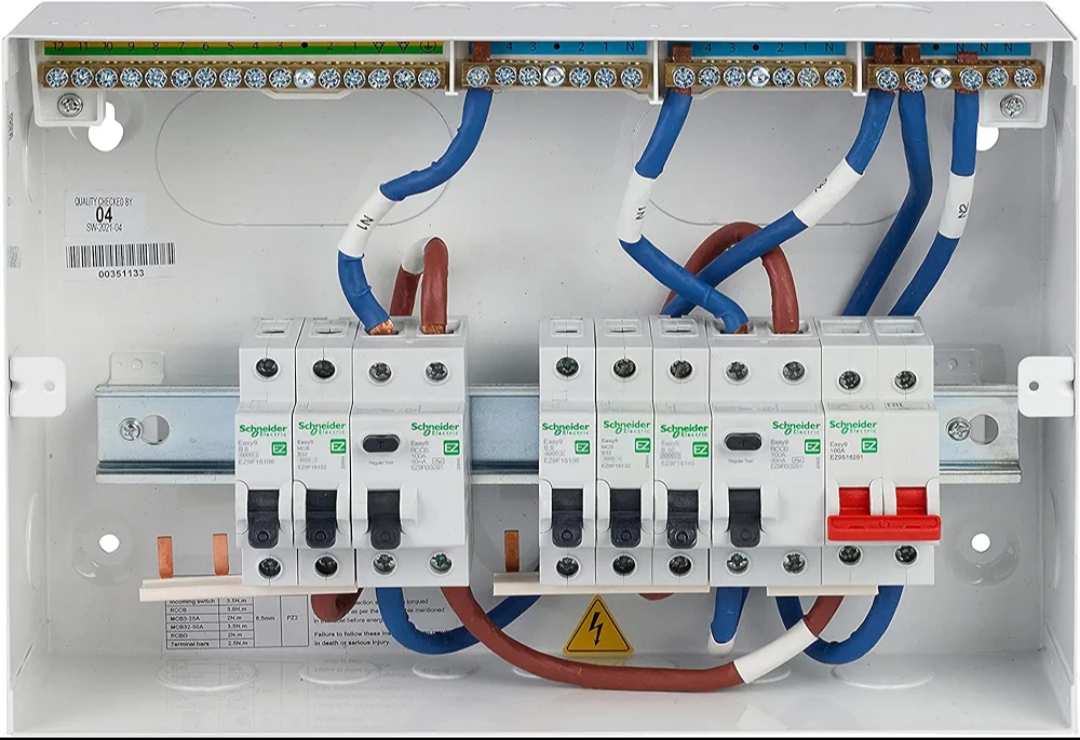

Onoff Posted August 12, 2024 Share Posted August 12, 2024 Guessing maybe you have a new board something like this? On the far right is the double pole isolator switch. Next is an RCD that provides earth leakage protection fed from the 3 MCBs next to it. Further to the left another RCD protecting 2 MCBs / circuits. See the three neutral bars at the top? There should be no links between them. Furthermore, the incoming circuit cabling: If you have two circuits fed from the two MCBs on the left, the circuits neutral wires should go to the far left neutral bar. Anything fed from the 3 MCBs, then those circuits neutral wires should go to the central neutral bar. 1 Link to comment Share on other sites More sharing options...

Onoff Posted August 12, 2024 Share Posted August 12, 2024 So on that board you have the orange surge protector, aka SPD on the far right. Then the double pole isolator. To the left is an MCB that is there likely just for the SPD. To the left of that a line of RCBOs. Inside it'll look something like this. Each RCBO should feed a separate circuit. Generally the twin and earth cable comes in at the top on each RCBO. Neutral on the left, line (live) on the right. In the case of a ring main you'll have two neutrals on the left, two lives on the right (sometimes 3 in each) There is just one neutral bar. Each RCBO has a blue fly lead that goes to the neutral bar. All the earths (aka CPCs) go to the earth bar. Check as aforementioned the neutrals on top are in the correct RCBO. Link to comment Share on other sites More sharing options...

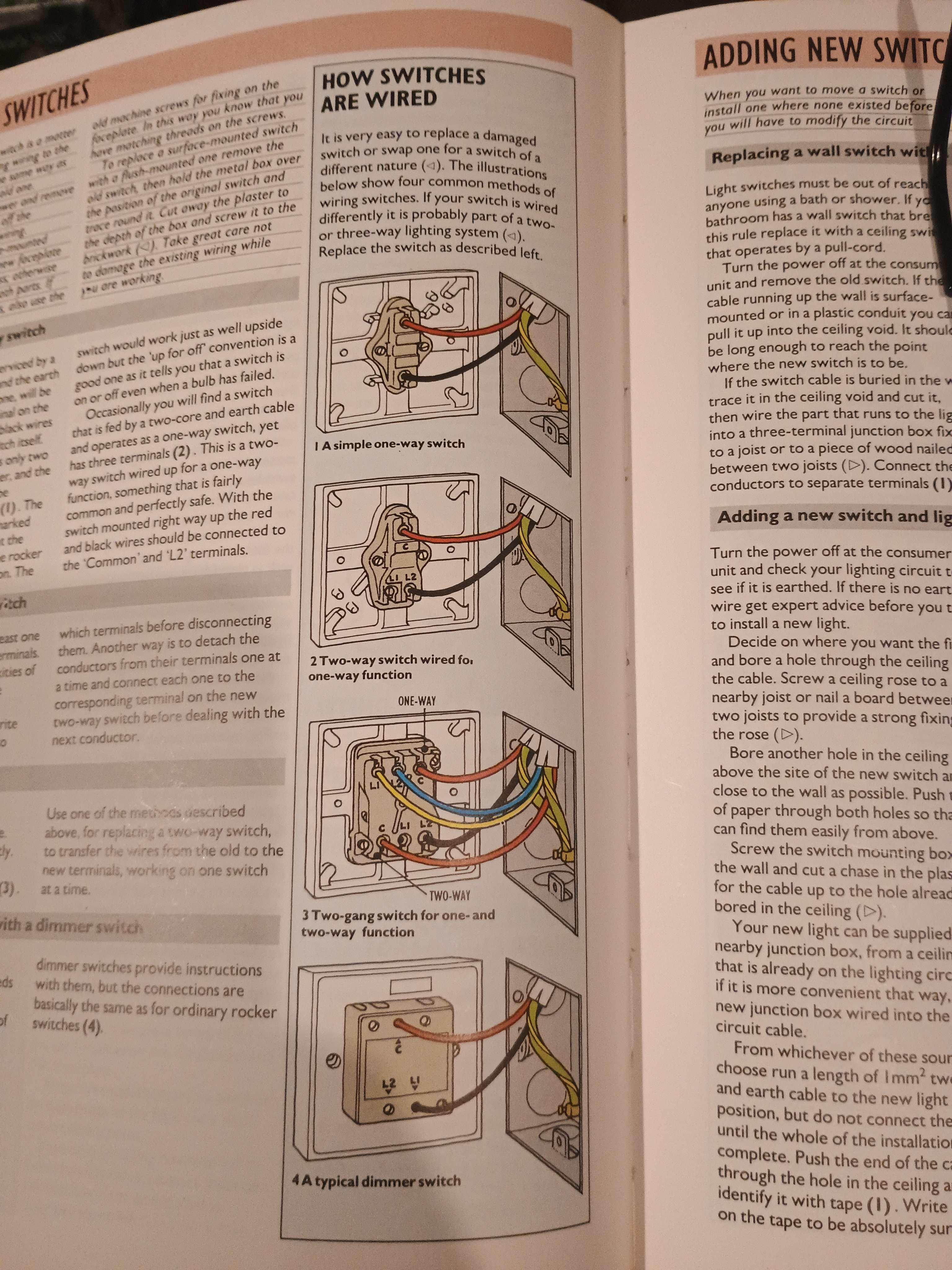

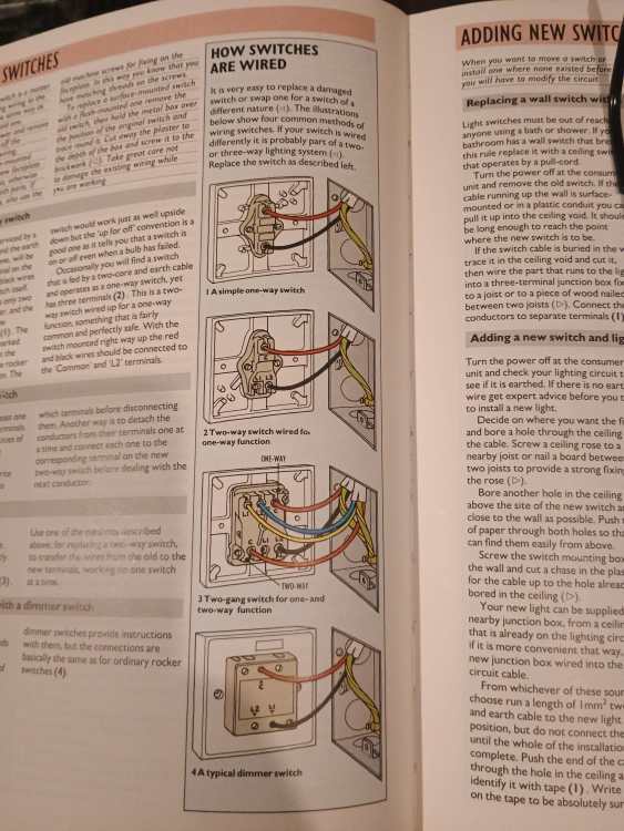

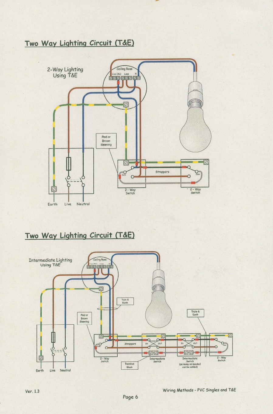

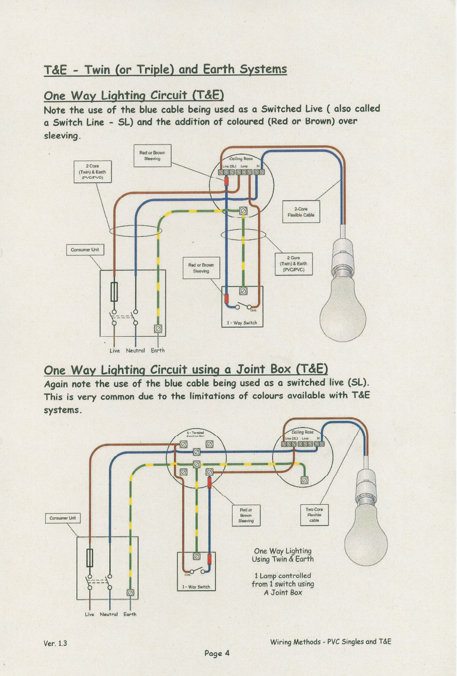

Onoff Posted August 12, 2024 Share Posted August 12, 2024 (edited) I think you'll find some of what you think are neutrals are in fact black, switched lives (that should have red sleeving on them). Only old book I could find with light switches in the old colours: Edited August 12, 2024 by Onoff Link to comment Share on other sites More sharing options...

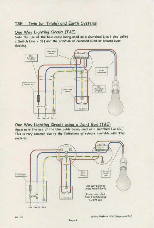

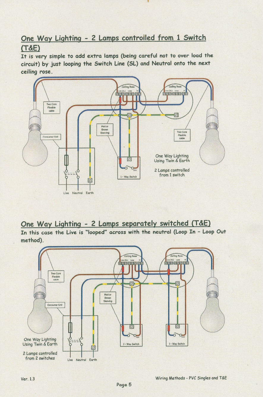

Onoff Posted August 12, 2024 Share Posted August 12, 2024 Traditional light switch wiring in new colours: Then you've intermediate switch wiring and loop at switch wiring where there's a neutral block in the back box. https://flameport.com/electric/lighting_circuits/lighting_loop_at_switch.cs4 Link to comment Share on other sites More sharing options...
