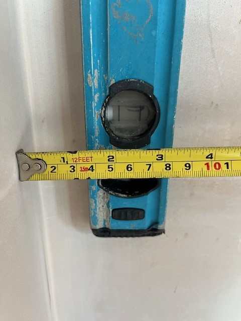

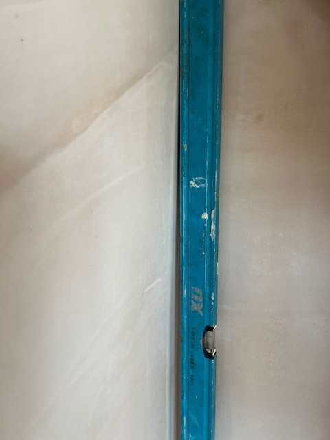

Willl Posted August 8 Share Posted August 8 Hi, looking for some opinion please and hope I am posting this in the right place. We have recently had a loft conversion and two of the walls where an old wall meets a new wall are not very flat. As (hopefully) shown in the attached photos. If I hold a 6ft long spirit level against the top of the wall, the gap at the bottom of the spirit level measures more than 3cm! Where the old wall and the new wall meet are clearly visible. There are also places on other walls were plasterboard joints and tape are showing (though I understand that this should be able to be 'got over' via filling and sanding..?) The loft company have told me there is nothing they can do now. I would appreciate opinions on if this is acceptable, how it could be tackled / rectified and how I should approach this. Many thanks in advance! Will Link to comment Share on other sites More sharing options...

Marvin Posted August 8 Share Posted August 8 the bubble on the spirit level suggests the wall is even more out of plumb than that! Link to comment Share on other sites More sharing options...
twice round the block Posted August 8 Share Posted August 8 You need to use a plumb line and not a spirit level to show how out of square it is, if you go down the legal route also employ a building surveyor. Link to comment Share on other sites More sharing options...

Willl Posted August 8 Author Share Posted August 8 Thanks all - points taken on board and to address a couple - The way the loft company have their business set up, their money is in the deposit you pay and you then pay the trades they arrange to do the job. This obviously leaves the customer with limited leverage! I've had a few things that I've had to push with them to get sorted and just trying to decide how much to challenge them on this.. As well as the wall not being level, I am worried the line between the old and new wall will be clearly visible after decorating and not able to be hidden by filling and sanding / feathering.. Can anyone advise what would need to be done to improve the situation / make more level? Thanks, Will Link to comment Share on other sites More sharing options...
