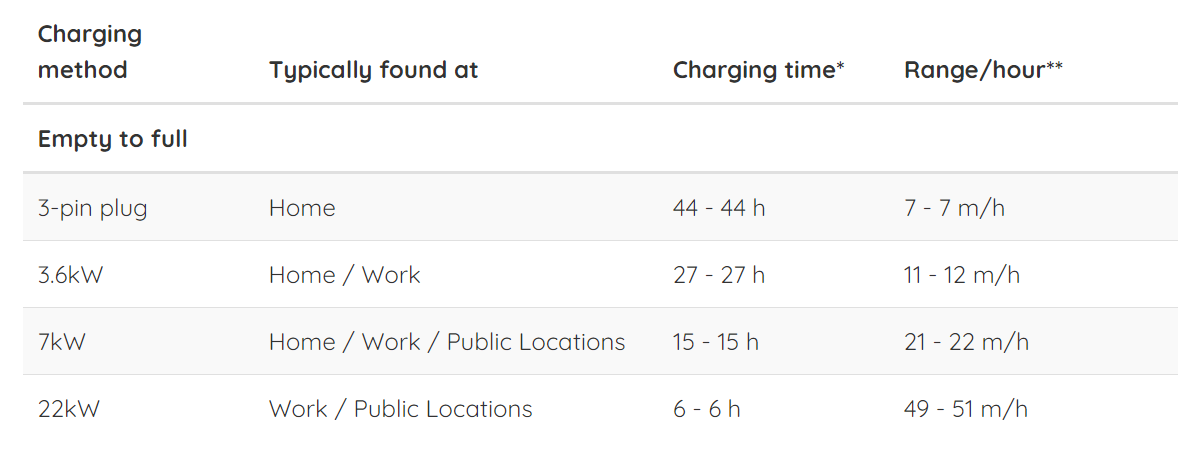

IanR Posted September 1, 2024 Share Posted September 1, 2024 3 hours ago, JohnMo said: Even if you did charge both cars every night and you did a 1000 miles in each car, every month, the charge time each night (for each car) would be 0.8hrs using an 11kW charger assuming the car is doing around 3.5kWh per mile. I've not come across 11kW single phase charging. Are there chargers that offer in the UK? Using a Tesla Model X as an example, just because it has 22kW charging capability and a 100kWh battery. It's 15 hours to charge from 0% - 100% @ 7kW and 6 hours @ 22kW 100kWh battery size is recognised in the industry as the base size that family cars need to get to be considered equivalent to ICE cars for range. Cost and battery technology are stopping this from being the case at the moment, but battery technology is changing relatively quickly. We're 5-10 years away from 100kWh batteries starting to become the norm for family sized cars. For the medium size van owner, that keeps their van on the drive, expects to carry 1 tonne in the back and occasionally tow a couple of tonne, their battery size will need to be +200kWh. The next generation of medium van EVs will be coming out before 2030 with up to 150kWh batteries followed up post-2030 with +200kWh batteries. If you are putting a new power connection in now, and it doesn't cost that much more for 3 phase, it's worth protecting for 22kW and multiple 7kW charging. Link to comment Share on other sites More sharing options...
JohnMo Posted September 1, 2024 Share Posted September 1, 2024 6 minutes ago, IanR said: I've not come across 11kW single phase charging. Are there chargers that offer in the UK? Using a Tesla Model X as an example, just because it has 22kW charging capability and a 100kWh battery. It's 15 hours to charge from 0% - 100% @ 7kW and 6 hours @ 22kW 100kWh battery size is recognised in the industry as the base size that family cars need to get to be considered equivalent to ICE cars for range. Cost and battery technology are stopping this from being the case at the moment, but battery technology is changing relatively quickly. We're 5-10 years away from 100kWh batteries starting to become the norm for family sized cars. For the medium size van owner, that keeps their van on the drive, expects to carry 1 tonne in the back and occasionally tow a couple of tonne, their battery size will need to be +200kWh. The next generation of medium van EVs will be coming out before 2030 with up to 150kWh batteries followed up post-2030 with +200kWh batteries. If you are putting a new power connection in now, and it doesn't cost that much more for 3 phase, it's worth protecting for 22kW and multiple 7kW charging. Think you have missed my point. If you are charging every day you are not fully charging the battery every time. It's little and often. If everyone has 200kWh batteries bang goes the time of use tariffs as well, because peak time becomes night time - premium rate, so we don't get grid collapse. Link to comment Share on other sites More sharing options...
