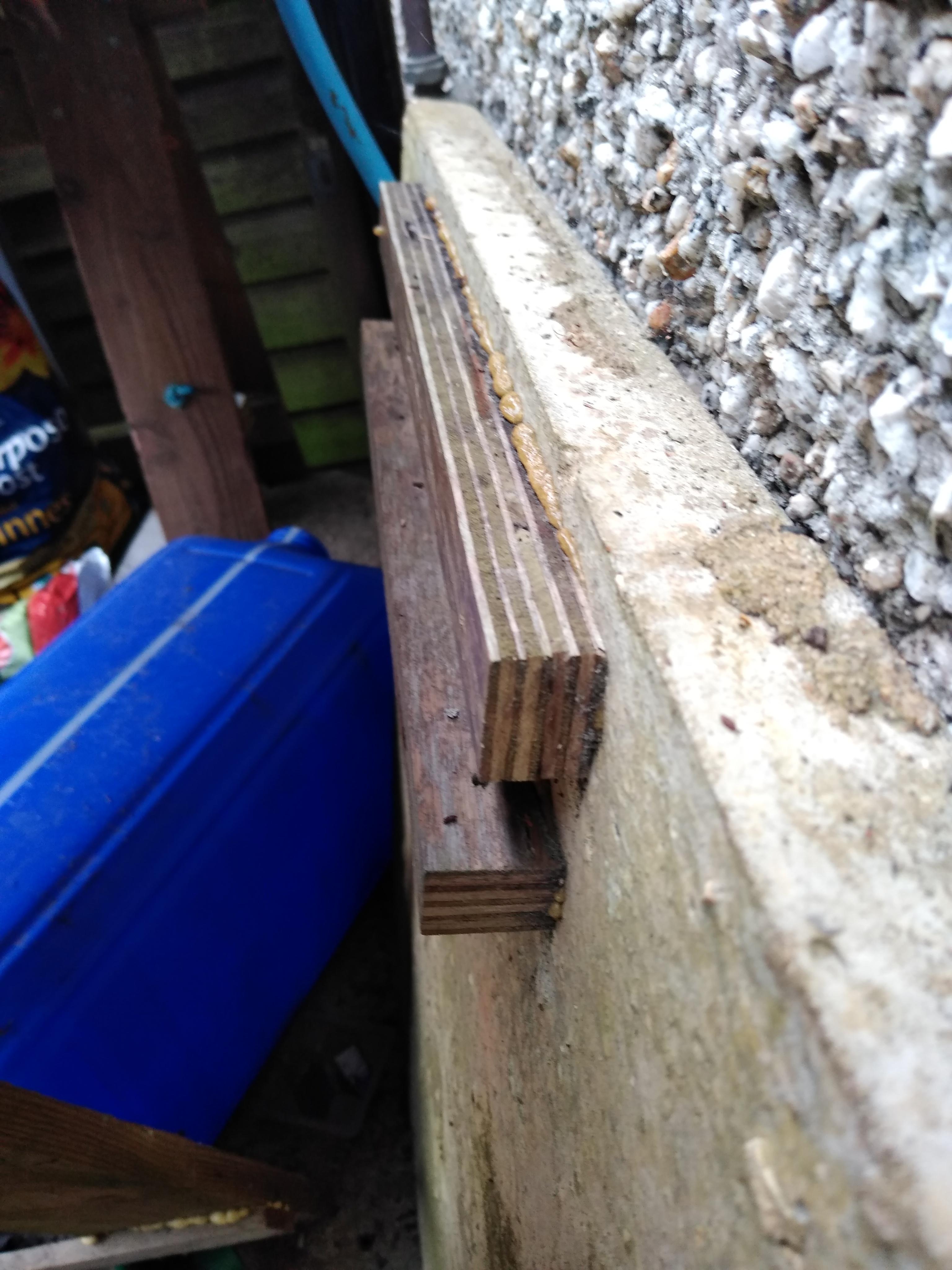

SteamyTea Posted August 1, 2024 Share Posted August 1, 2024 Been to the woods, seems the new owners of the cafe have changed the benches. But no matter, here is a picture of some ply stuck to a slab that has been out in all weather for over a year. I wiggled it and it did not come off. I am sure a tube of Lumberjack will sort you out. Link to comment Share on other sites More sharing options...
