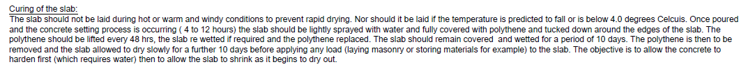

@SteamyTea The secondary reinforcement is primarily intended to deal with the behavoir of the concrete during the curing and drying out process.
It is a bit of a guess but if you look after your concrete for say a month after it's poured you can do a lot to help yourself in terms of getting what you have paid for. Quality of workmanship is key.
I've copied below a bit out of one of my specifications that I wrote for a self builder for a floor slab. The idea of this is to provide simple instructions for what you can do on site to address what is a very complex problem.

From the above you can see that this is fraught with liability if you are say an SE / designer like me. My PI insurer goes nuts and wants to know exactly how much liability I'm taking on. @Alan Ambrose article deals with Eurocode design which if applied well results in lean and cost effective design.. but it is predicated on all the Contractors etc doing their bit very well.. the construction industry in the Uk is not often up to this standard. So when it goes wrong I'm for example the first easy target.
Now folks if want to pay me for taking on that liability then I'm fine with that.. but the only way I can do that is if I come to site often to make sure that the contractor is doing "EXACTLY WHAT I REQUIRE" no if's or buts!
However while that sounds great you will need to pay for an experienced contractor who is used to having someone like me holding thier feet to the fire.
Self building is about finding the right compromise.
