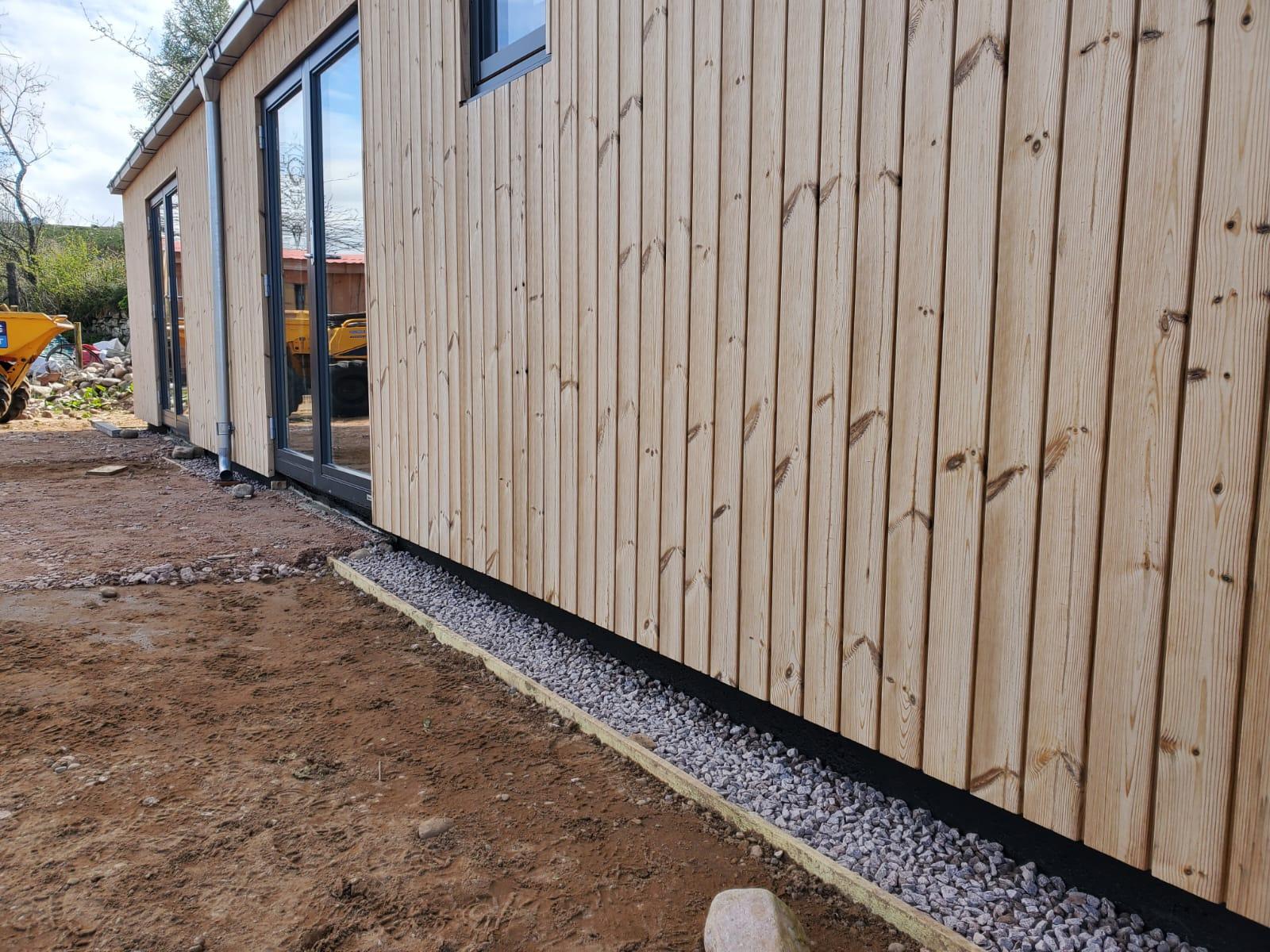

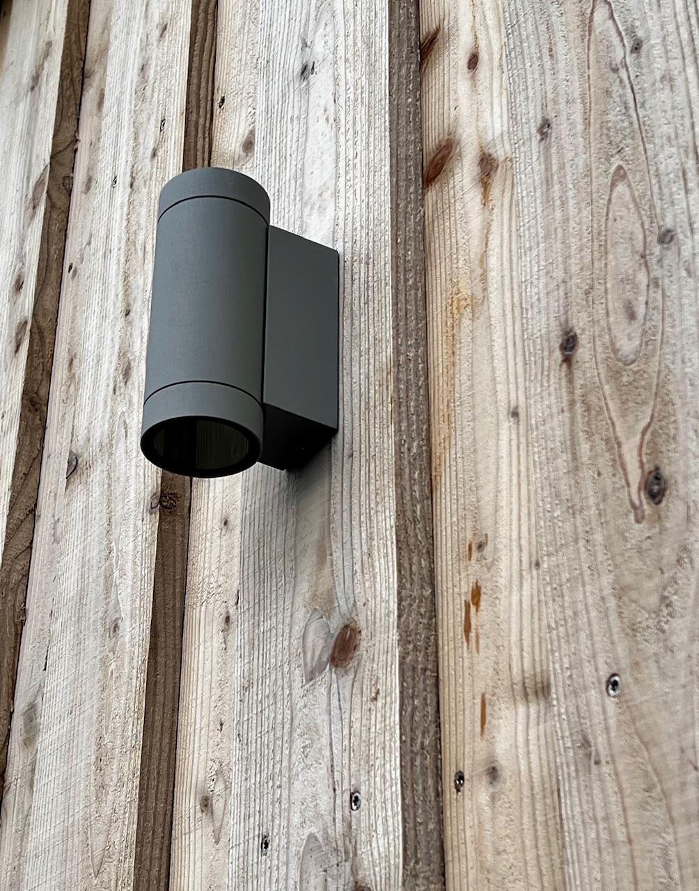

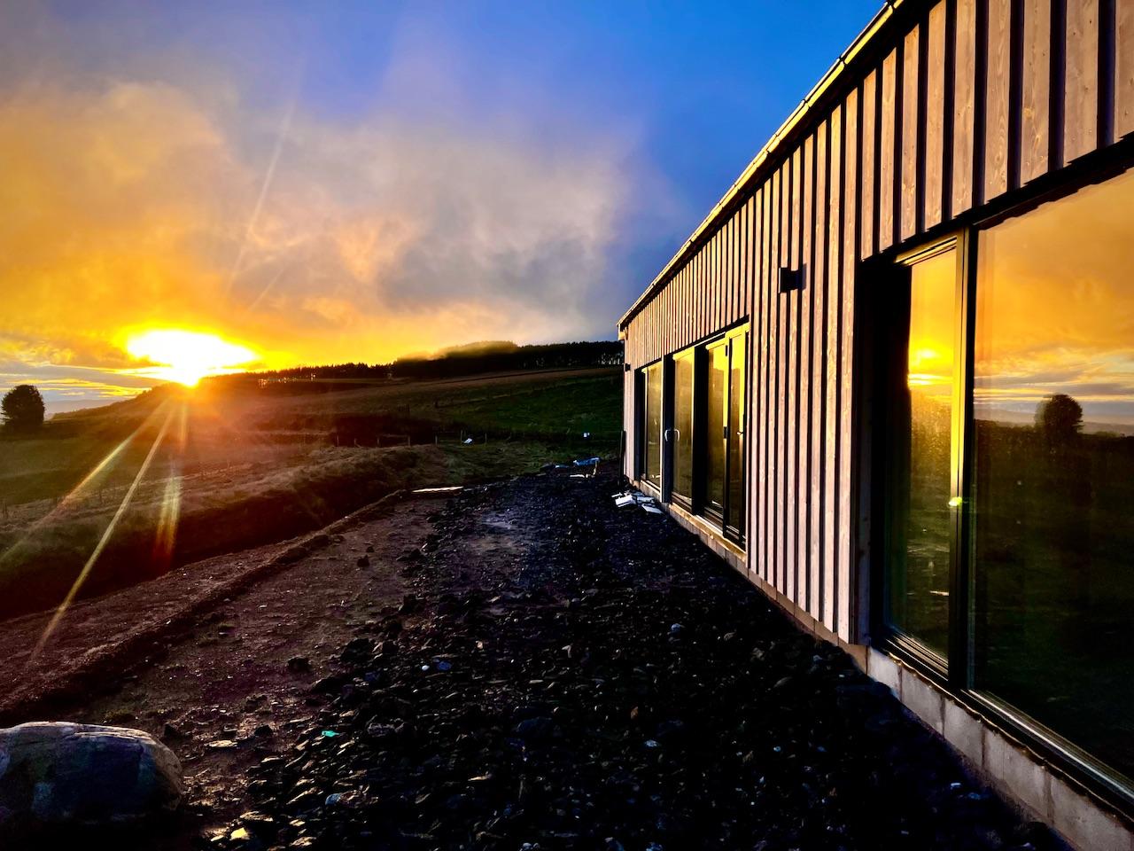

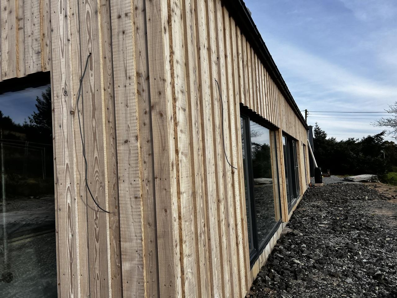

Kelvin Posted July 26, 2024 Posted July 26, 2024 These are from 6-9 months ago. It’s lightened since then. I’ll add another picture tomorrow. Fortunately Board on Board was the profile we wanted. We’ve not done the decking yet. The thermopine decking is lovely and it does go a darkish silver. 1

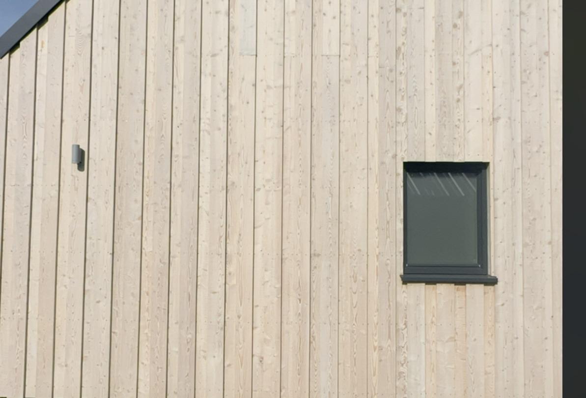

Kelvin Posted July 28, 2024 Posted July 28, 2024 Here’s a picture from a few minutes ago. This was the first elevation we did so it’s been on for 12 months and is more or less the final colour which is a honey very light golden colour. You can see how significantly different it is from the other pictures.
Dave Jones Posted July 28, 2024 Posted July 28, 2024 look a lot better with some oak sikkens cetol on it.
Kelvin Posted July 28, 2024 Posted July 28, 2024 It’s treated with a different product that doesn’t require any wood stain treatment ever. It’s exactly how we wanted the house to look especially that it’s completely uniform regardless of elevation or under the eaves/windows. The colour is the thing passers by comment on the most.
G and J Posted July 28, 2024 Author Posted July 28, 2024 1 hour ago, Kelvin said: We’ll be going up to Russwood in a few weeks so shall take pictures of all their decked areas. Be less anti knots 😂 Will be interested in what you find..........Russwood is about 11 hour drive so will go at some point but.......didn't realise we almost drove past the door on the way home from a scottish campervan trip in May 1 hour ago, Kelvin said: Here’s a picture from a few minutes ago. Stunning......if we could have that profile would be a done deal!

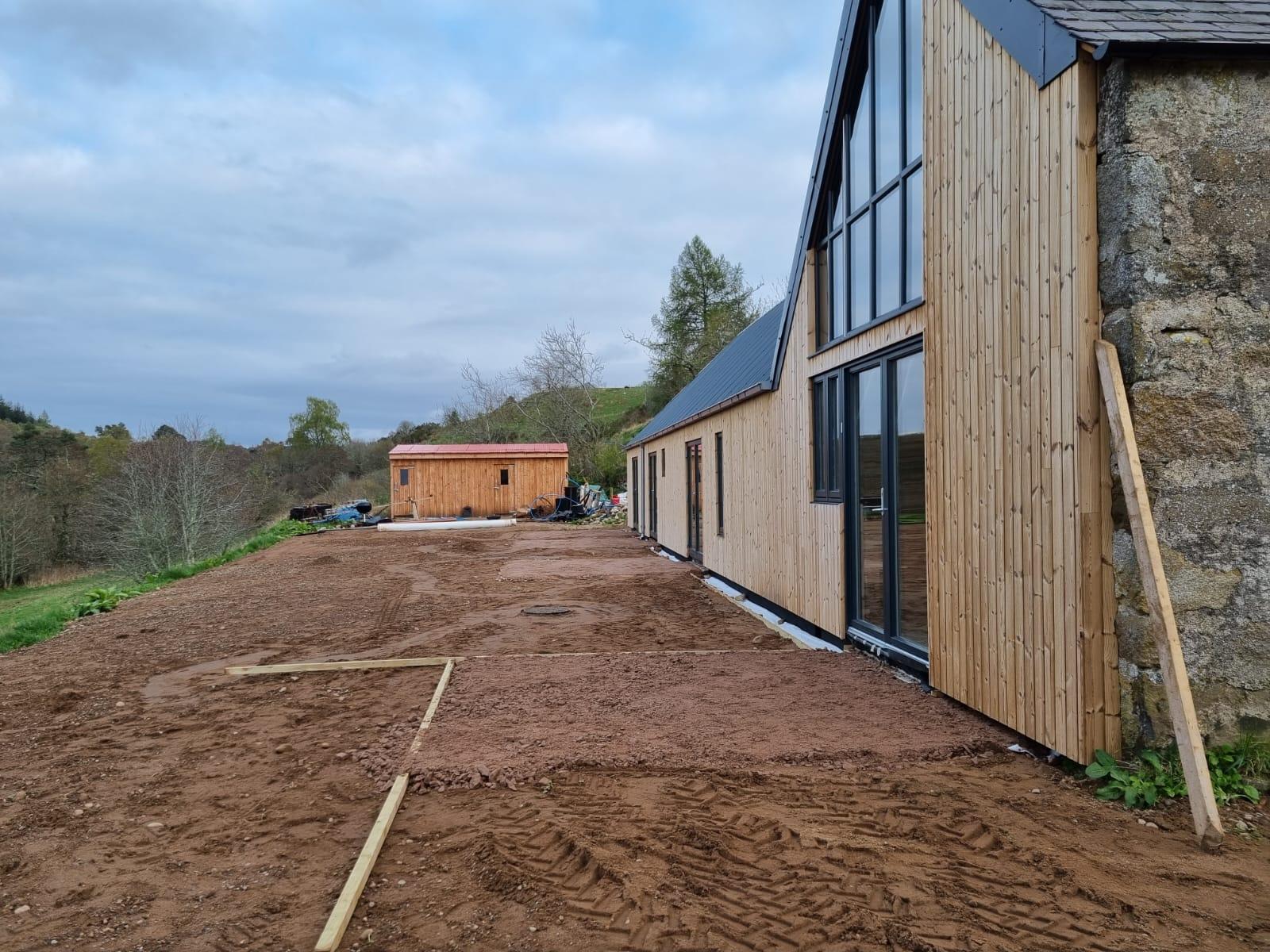

saveasteading Posted July 28, 2024 Posted July 28, 2024 And more russwood. This is about 6 montgs after fitting and rhe fading has commenced. The shed behind is in normal softwood.
G and J Posted July 28, 2024 Author Posted July 28, 2024 28 minutes ago, saveasteading said: And more russwood. This is about 6 montgs after fitting and rhe fading has commenced. The shed behind is in normal softwood. Can tell difference.......was the larch sioox treated? If not would be interested to see how weathering differs from @Kelvin in a few months...........ideally we would not sioox but the nature of the plot (ie not open) means the north (1.5 m from neighbour/ south (1m gap) sides will not get the exposure of the west/east......minimal windows on north/south and cladding only on first floor/render beneath but.....
