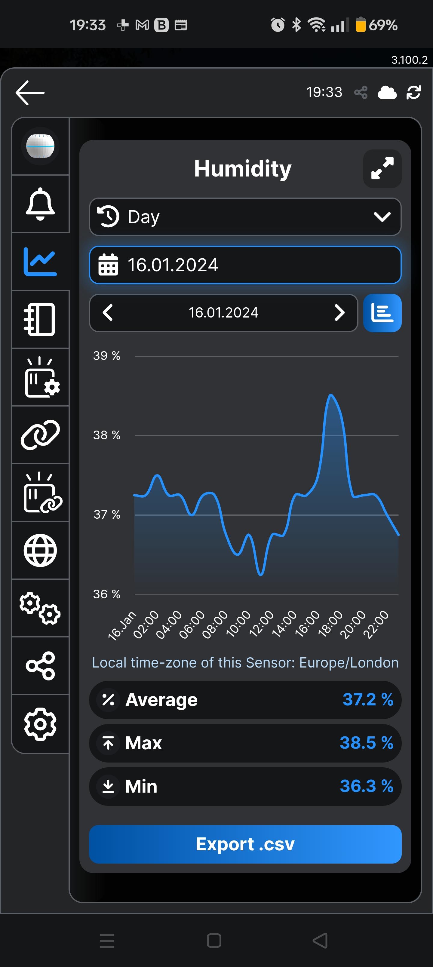

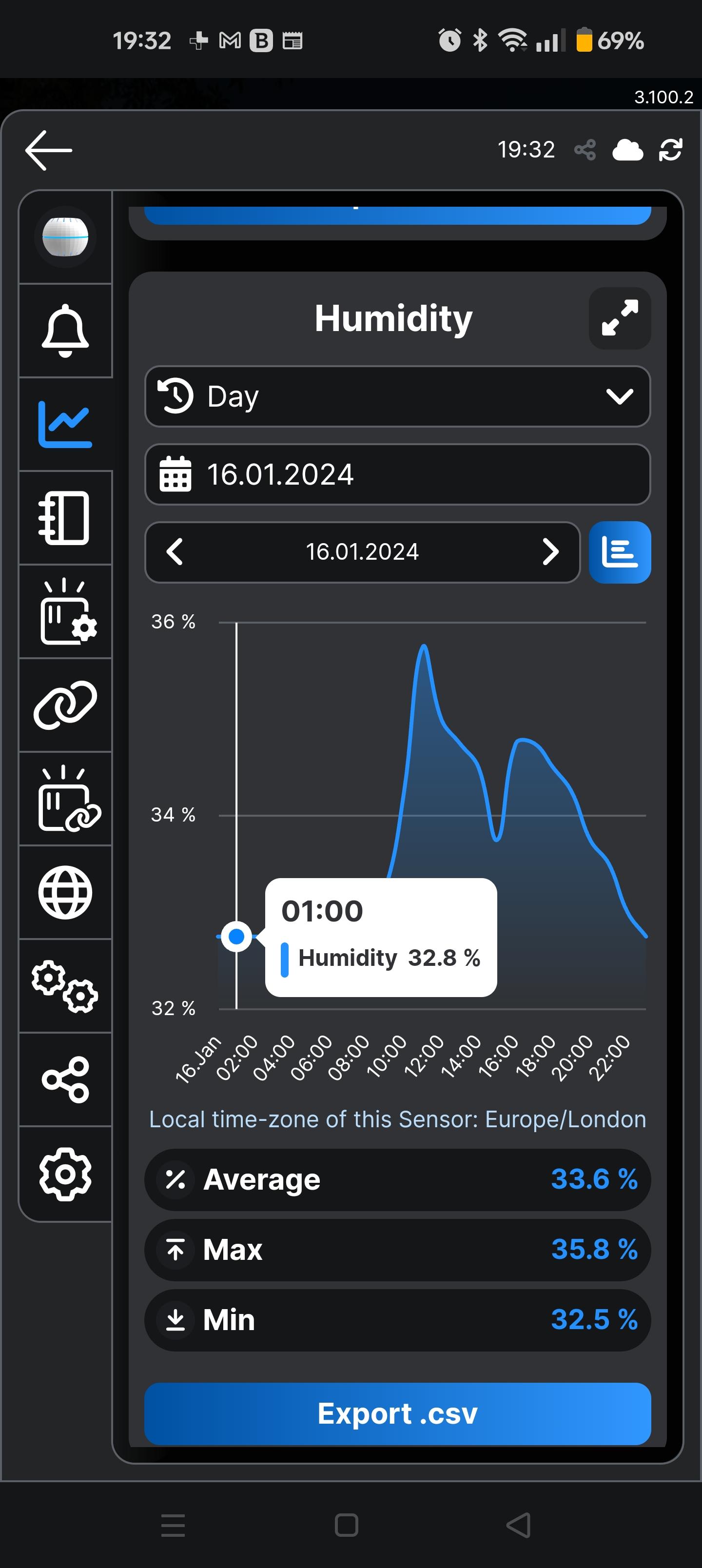

JohnMo Posted July 19, 2024 Share Posted July 19, 2024 (edited) 26 minutes ago, G and J said: presence of MVHR would appear to deliver lower humidity internally. You think so and are lead to believe that, but it's not exactly true. Our house has MVHR and our heated summer house dMEV. Both have a sound ventilation strategy. As an example mid winter humidity on 16 Jan House Summer house Both are heated to a similar temperature, and the humidity is at a similar figure, with the dMEV slightly lower. Edited July 19, 2024 by JohnMo Link to comment Share on other sites More sharing options...
