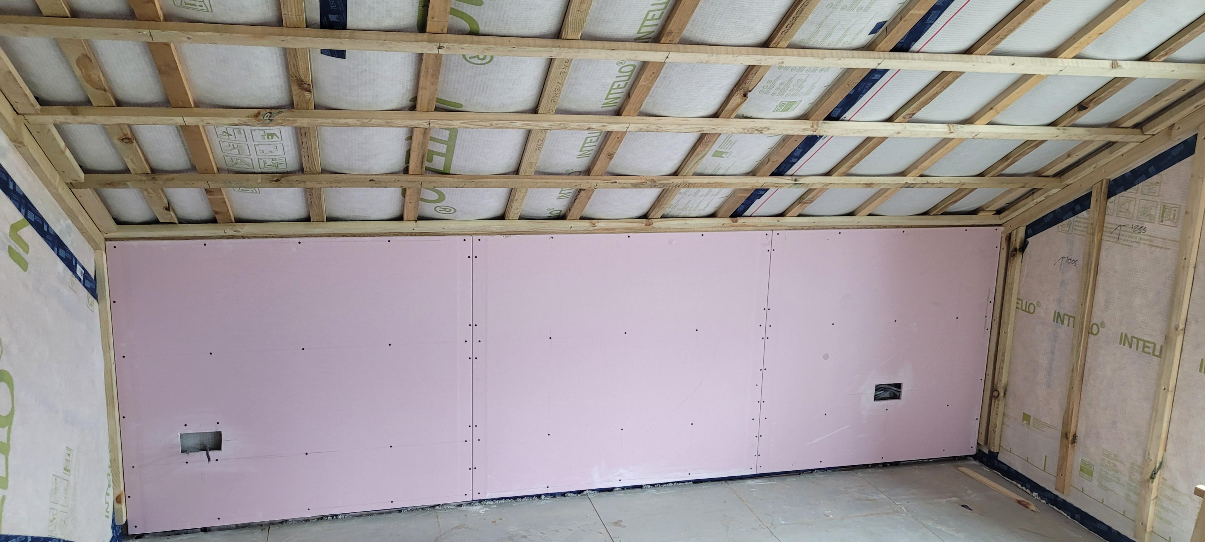

MikeSharp01 Posted July 18, 2024 Share Posted July 18, 2024 We used intello plus as it has strengthening strands for exactly that - but it didn't work as expected we had bulging much more than expected on the first pumping. We put additional supporting vertical battens under the horizontal battens that hold the plasterboard, at 300mm centers to keep it in check. (Main studs are 600mm. This bulging gets worse when it gets really warm as the plastic stretches and we got some slumping on the tall.columns. So I let it slump and them filled any gaps with more cellulose when I found the voids with an IR camera / strong torch- if you put a bright LED against the membrane you can see holes. Attached is a pick of a roof section the 300 centers. 1 Link to comment Share on other sites More sharing options...
SBMS Posted July 19, 2024 Author Share Posted July 19, 2024 17 hours ago, MikeSharp01 said: We used intello plus as it has strengthening strands for exactly that - but it didn't work as expected we had bulging much more than expected on the first pumping. We put additional supporting vertical battens under the horizontal battens that hold the plasterboard, at 300mm centers to keep it in check. (Main studs are 600mm. This bulging gets worse when it gets really warm as the plastic stretches and we got some slumping on the tall.columns. So I let it slump and them filled any gaps with more cellulose when I found the voids with an IR camera / strong torch- if you put a bright LED against the membrane you can see holes. Attached is a pick of a roof section the 300 centers. Did you blow the cellulose in yourself or get an installer to do it? Worrying there was voids that you discovered if using an installer? Link to comment Share on other sites More sharing options...
MikeSharp01 Posted July 19, 2024 Share Posted July 19, 2024 3 hours ago, SBMS said: Did you blow the cellulose in yourself or get an installer to do it? Worrying there was voids that you discovered if using an installer? Yes we did blow it in ourselves and there were not any voids when we did it for 8 months, then we had heat wave and I noticed the bulges getting worse and found the voids at the top. So we added the intermediate battens - chamfered the edges to avoid damage the membrane and then refilled the voids. No problems since. 1 1 Link to comment Share on other sites More sharing options...
