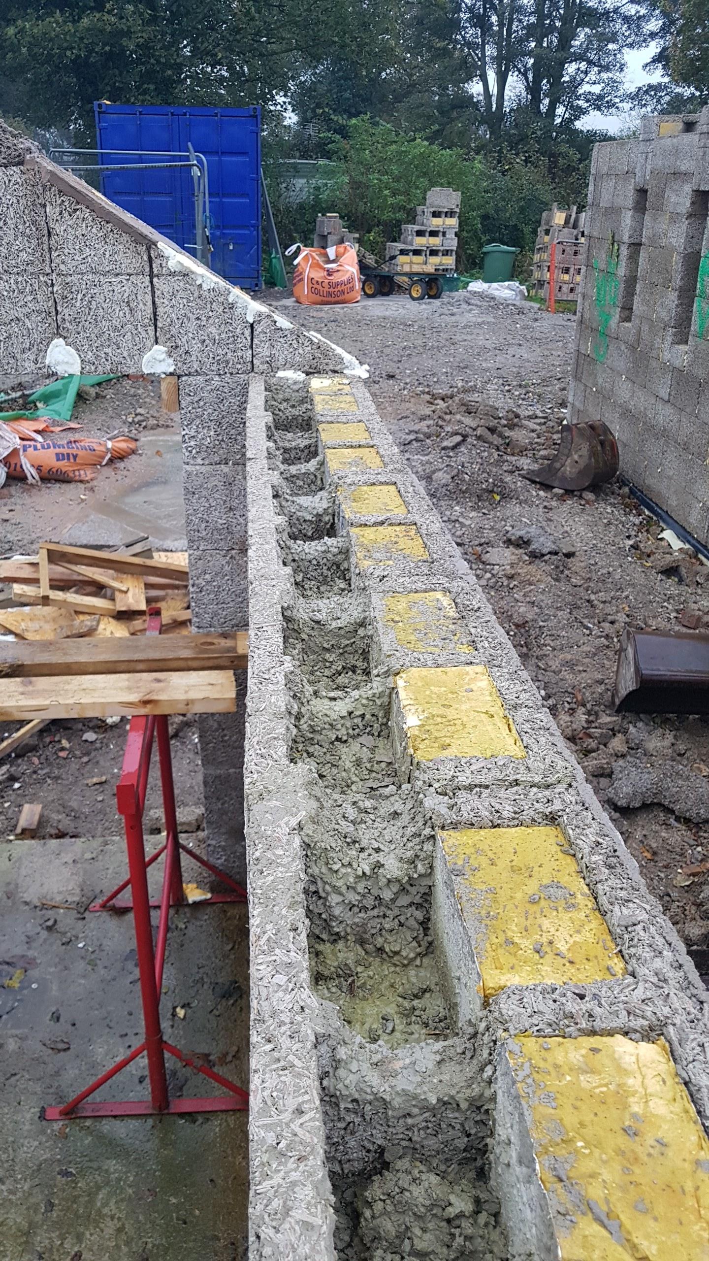

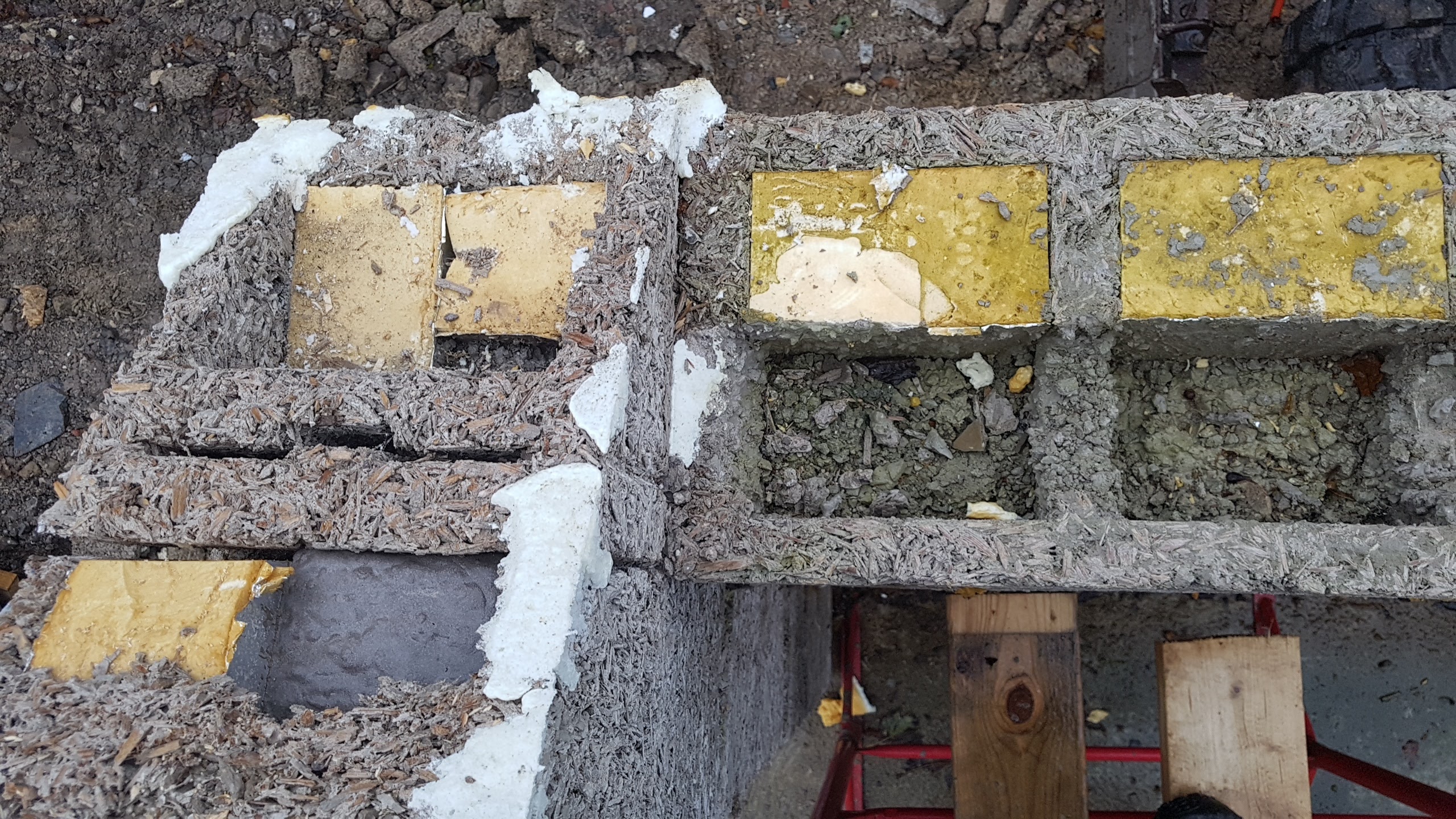

ToughButterCup Posted October 24, 2017 Posted October 24, 2017 I'm about to pour the last bit of concrete before putting in the wall-plate on the piggery. Have a look at this; Once I have poured the last 100mm or so of concrete, (in the holes you see) I will need to fasten the wall-plate to it. Should I run the wall-plate right the way through the gable, or cut the wall-plate flush with the gable and fill that with concrete? The image below should help explain.. I have deliberately not poured concrete into the gable block in line with the wall-plate - just in case your advice is that the wall-plate should run all the way through the gable Maybe it doesn't matter, and both options are reasonable. Just for information, this building isn't subject to Building Regs: it replaces the old piggery which has stood there for about a century or so.
RichS Posted October 24, 2017 Posted October 24, 2017 The wall plate does not go into the gable. Just butt it up to the gable blocks and you'll be fine.
Alex Posted October 24, 2017 Posted October 24, 2017 what RichS said. I was told it doesn't really matter but have the outside forward run down to the corner but it was easier for me to run into gable bottom. Mainly because I was cutting corner blocks and therefore would have to add inside edge of EPS.
Onoff Posted October 24, 2017 Posted October 24, 2017 I wonder if there's any merit casting in projecting studs ready for the wallplate or indeed have over length studs bolted to the wall plate. When the concrete is dry nut ' em down! You would of course have to pre know where your trusses are going!
ToughButterCup Posted October 25, 2017 Author Posted October 25, 2017 Hmmm, excellent idea(s) @Onoff The roof will be vaulted, so no need for trusses. I like the projecting studs idea. I'd have to set them in some kind of 'chair' so they are perfectly vertical.... I like the idea partly because I have about a mile of threaded bar left over from the shuttering. The other thing is the the wall plate can be tweeked perfectly level with that system (- I suppose: never been here before as usual ) Thanks for the photo @Alex. I like that corner detail. Makes sense.
