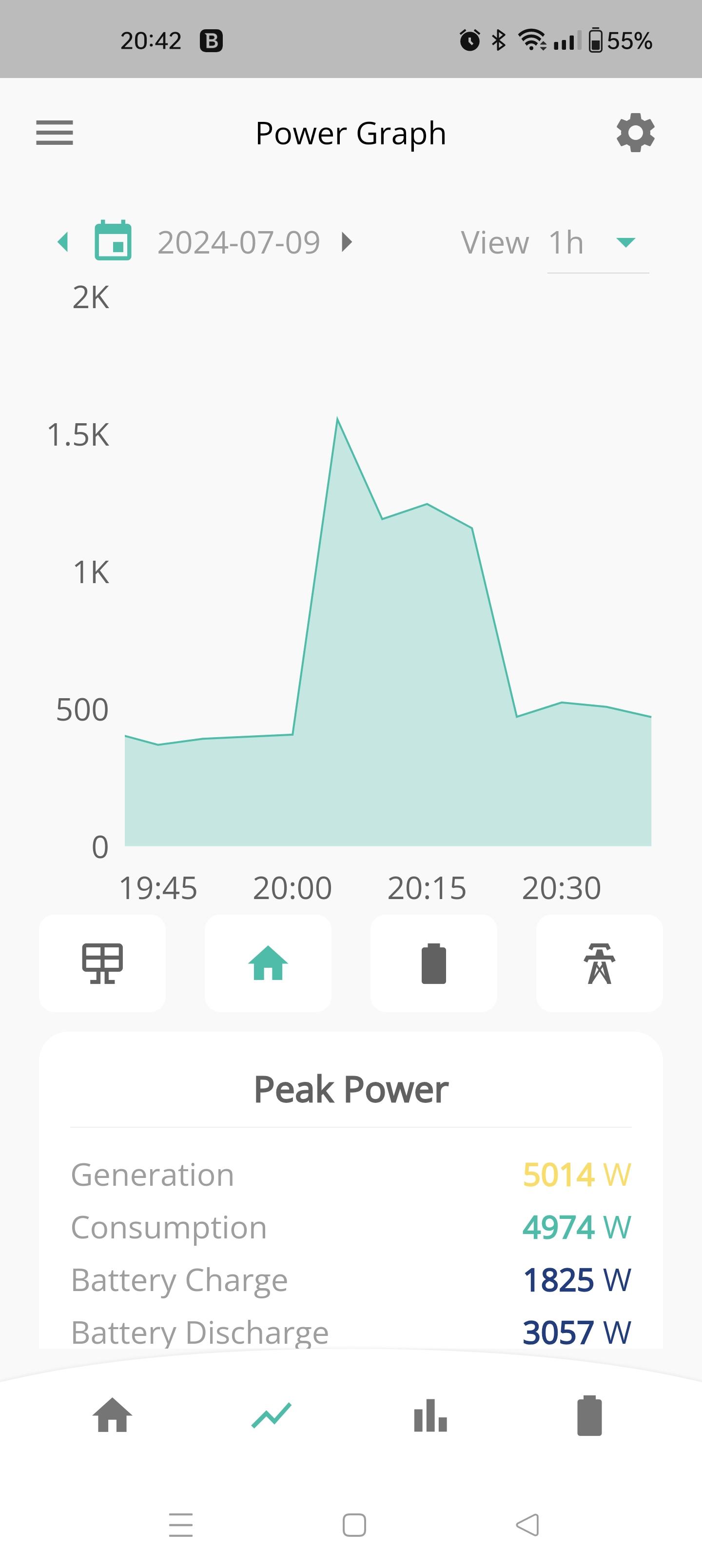

My run, data from the battery so is whole house. It's in 5 min snap shots, but you can see the drop in load at about 5 mins after it's hit target temp. Flow target was 26 degs, end temp when I shut down was 29.1.

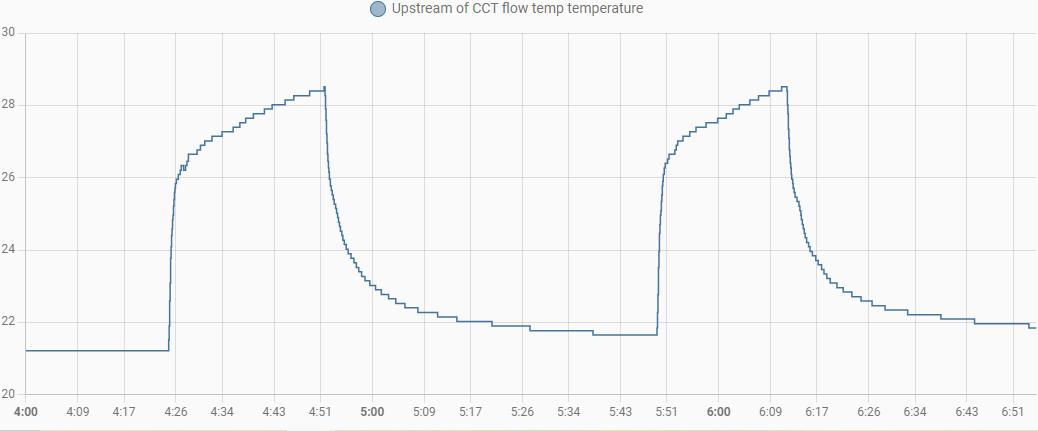

I got this out of home assistant and is the flow temperature going in to the UFH. It has only done two cycles today. First run was at 0425, stopping at 0452, so about 27 mins run time, then off for an hour, restarting around 0550 and running 20 mins or so. It was about 10 degs outside. Now 13 deg.

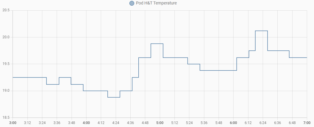

This is the garden room I am trying to keep warm (19 to 20 degs). All being done without a thermostat on WC only. Currently getting about 1 deg swing in temperature.

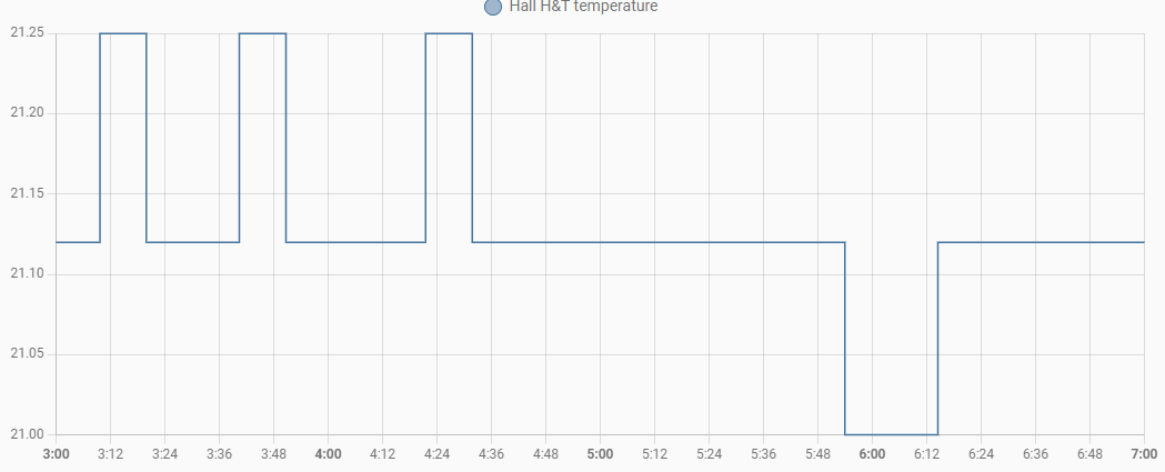

This is the house also connected in the same zone so also getting the same heated water in the UFH, house floor acting as a buffer. Getting 0.25 deg Swing Temp.
Definitely no compressor cycling there, job done.
