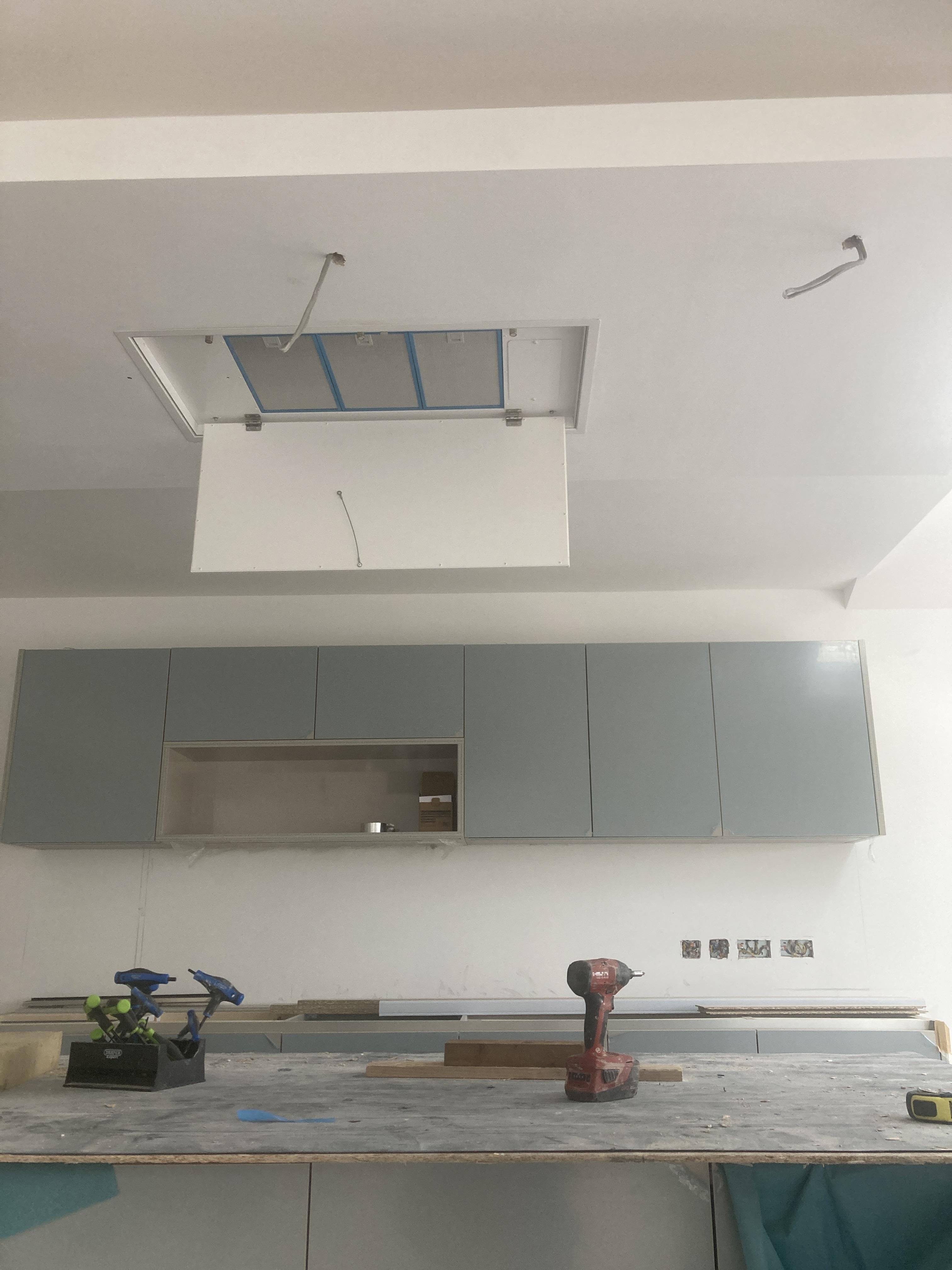

nod Posted July 7, 2024 Share Posted July 7, 2024 I’ve fitting ours this morning Prior to the quarts arriving Nearly all specify 6” 150 ducting Our previous Italian extractor stated that the warranty would be voided for anything less Link to comment Share on other sites More sharing options...
Barnboy Posted July 7, 2024 Share Posted July 7, 2024 Our kitchen designer recommended I put in a 6" duct before we'd even got a design from him, more on the basis of you'll get less noise from a 6" than a 4". When our kitchen arrived the hood came with a 6"-4" reducer so could have been fitted either way but why would you want to pump a 6" capacity fan into a 4" hole and choke it. I'd put 6" in if I was you, it's always better to go bigger and be safe. Link to comment Share on other sites More sharing options...

Lofty718 Posted July 7, 2024 Share Posted July 7, 2024 https://www.appliancesuperstore.co.uk/fisher--paykel-hp90ihcb3-90cm-built-in-extractor-hood-8578-p.asp I've got this, running up a chimney flu with 150mm ducting, it is very powerful Builder initially ignored instructions and put in 100mm ducting, but I ripped it out Link to comment Share on other sites More sharing options...

Canski Posted July 8, 2024 Share Posted July 8, 2024 I recently installed a 150 duct with an erbauer core bit from screw fix. It went through fine. Jeez that fan sucks. You could dry your hair under the cooker hood. Mine also came with a 150 tip 100 reducer and I’m glad I tossed it away and went full bore. Link to comment Share on other sites More sharing options...
