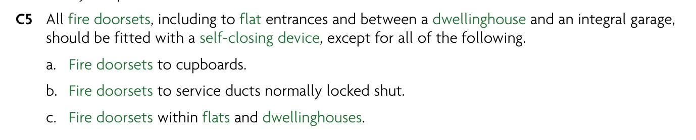

revelation Posted July 1, 2024 Share Posted July 1, 2024 What are the regulations regarding self-closers (perkos) on fire doors? We have had a loft conversation, so we are installing fire doors everywhere. The issue we have is that the building inspector has said we do not need self-closers on the doors, my joiner says he always put them in. I have asked for the information from the BCO in writing but after asking several times still haven't received it. We have 30FD and all doors will have the intumescent strips. Thanks in advance Link to comment Share on other sites More sharing options...
garrymartin Posted July 1, 2024 Share Posted July 1, 2024 The BCO is correct. Building Regulations Approved Document B, specifically Appendix C. Link to comment Share on other sites More sharing options...

Mike Posted July 2, 2024 Share Posted July 2, 2024 23 hours ago, revelation said: do you have an idea when the self closer rule was scrapped? 2003: Link to comment Share on other sites More sharing options...
kandgmitchell Posted July 3, 2024 Share Posted July 3, 2024 The 2000 (ammended in 2002) Approved Document for Part B - Fire Safety had a specific requirement for self closers to all doors opening onto the escape stairway. The next full revision issued in 2006 had that requirement removed, restricting self closers to attached/intergral garages only. Link to comment Share on other sites More sharing options...
