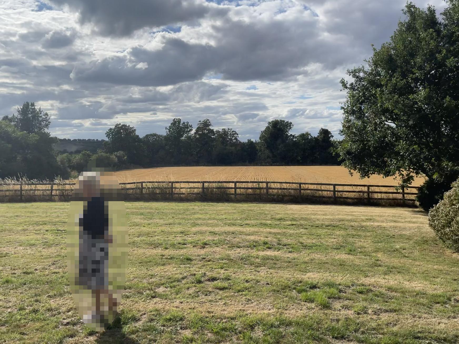

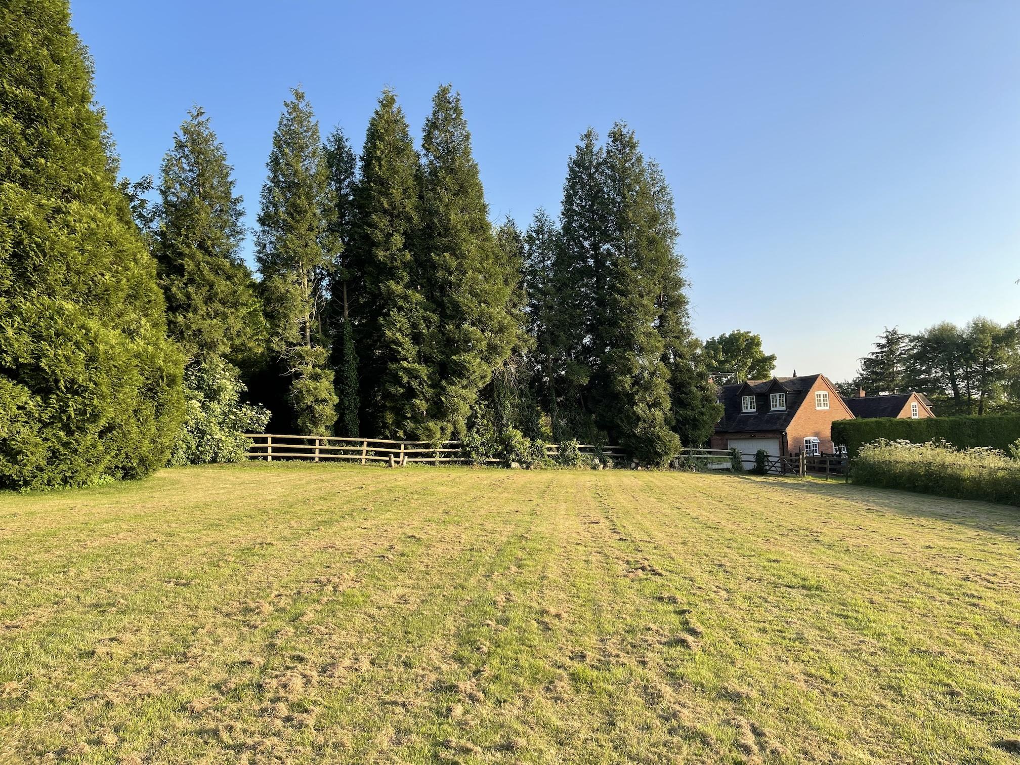

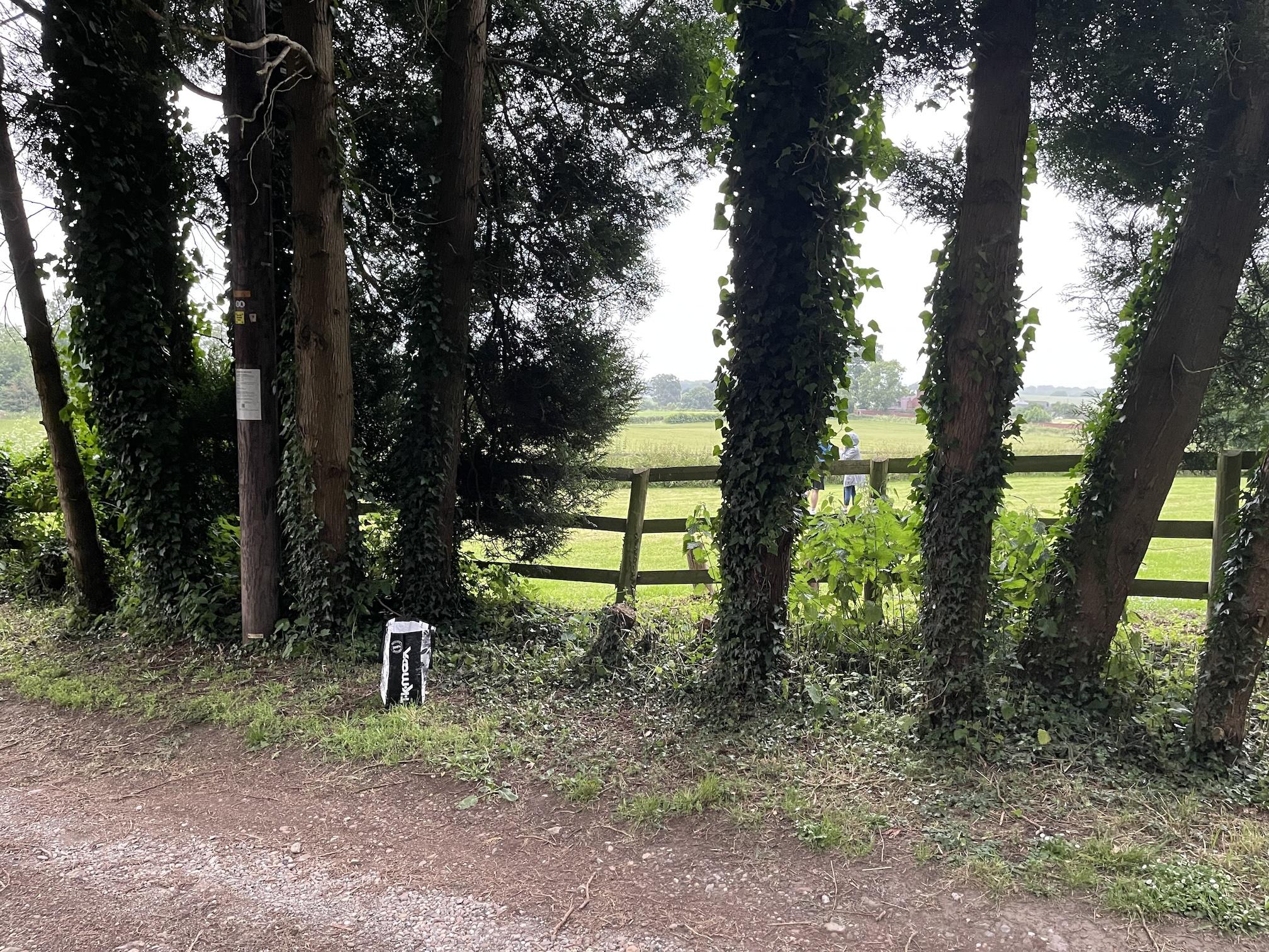

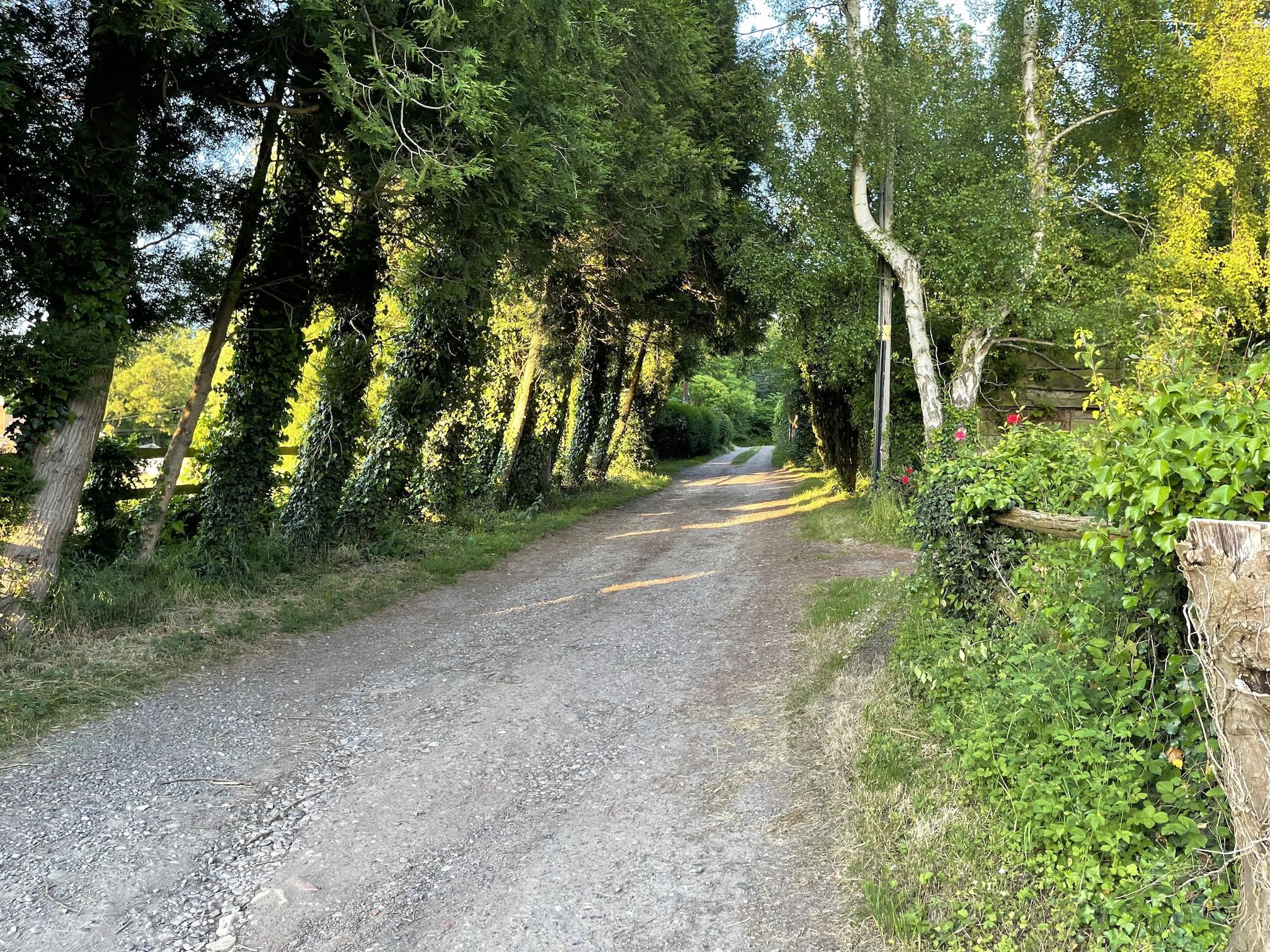

garrymartin Posted June 29 Share Posted June 29 TLDR; we've been unsuccessful at appeal for a single self-build dwelling on a 0.25 acre rural plot in Droitwich, Worcestershire. The longer version, with some background. Like most people, our search for a plot has lasted years, beginning in earnest in 2017, although in reality, in our hearts, much earlier. The first real glimpse of anything remotely affordable came in 2020 following a conversation with one of our neighbours where we mentioned we were still looking for somewhere to build our own home and they mentioned their sister might be looking to sell a side-garden plot. We viewed it, and although not ideal (it backed onto a railway) we agreed a price to purchase the 0.2 acre plot with existing outline planning permission on the condition that we would subsequently be able to secure a dedicated electrical supply at our required supply characteristics before proceeding. Unfortunately, this wasn't possible due to convoluted land ownership for the route of any new cable, so we had to reluctantly back away from that particular opportunity. Nothing much came up for the next few years. My skills at finding potential plots and analysing them for potential costs (services, fencing, access, etc.) and the likelihood of being able to gain planning permission improved greatly. Sadly, this was tempered with frustration at the increasing asking prices of plots in our target search area, including completely unrealistic asking prices for land without any permission at all. Then, a chance conversation with some close friends came with the mention of their parent's large rear garden which started us on this current journey. After long discussions over several months (they had never even remotely previously considered selling part of their garden), we thought we'd been unable to get to a mutually agreeable position and had given up hope. Nevertheless, following a few more months of fruitless searches, we decided to make one last-ditch increased offer and, well, it must have just landed at the right time because it was accepted! The agreed purchase price for the bottom 0.25 acres of their garden came on the condition (from our perspective) that we were able to achieve planning permission and (from their perspective) that we did all the work to do so and took on any risk (and cost) associated with achieving that permission. We submitted our first planning application in May 2023 but this was refused. Following advice on "dual-tracking", we submitted a second application in July 2023 with additional information addressing the refusal, but we also started an appeal on the first application at the same time. Despite our efforts, the second application was also refused for the same reason as the first. Crucially though, by dual-tracking, we did not lose another couple of months as the appeal on the first application was already in progress. Had permission been granted for the second application, we could have withdrawn the appeal. This is a great strategy if you think you might end up in the same position. The appeal process is both long and lacking in any certainty regarding the expected duration or indeed the visibility of progress over time, and it took until late June 2024 for us to find out we had not been successful and that our appeal had been dismissed. Please, don't underestimate the emotional and mental toll an appeal can take. In retrospect, we should have engaged planning consultants after the first refusal, maybe even before. Although there would have been a cost, we've spent almost a year in limbo not knowing what the appeal outcome would be, and if I'd had a high degree of confidence that engaging a planning consultant after the first refusal could have avoided that lengthy delay, it would have been worth every penny. Caveat emptor - make sure it's an amazing planning consultant of course! After the first refusal on "sustainable travel" grounds, I included extensive information about the cycling options available from the plot. But the planners still said that although they accepted this was possible, it was still not particularly safe and they again refused permission. Only after submitting the appeal and getting the second refusal did I find a planning statement that contained detailed statistics from Strava showing how extensively a particular route was used by cyclists and how, combined with accident data, I could use that approach to evidence that it was a well-travelled and very safe route. A planning consultant might have known this prior to the second, even the first application, and might have included the detail accordingly, potentially removing the planner's position for argument. The moral of this particular part of the story is that as intelligent as you think you are, there are always experts in the field that have experience aligned to that intelligence that will trump you every time. With a significant delay, we now know that we do not have permission. I can't begin to tell you how disappointed I am, especially as I believe the Inspector has been particularly harsh, has erred in some assumptions and has not taken into account all of my evidence and statements. But what we did have in the Inspector's comments was an indication that things may have looked a little more rosey for us had the application been of a type where conditions could have been applied; as a Permission In Principle application, this wasn't possible. So the fact that we would be installing two 22kW car chargers, that we would be building to a Passivhaus PLUS specification, that there would be a home office, and that we would be installing Ultrafast Broadband could not be secured and hence there would be no certainty to them. As a result, the Inspector noted "this and any associated environmental benefits attract limited weight". So the moral of this particular part of the story is to be very careful about the application route you choose. So where do we go from here? Well, we're discussing the situation with the landowners and seeing whether they are up for one last go at planning. If they are, we'll hold out a little while to see how the new incoming government might shake up the planning laws and re-write the NPPF and then we'll look to submit an Outline Application with All Matters Reserved such that we can be clear that we are willing to accept conditions that would ensure the environmental benefits of the development. In the meantime, I've also requested clarification from the LPA about a number of areas of application of policy that I find difficult to agree with. For example, Paragraph 109 of the December 2023 NPPF states "Significant development should be focused on locations which are or can be made sustainable, through limiting the need to travel and offering a genuine choice of transport modes." But LPAs and some Inspectors apply this particular paragraph and especiallly the "offering a genuine choice of transport modes" to all development. Is a single dwelling "Significant development"? If the remainder of the sentence should indeed be applied to all development, why does it start with the word "Significant"? There are others. Our dream has taken a significant hit, but hopefully, we're not down and out just yet. So, as an avid and competent DIY-er, with exposure to many planning areas that I never envisaged becoming knowledgeable in before, I've already been dipping into conversations as I've been building up my knowledge on the forum, so although not a newbie, now seems like the time for a proper introduction to both me, my family, and the plot. So, my name is Garry, I'm 54, I work in a senior position for a global IT services company, and I currently live in Worcester with my wife Nicki and my two adult children, Georgia and Alex (except when he's studying at Manchester Metropolitan University). Our proposed plot is the bottom 0.25 acres of the garden of an existing dwelling (so rural brownfield), but it has its own access (by prescriptive easement) along a private road to a field gate. We're fortunate to have a transformer for the electrical supply (which we hope to get upgraded to a three-phase supply) and a telegraph pole with 1Gbit fibre availability right next to the plot boundary, but there is a 3" PVC water main that runs right through the plot that will need to be moved due to the 6m easement required (3m either side of the main). Of course, on the other hand, the water supply is therefore also very close! There is a sewage treatment plant in the garden of the existing dwelling that is large enough to cope with the extra demands we will place on it. The existing dwelling and garden are on the outskirts of Droitwich and border a country estate and farmland with a couple of Grade II Listed properties (crucially we should not affect the "setting" of those properties) and a handful of cottages and barn conversions nearby. The planning applications and all documents (including the appeal) can be found online, so if you are interested in viewing them, drop me a PM and I'll send the links. If we ever do get permission, we'll be working with an award-winning architectural practice based in Herefordshire to create a Passivhaus dwelling with a design brief that currently envisages a home of approximately 220m2 with a 60m2 garage/workshop. I'm hopeful that I'll be able to bring you on the journey at some point, and that I'll continue to benefit from the combined wisdom of all forum members as we move forward with our design and, hopefully, build. In the meantime, I've attached some photos of the plot for your viewing pleasure. The first shows the bottom of the garden and most of the 0.25 acres of the plot. You can see the field gate in the bottom right corner. The second shows the plot from the bottom right corner, including the field gate that provides access. The third shows the view to the right (of the first photo) which is farmland (including a blurred-out landowner). The fourth shows the view across the plot to the farmland, taken from the access road (with the planning notification attached to the telegraph pole that has the 1Gbit fibre connection) The fifth and sixth show the view to the left (of the first photo) which is the access road. In the fifth photo, you can see the transformer bordering the plot, and the garage of the property that is visible in the first photo. The garage is at the end of the access road before it turns into the plot to the right, and round the corner to other properties to the left. In the sixth photo, the view is from almost the same location but looking in the opposite direction towards the main road. 1 Link to comment Share on other sites More sharing options...

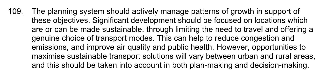

garrymartin Posted June 30 Author Share Posted June 30 2 hours ago, Alan Ambrose said: The cynical part of me suggests that 'sustainable travel' is just an excuse to do what the planners want - which is to discourage development in some circumstances. And therein lies part of the problem to my approach. Coming from a background where I'm very well versed in contractual wording, I naively assumed that the NPPF, although guidance, is very selective in its choice of words. For example, and the one that drives me nuts... So this is the paragraph that keeps being quoted in relation to limiting the need to travel and offering a genuine choice of transport modes, which is the reason for my refusal. Note it says "Significant development should be..."? It doesn't start with "Development should be..." Is a single dwelling "significant development"? I don't think so. Also, I'm technically rural, so that should have been taken into account when considering access to walking and public transport and really wasn't. 1 Link to comment Share on other sites More sharing options...
garrymartin Posted June 30 Author Share Posted June 30 6 minutes ago, joe90 said: I agree. Is it worth going back to the LPA and asking what they would accept (I know many won’t do this but it’s got to be worth asking 🤷♂️). My currently developing plan is to wait for the answers to my policy questions (which include incidentally whether the Head of Planning considers a single dwelling to be "significant development"), see what happens with the new government, and then go for pre-planning advice and an outline application with some matters reserved, including menas of access as the only reserved matter. In that way, I can offer various conditions to secure the environmental benefits I mentioned previously (electric vehicle charging, dedicated home office, Passivhaus Plus, etc.) I can't really see any more effective options but am open to suggestions. 1 Link to comment Share on other sites More sharing options...
joe90 Posted June 30 Share Posted June 30 4 minutes ago, garrymartin said: Note it says "Significant development should be..."? It doesn't start with "Development should be..." Is a single dwelling "significant development"? I don't think so. Also, I'm technically rural, so that should have been taken into account when considering access to walking and public transport and really wasn't. Quite….however it might be worth engaging a planning consultant who has dealt with similar situations before. 1 Link to comment Share on other sites More sharing options...
garrymartin Posted June 30 Author Share Posted June 30 4 minutes ago, joe90 said: Quite….however it might be worth engaging a planning consultant who has dealt with similar situations before. Probably. I am wary as I can clearly see evidence of good and bad consultants, and it's often not clear who, in a particular consultancy, is responsible for various responses. I'll maybe interview some when my plan moves forward a little. I already have previous appeals as reference that specifically mention "Significant" in the context of rural development and sustainable transport; example, for 20 residential dwellings (in 2022) - "In addition to the above, I would add that Paragraph 105 of the Framework states that 'significant development should be focussed on locations which are or can be made sustainable' and 'opportunities to maximise sustainable transport solutions will vary between urban and rural areas, and this should be taken into account in both plan-making and decision-making'. In my judgement, the proposal does not quite meet the threshold for being 'significant' development..." So 20 residential dwellings doesn't meet the threshold for 'significant' according to that Inspector. This is the problem, they're applying their own judgement and so you can't get consistency and can only challenge an appeal on the grounds of law, not of judgement. 1 Link to comment Share on other sites More sharing options...

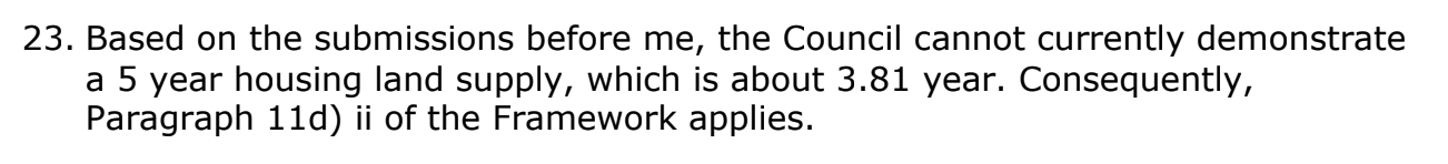

garrymartin Posted June 30 Author Share Posted June 30 Incidentally, I did actually point out that my appeal was not in relation to 'significant development' in my statement of case, but the Inspector seems to have disregarded it... Oh, and did I mention my LPA can't demonstrate a 5-year housing supply... 😲 Link to comment Share on other sites More sharing options...
