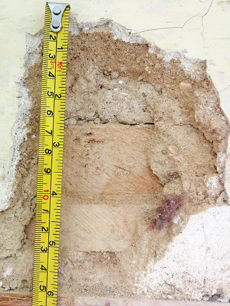

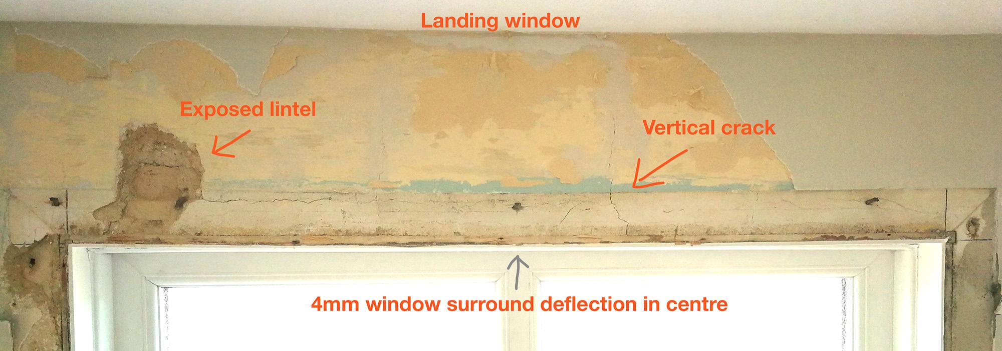

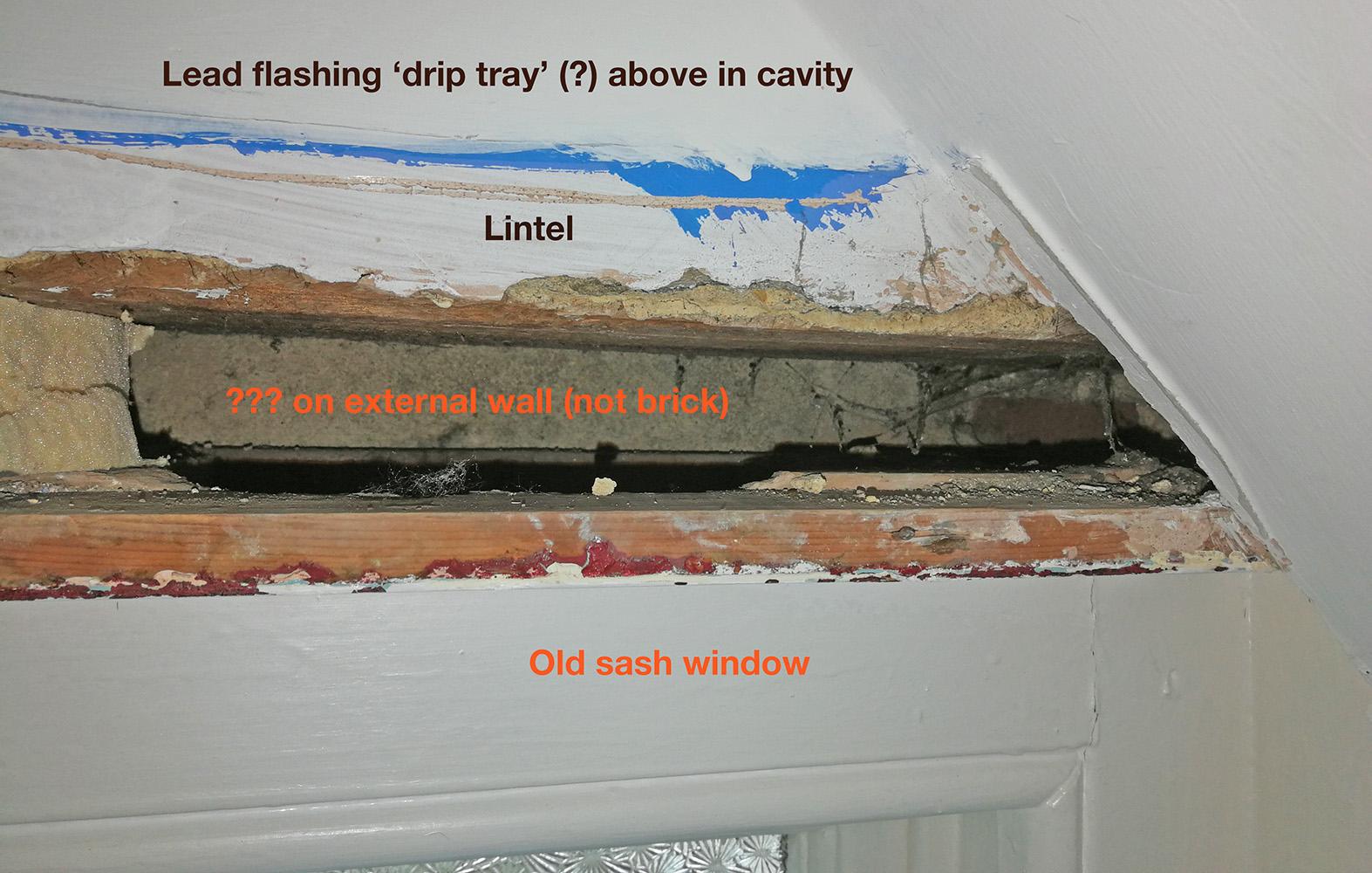

Sparrowhawk Posted June 28, 2024 Author Share Posted June 28, 2024 (edited) I don't mind paying for the advice. I got a builder round (I don't have a "friendly" one) and he was happy to quote for new lintels and cavity drip trays, and got defensive when I asked if helical bars could be used to repair the brick arch over the front door. So I'd quite like a view from someone who doesn't have a financial motive in the work. Photos from the opening up I've done so far: Landing (has cracked external sill) I will have to strip off more plaster to see if the lintel has deflection, or only the original wooden window surround. Directly below it - original sash window under the stairs (gets damp in the cavity here - assuming due to cracked sill above?) I'll take photos of the front door arch tomorrow when I've taken the porch ceiling down. Edited June 28, 2024 by Sparrowhawk Link to comment Share on other sites More sharing options...

Sparrowhawk Posted July 18, 2024 Author Share Posted July 18, 2024 Well, getting a Structural Engineer to visit was thoroughly worthwhile. He came today and passed all the lintels as fine, though said that with the slightly bowed one with a slightly twisted window on the landing, if it was his house he'd replace this one while the window was out - but it was up to us because the state of the window could be down to poor fitting. All cracking is thermal cracking and nothing large enough to be of concern. The biggest win was the outer leaf of the bay window base, which a builder told us would have to be taken down and rebuilt, including digging out new foundations. For this the structural engineer reckoned that replacing one or two courses of bricks at the top (the most water damaged), and adding more wall ties as there's only 3 would be all that's needed, even with the extra weight of triple glazing. 2 Link to comment Share on other sites More sharing options...
