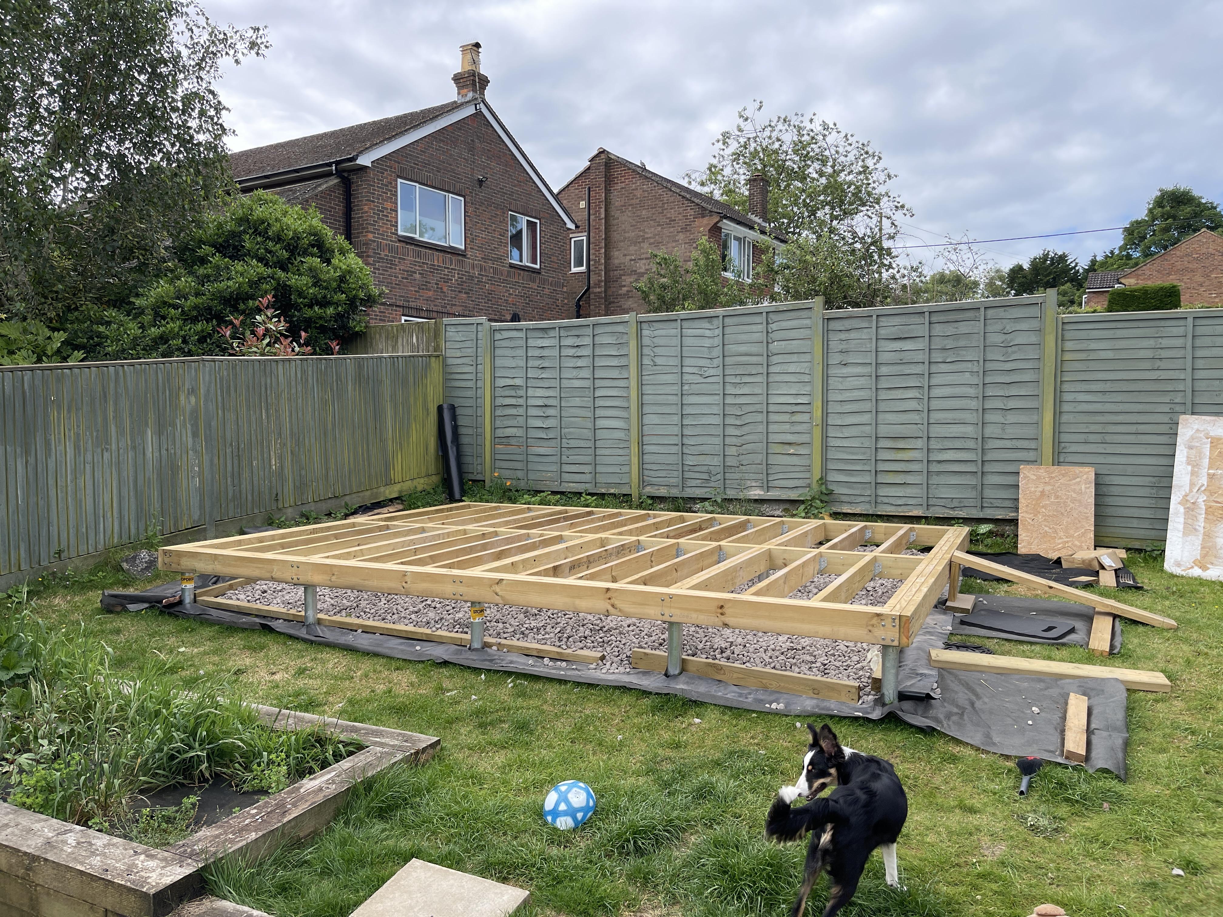

The Bear Posted June 27, 2024 Share Posted June 27, 2024 Hello, first-time poster here. I’ve lurked a bit, now I’m taking the plunge.. I’m building my wife a garden office: ground screws, timber base, 70mm Mia log cabin from Tuin. Here’s where I am so far: Tuin offer their own insulation kits: basically, marked up Celotex and fixings, 40mm or 50mm for floor and roof. I thought that with 6x2 beams in the base, it should be possible to improve on that for the floor. And with rafters below the pent roof, to keep within permitted development I’d go for a cold roof, even if it meant losing a chunk of ceiling height. My key aim is, this needs to be a comfortable, 365 days a year working office, that will last up to 20 years with proper maintenance. Looking at insulation, PIR was my first choice. But the internet has shown me, not necessarily the best or easiest to install. Some of my timbers, naturally, have a twist or bow, so I can’t be sure I won’t have air gaps. And though I’ve used expanding foam often for work, that also seems potentially a bit hit and miss. Though I am minded to buy a single sheet of Celotex to see just how tricky it is to cut accurately. Despite myself, I’ve come round to the idea of this approach: Mostly on the basis that a well-fitted slab insulation would perform better than a poorly done PIR job. Although it would cost more, my thinking is, if I took care with the fitting, at least I’d know it was airtight. The roof is another matter. This will sound daft, but I don’t know the exact floor to ceiling height I’ll have yet. It’ll depend on the flooring I use, and also input from my wife! I have a rough idea from the plans, that base to ceiling height will be 2092mm. But that doesn’t include height lost to flooring, or the exposed rafters, which are 145mm deep. I can see now why Tuin recommend a warm roof, perhaps. But I don’t want any hassle from an unexpected planning visit. The good thing is, I’m still at a stage where I can make decisions on these bits, though the clock is always ticking. From looking at previous posts here, I was wondering about slab insulation between the rafters, with an air gap above, then some PIR below, like this, and maybe with a thin tongue and groove plank ceiling. But I can see that will depend on how low that brings the ceiling. Still, I thought if I asked for advice now, I could be turning it over while the office goes up. Grateful for any and all helpful comments! Link to comment Share on other sites More sharing options...

Russell griffiths Posted June 27, 2024 Share Posted June 27, 2024 With a raised floor just be aware of rodents i would want a solid base beneath the insulation either plywood or cement sheet. just not a membrane then insulation, it will make the nicest rodent house going. 1 Link to comment Share on other sites More sharing options...

The Bear Posted June 27, 2024 Author Share Posted June 27, 2024 1 hour ago, Russell griffiths said: With a raised floor just be aware of rodents i would want a solid base beneath the insulation either plywood or cement sheet. just not a membrane then insulation, it will make the nicest rodent house going. Ugh, that is a good point.. though fitting any kind of solid sheet underneath now would be tricky. I had wondered if a decent mesh around the perimeter would be effective.. Link to comment Share on other sites More sharing options...

JohnMo Posted June 29, 2024 Share Posted June 29, 2024 33 minutes ago, The Bear said: rodents has given me another good point to consider. Could you just staple small hole chicken wire under you floor frame? 1 Link to comment Share on other sites More sharing options...
The Bear Posted July 4, 2024 Author Share Posted July 4, 2024 On 29/06/2024 at 14:38, JohnMo said: Could you just staple small hole chicken wire under you floor frame? I’m wondering about that! Probably the best solution, and more preventative than just running a skirt of it around the base.. Link to comment Share on other sites More sharing options...
