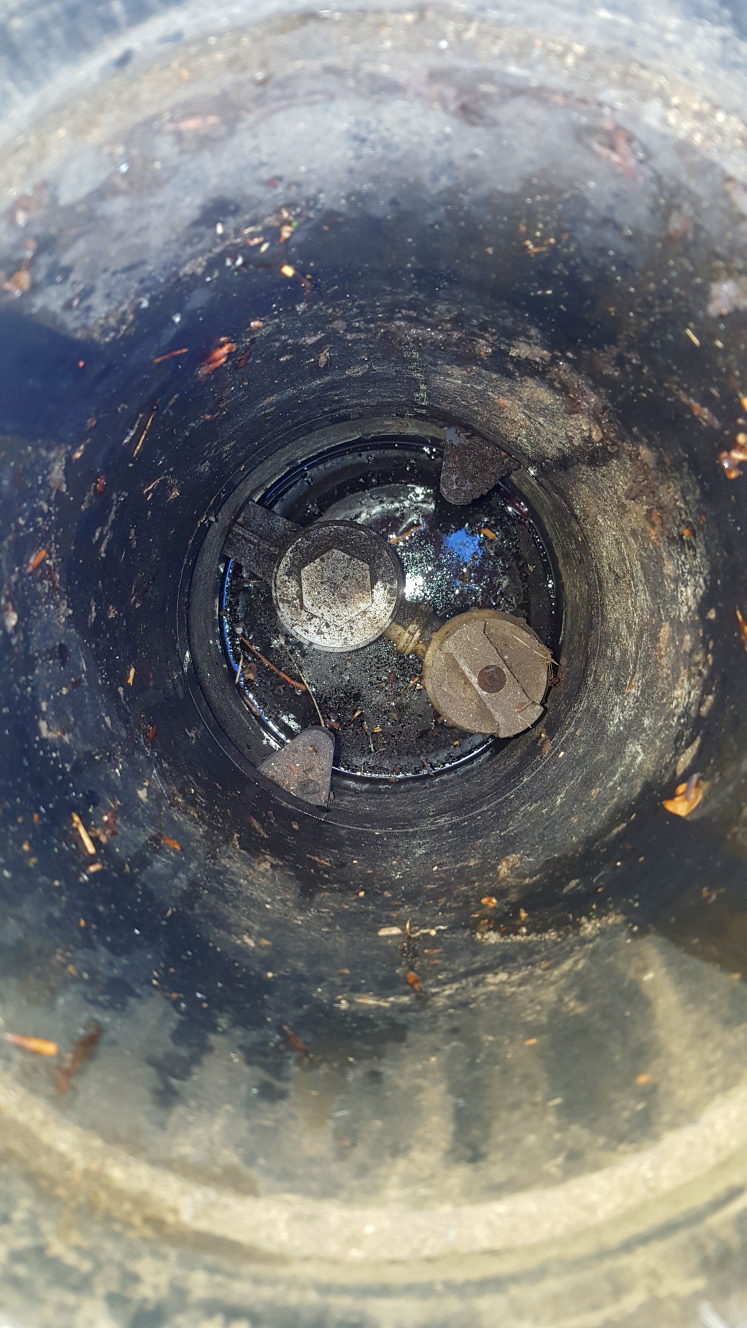

Ferdinand Posted June 23, 2024 Share Posted June 23, 2024 A couple of days ago my mains water volume fell by about 3/4. This is a piccie inside my meter hole. I think it means the supplier thinks there is a problem with the account. I'm not aware, but given recent illnesses I would not be surprised. Can someone confirm? Thanks F Link to comment Share on other sites More sharing options...
Conor Posted June 23, 2024 Share Posted June 23, 2024 Nothing wrong there. Just make sure the tap is fully open. A restricted bung is usually yellow, white are full flow, red are stopped. 1 Link to comment Share on other sites More sharing options...
Temp Posted June 23, 2024 Share Posted June 23, 2024 Neighbours pressure OK? Perhaps check the water co website. In our area we get regular water main failures. They have to bridge the fault with hoses until they can fix it, meanwhile we get somewhat reduced pressure. 1 Link to comment Share on other sites More sharing options...
Ferdinand Posted June 23, 2024 Author Share Posted June 23, 2024 Should I not be able to read the water meter there? That used to be the case. Link to comment Share on other sites More sharing options...
Conor Posted June 24, 2024 Share Posted June 24, 2024 6 hours ago, Ferdinand said: Should I not be able to read the water meter there? That used to be the case. You don't have a meter, unless it's somewhere else? 1 Link to comment Share on other sites More sharing options...

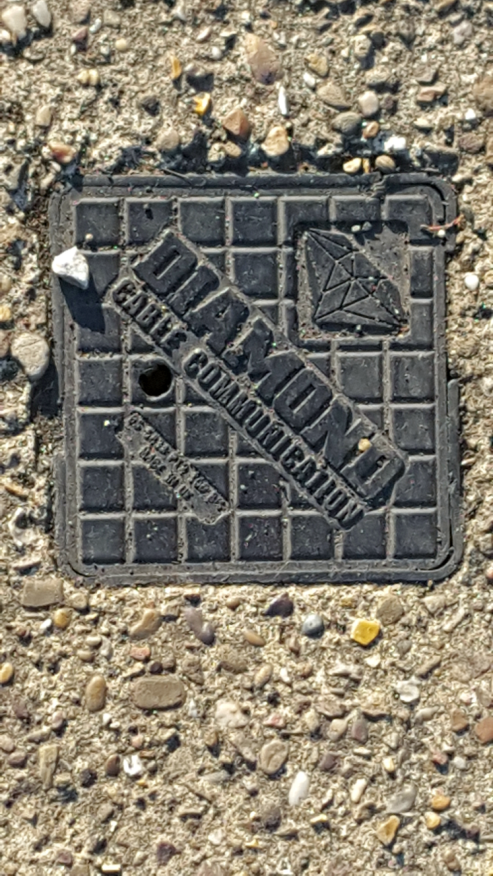

Ferdinand Posted June 24, 2024 Author Share Posted June 24, 2024 47 minutes ago, Conor said: You don't have a meter, unless it's somewhere else? Thank-you all for the replies. Up until recently, I read it by looking down that hole with a phone camera, which is immediately on the threshold of my drive entrance. I may even have a piccie from a couple of years ago. Nothing else has been fitted to my knowledge, so they are getting the readings from somewhere. Is it perhaps a remote sensing / reporting unit? I'm not aware of anything else being fitted, and I've lived here for 10+ years now. However, my water is now back at full pressure, so I have no idea what happened. Interruptions here are very, very rare. I think I may have had one unscheduled interruption in a decade. Out looking at manholes this morning I found one dating from our very first cable tv / internet installation, by Diamond Cable going back to the mid-1990s. Call me Jeremy - I have spared you the 5000x3000 images. Link to comment Share on other sites More sharing options...
