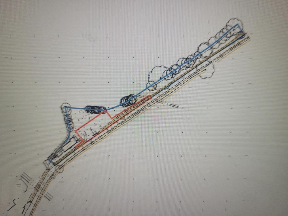

nowtie Posted July 16, 2024 Author Share Posted July 16, 2024 2 minutes ago, saveasteading said: They are renowned for clogging in a few years, requiring a change of gravel. ie expensive. How much land have you? Level or sloping? Ah ok, well I have hit a total roadblock in terms of trying to get a condition discharged, exhausted every option now and can't start any building work until we've got the surface water condition discharged....I have put together a new thread on this, see below. Yes the site is long, narrow and has very gradual slope Link to comment Share on other sites More sharing options...
Jilly Posted July 16, 2024 Share Posted July 16, 2024 Do you own any nearby land on your farm you could direct the water to? I have a pond that Building Control were happy with, which is not on the building site. Link to comment Share on other sites More sharing options...

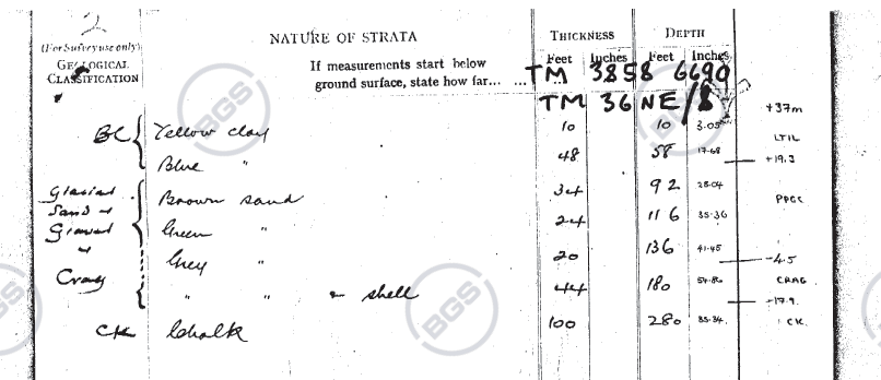

saveasteading Posted July 17, 2024 Share Posted July 17, 2024 (edited) The ground report mentuons fractured stone. That usually precludes diverting water into ita borehole or pit, because it creates a swallow hole in time. Just construct a swale and or pond. Edited July 17, 2024 by saveasteading Link to comment Share on other sites More sharing options...
nowtie Posted July 17, 2024 Author Share Posted July 17, 2024 11 hours ago, Jilly said: Do you own any nearby land on your farm you could direct the water to? I have a pond that Building Control were happy with, which is not on the building site. No! It's not on our farm. It's a site about 2 miles away. We know the farmer who owns the field to the rear but their pond is over 200m away and up a hill!! 1 Link to comment Share on other sites More sharing options...
nowtie Posted July 17, 2024 Author Share Posted July 17, 2024 On 26/06/2024 at 15:47, joe90 said: Get that JCB fired up and dig lots of holes 🤞 We're going out to site this afternoon to dig a few holes on site. How many do you think? Hubby saying 3 more is enough? How deep should they go? We're following BRS 365 but it varies all over the place on depth varying from 300mm to 2-3m!! Link to comment Share on other sites More sharing options...
joe90 Posted July 17, 2024 Share Posted July 17, 2024 Some bedtime reading, note the 300mm hole to be BELOW THE INCOMING PIPE FROM THE BUILDING . The 300mm cube is purely to measure the drainage of the ground your digging in. 👍 https://www.copeland.gov.uk/sites/default/files/attachments/percolation_surface.pdf 1 1 Link to comment Share on other sites More sharing options...
saveasteading Posted July 17, 2024 Share Posted July 17, 2024 (edited) First try the obvious. Where will the rainwater pipe be? Dig down to that level for access. Then hand dig your 300 x 300 x 300 test pit. Fill it and let it soak away or not, before the formal test. If you want, try another hole or 2, in possible locations. Near a hedge or trees might have help from gaps left by roots. Record your tests as the bco may just accept this. Be safe. 1m deep holes can collapse and kill. Edited July 17, 2024 by saveasteading 1 Link to comment Share on other sites More sharing options...
