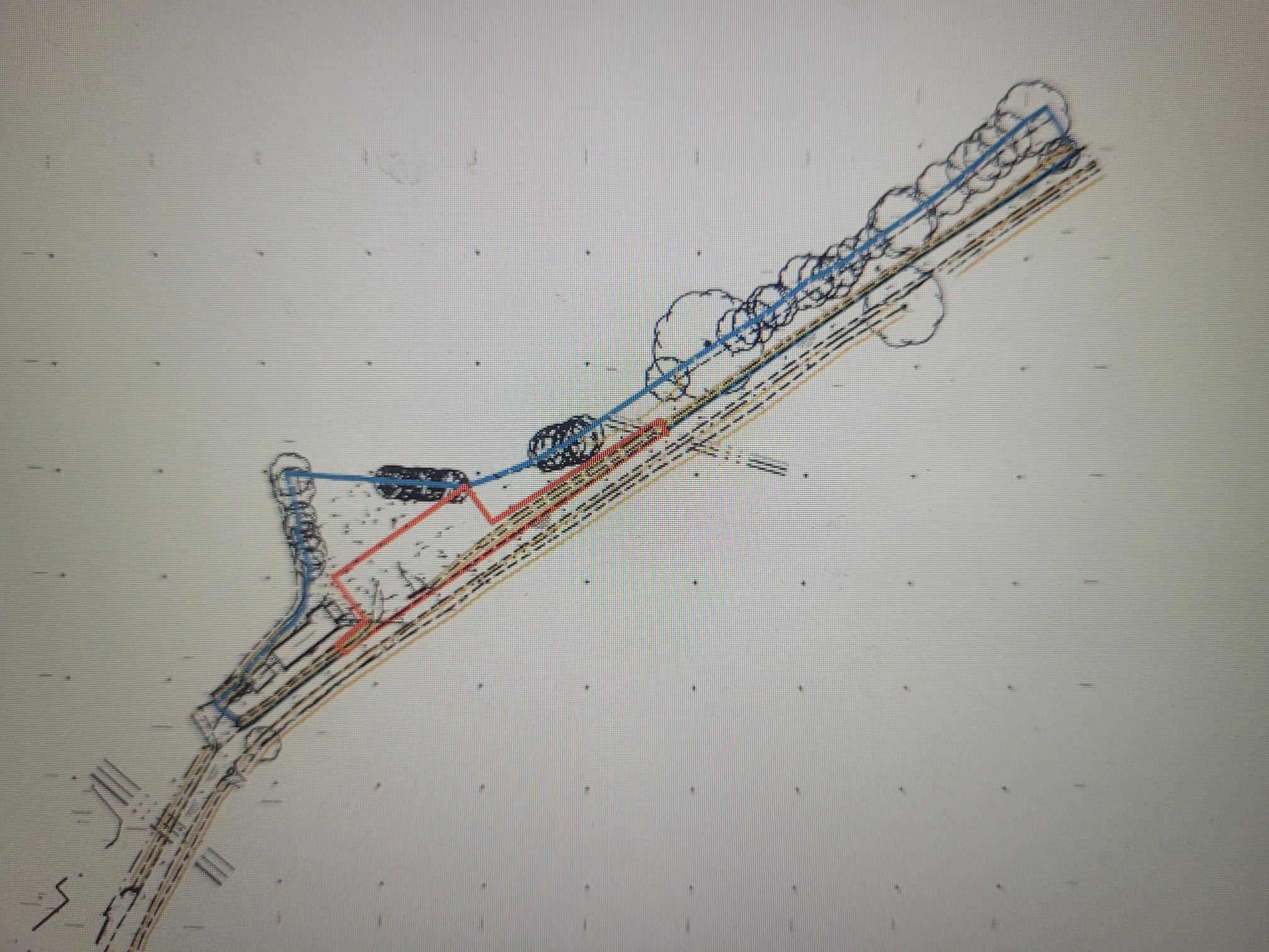

nowtie Posted Tuesday at 09:56 Author Share Posted Tuesday at 09:56 17 hours ago, Jilly said: It’s probably not worth doing it then. But you can propose something else which you can prove works. That's the issue, there are no other options left now other than re-do the perc tests all over the site and try find one that works? Link to comment Share on other sites More sharing options...

nowtie Posted Tuesday at 10:26 Author Share Posted Tuesday at 10:26 19 hours ago, Blooda said: It goes into the foul sewer, but attenuated to 2l/s. This is when it reaches 55% full Example of drainage hierarchy. [will be the same or similar for wessex water] The Drainage Hierarchy | Essex Design Guide Looks like you are at the combined sewer stage. Ahh is that a foul only sewer? OK we've had a no from Wessex Water to discharge into their foul only sewer due to the fact that there's a gully drain in front of the property and said we need to discuss with Highways. Highways have said no. Perhaps it's worth going back to Wessex? I'm not sure what you mean by "looks like you are at combined sewer stage"? We don't have a combined sewer anywhere near the site? Thanks for the drainage hierarchy. Yes we have one of those but still struggling! Link to comment Share on other sites More sharing options...

nowtie Posted Tuesday at 12:32 Author Share Posted Tuesday at 12:32 3 minutes ago, Blooda said: The foul sewer can accept a certain amount of rain water, in fact the water board like a bit to be added as it helps keep the lumps moving. What they may not stand is a massive deluge in a storm [hence the attenuation at a controlled max flow rate] You need to go back to the water board say you have explored [with evidence] all the higher level solutions in the hierarchy and then see what they say. Ahh that's really interesting to read actually. I keep asking our drainage engineers the feasibility of going back to Wessex and they keep saying it's not an option. Wessex has a SUDS hierarchy which we have followed and yes it does seem in their policy that could be an option to discharge IF we have exhausted all the hierarchy but they're currently saying no due to the Highways gully. So I have emailed Wessex to see if there is any manoeuvrability so thank you so much. I'll keep you posted. Link to comment Share on other sites More sharing options...

saveasteading Posted Wednesday at 08:42 Share Posted Wednesday at 08:42 I'm appalled at people telling you to cheat. Are people living in houses they built? What have they missed out or fudged? I'd like to think it is ignorance rather than principle. Let's go back to first principles. The authorities are trying to reduce load on the sewage works and sewers, and to avoid flooding. If all driveways are porous then they are not in the equation. Where does / did the existing roof water go? How much land is there and do you have slopes? I'm confident this can be done. Properly. Link to comment Share on other sites More sharing options...
nowtie Posted Wednesday at 10:30 Author Share Posted Wednesday at 10:30 1 hour ago, saveasteading said: I'm appalled at people telling you to cheat. Are people living in houses they built? What have they missed out or fudged? I'd like to think it is ignorance rather than principle. Let's go back to first principles. The authorities are trying to reduce load on the sewage works and sewers, and to avoid flooding. If all driveways are porous then they are not in the equation. Where does / did the existing roof water go? How much land is there and do you have slopes? I'm confident this can be done. Properly. Hi I think they're suggesting I try different test holes in different locations? We're going to try again next week. My husband is a farmer/builder and so does a lot of land drainage on farm and said he can make it soak away from both properties by digging a 90m french drain in length all the way down the site (it's long and narrow) if we did do attenuation/soakaway option. Well we have now demolished the bungalow but CCTV reported it was just going into the ground...so ultimately Highways gully drain outside the front of the property. We've been trying to say that we'll reduce the uncontrolled run off rate and better what is there at the moment. This would be all fine but we also have permission to build another detached dwelling in the garden of where the bungalow was so this one is the one we'd struggle with for the surface water. Land is 0.4 acre and it's awkward shape, very narrow. I attach the location plan. Blue is the land I own. Red outline is new detached dwelling. To left is existing bungalow which weve had full planning to demolish (done) and re-build. The slope is marginal but it does slope gently down towards the narrow section (hence wanting to put a linear french drain along the whole length of site...but it has to be 5m from highway so not even sure if this is possible) Thanks for your help Link to comment Share on other sites More sharing options...
saveasteading Posted Wednesday at 11:17 Share Posted Wednesday at 11:17 34 minutes ago, nowtie said: digging a 90m french drain Ideal. There is an enormous surface area to the sides and bottom of the trench so even a poorly percolating clay will take it. And the sheer volume of pipe and gaps in gravel will hold stormwater until it disappears. Also i see lots of trees. They will dry out the ground in summer, and the roots will have formed crevices through the clay. The tests may work better there. The 5m guidance shouldn't apply to a shallow French drain, but distance will avoid your pipe taking road water. Barrels on downpipes also helps to take the first flush of a storm. In winter you can open the tap to a dribble, to empty them slowly before the next storm. All such should be accepted by planner or bco. They might be suspicious of a good percolation figure though. A lagoon or swale is useful but I don't know if the topography allows it. 40 minutes ago, nowtie said: they're suggesting I try different test holes in different locations Some this and others I think suggesting you make up some numbers. Link to comment Share on other sites More sharing options...
nowtie Posted Wednesday at 11:40 Author Share Posted Wednesday at 11:40 18 minutes ago, saveasteading said: Ideal. There is an enormous surface area to the sides and bottom of the trench so even a poorly percolating clay will take it. And the sheer volume of pipe and gaps in gravel will hold stormwater until it disappears. Also i see lots of trees. They will dry out the ground in summer, and the roots will have formed crevices through the clay. The tests may work better there. The 5m guidance shouldn't apply to a shallow French drain, but distance will avoid your pipe taking road water. Barrels on downpipes also helps to take the first flush of a storm. In winter you can open the tap to a dribble, to empty them slowly before the next storm. All such should be accepted by planner or bco. They might be suspicious of a good percolation figure though. A lagoon or swale is useful but I don't know if the topography allows it. Some this and others I think suggesting you make up some numbers. Thanks for this. This is exactly what my husband suggested BUT our drainage engineers didn't seem willing to sign it off? We therefore went ahead with their idea of attenuation tank plus slow release into Highways gully drain but as I said before Highways has now said no and I'm running out of money! Could we put a plan together ourselves as the above and submit it? Just as a sidenote we're about 1.2m above the road. This is a pre-commencement condition that we can't seem to get discharged. Link to comment Share on other sites More sharing options...
saveasteading Posted Wednesday at 13:02 Share Posted Wednesday at 13:02 1 hour ago, nowtie said: Could we put a plan together ourselves as the above Yes . Plain English. The requirement. The constraints. The site circumstances. The solution. All of that in a quick overview, then again in detail. I'm happy to look over it. 1 hour ago, nowtie said: our drainage engineers didn't seem willing to sign it off? They are probably Structural not Civil Engineers. Many default to holding the water then releasing it slowly as that is what the big housebuilders do. No water leaving the site is best practice. It also reduces your drainage rates dramatically....every year for ever. Link to comment Share on other sites More sharing options...

Dave Jones Posted Wednesday at 13:22 Share Posted Wednesday at 13:22 4 hours ago, saveasteading said: I'm appalled at people telling you to cheat. Are people living in houses they built? What have they missed out or fudged? I'd like to think it is ignorance rather than principle. Let's go back to first principles. The authorities are trying to reduce load on the sewage works and sewers, and to avoid flooding. If all driveways are porous then they are not in the equation. Where does / did the existing roof water go? How much land is there and do you have slopes? I'm confident this can be done. Properly. its called reality. Soakaways dont work in clay and never will. So you make an attenuation pit a.k.a soakaway to hold the deluge with the overflow goinjg to foul. Literally hundreds of thousands of houses like this. Flooding is a totally separate issue, dredging the rivers again would be a good start. Link to comment Share on other sites More sharing options...
