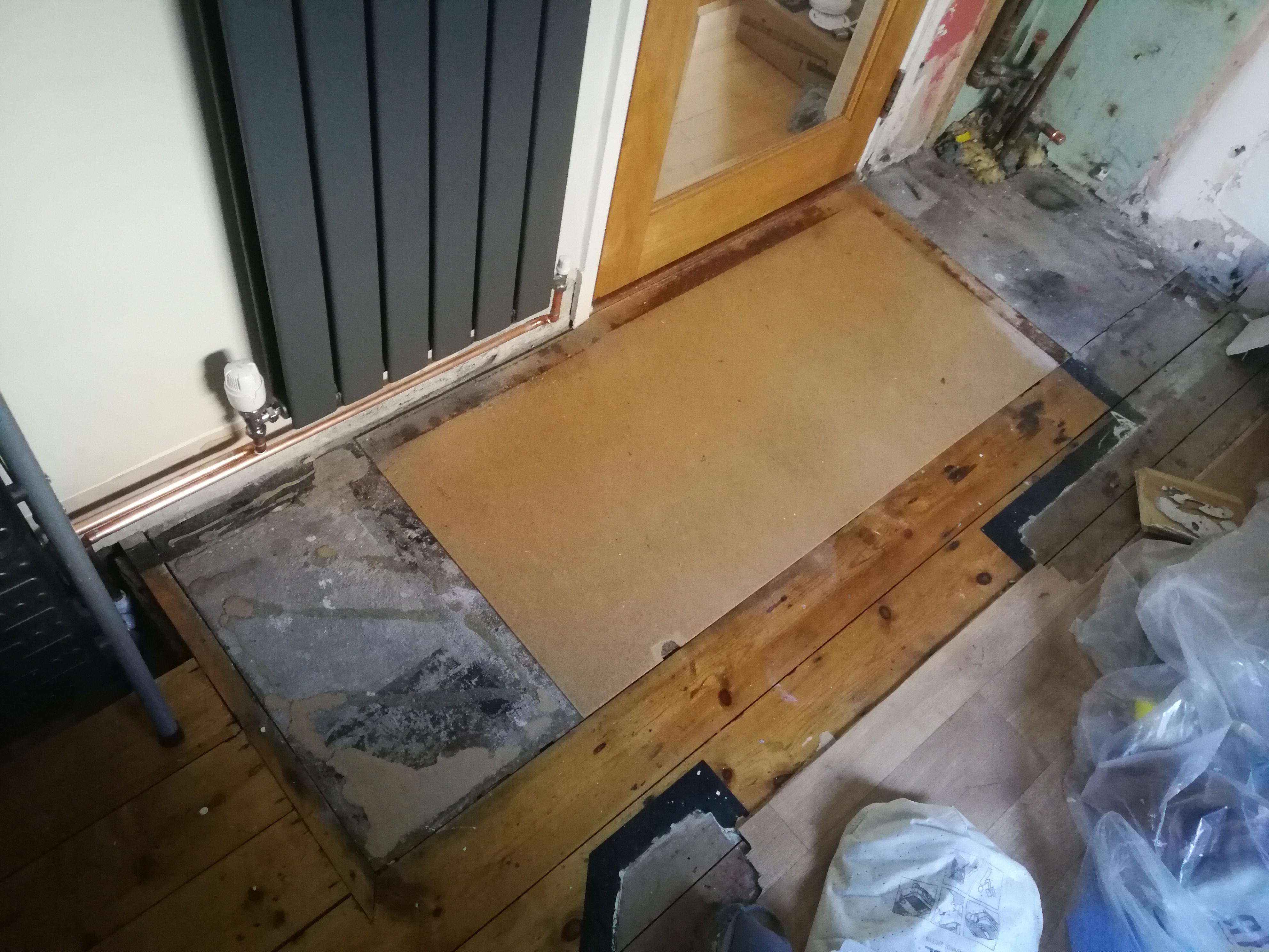

Sparrowhawk Posted June 19, 2024 Posted June 19, 2024 (edited) We lifted some hideous vinyl to get a radiator plumbed in, to find a varnished wood floor (nice!) and a slab of concrete exactly where the pipes needed to go. We think the concrete was where the cooker stood in the 1920s kitchen. The slab is about an inch thick and seems to rest on hardcore. The rest of the floor is suspended timber. It would be nice to have the whole floor as wood and to insulate the entire floor. As we're living here, how could we break it out making the minimum mess, particularly keeping dust down? An inch seems thick to break up by hand, but I can see a kango turning the hallway and rooms grey. And is there anything to watch out for in the makeup of slabs like this e.g. asbestos? Edited June 19, 2024 by Sparrowhawk
nod Posted June 19, 2024 Posted June 19, 2024 You should be able to lever it out with a bar Like lifting a flag
joe90 Posted June 19, 2024 Posted June 19, 2024 If not able to lift it an Electric kango is your best bet, anything that cuts it will create more dust, does not need to be huge, it acts like a lump hammer and chisel (without the hard work), mind you hitting it with a sledge hammer might break it up enough to lift it out in pieces.
SteamyTea Posted June 19, 2024 Posted June 19, 2024 Cheap child labour, we are allowed to do that as long as they are relatives.
Conor Posted June 19, 2024 Posted June 19, 2024 A sledge hammer should break it up into manageable chunks.
Sparrowhawk Posted June 20, 2024 Author Posted June 20, 2024 Thanks all, I'm going to try a sledge hammer first and then hire a kango if that doesn't work.
