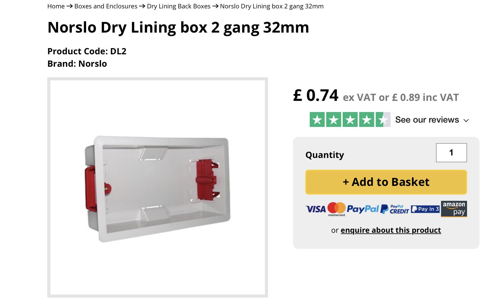

G and J Posted June 15, 2024 Author Share Posted June 15, 2024 2 hours ago, G and J said: My word I’m such a bonehead. My head is so full of stuff explaining myself isn’t easy sometimes, there are so many disparate thoughts jostling to get to the front of the queue. The plan is to have an OSB or ply skin behind the plasterboard. This is personal preference (read OCD inspired folly, perhaps) but I like the idea of really solid walls I can hang stuff from anywhere, and maybe with better acoustic attenuation too. But I hadn’t thought about back box depth. 12.5mm PB, then 11mm OSB, then 11mm void = tight. OK, time to research back boxes….. And I have an ‘every millimetre counts’ attitude. The plot is 24’ wide, the house, externally, will be 21’. So to me and our already advanced layouts based on 1’ thick walls, it will make a difference. Bingo! https://www.ukelectricalsupplies.com/norslo-dry-lining-box-2-gang-32mm.htm Link to comment Share on other sites More sharing options...
JohnMo Posted June 15, 2024 Share Posted June 15, 2024 17 minutes ago, G and J said: Bingo! https://www.ukelectricalsupplies.com/norslo-dry-lining-box-2-gang-32mm.htm Bingo - not The 35mm refers to the depth of the box, the issue is the 35mm box is good for up to 16mm wall thickness you are wanting nearer to 25mm (with plaster), so then you need the deeper 47mm back box, but not all of them are suitable either Link to comment Share on other sites More sharing options...
G and J Posted June 15, 2024 Author Share Posted June 15, 2024 49 minutes ago, JohnMo said: Bingo - not The 35mm refers to the depth of the box, the issue is the 35mm box is good for up to 16mm wall thickness you are wanting nearer to 25mm (with plaster), so then you need the deeper 47mm back box, but not all of them are suitable either Ah. So I have to oversize the hole in the OSB/ply. I think. Link to comment Share on other sites More sharing options...
JohnMo Posted June 15, 2024 Share Posted June 15, 2024 Just now, G and J said: Ah. So I have to oversize the hole in the OSB/ply. I think. That would work. Good thinking. Link to comment Share on other sites More sharing options...
