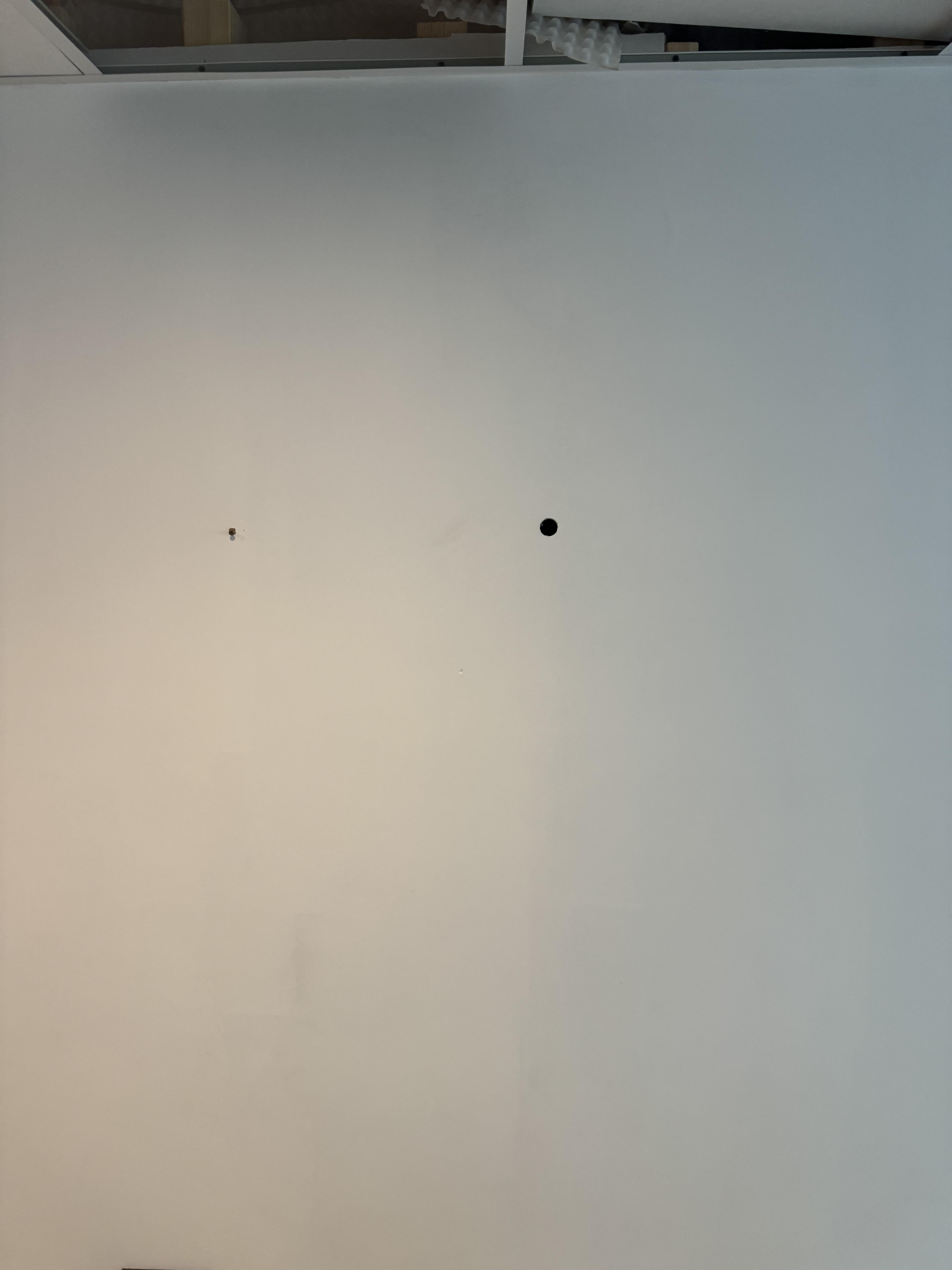

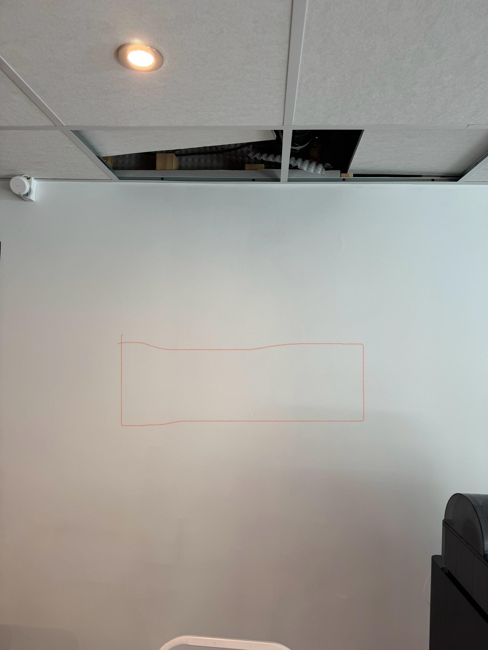

Pocster Posted June 17, 2024 Author Share Posted June 17, 2024 I only concern with this is that plasterer skims it away to invisible once painted . I’ve got a few other jobs for plasterer when I get him so it’s not get him in for just this . Link to comment Share on other sites More sharing options...
Pocster Posted June 17, 2024 Author Share Posted June 17, 2024 1 minute ago, SimonD said: I don't trust those. These are much, much better: https://www.tcfixings.co.uk/category/toggler-snaptoggle-plasterboard-anchors/1001 which I use to fix radiators to plasterboard. Or, I use these to fix towel rads to plasterboard (because they get pulled about with towels etc. which are solid as: https://www.geefix.com/ I like those geefixings . I could try them I.e test on pb off cut to convince myself . Then try on wall - worst case I got back to cutting rectangle out ; nothing to lose … Link to comment Share on other sites More sharing options...
joe90 Posted June 17, 2024 Share Posted June 17, 2024 3 minutes ago, Pocster said: Understand the method for 1 fixing . But surely far easier for me with 4 fixings in a row to cut out rectangle and noggin between studs … ? Something like this ? Yes I agree, how about a sheet of ply behind (in case SWMBO changes her mind 🤷♂️) if your plasterer is coming back then why not. 1 Link to comment Share on other sites More sharing options...
Pocster Posted June 17, 2024 Author Share Posted June 17, 2024 Just now, joe90 said: Yes I agree, how about a sheet of ply behind (in case SWMBO changes her mind 🤷♂️) if your plasterer is coming back then why not. Considered that also . SWMBO change her mind ?? Never …. 😆 Link to comment Share on other sites More sharing options...
garrymartin Posted June 17, 2024 Share Posted June 17, 2024 6 minutes ago, Pocster said: Something like this ? That's my normal method for things like heavy TV mounts, so should absolutely work for your needs. 1 Link to comment Share on other sites More sharing options...

SimonD Posted June 17, 2024 Share Posted June 17, 2024 34 minutes ago, garrymartin said: Not sure they'll work. As I mentioned before, I think these will be the type that need something to be fastened tight to the plasterboard to work, i.e. you fix a batten to the wall. You just need a screw sticking out and unless I'm really wrong, I don't think those will work for that... EDIT - just watched a Youtube video. They *might* work I guess... No, they work 😉, with just plain old plasterboardand even better double plaster board and even on internal timber cladding. You just need to have a decent cavity behind the plasterboard to get the fixings in. This is partly why to toggle clamps are great as they need less room behind the plasterboard but also you can remove the screw, or bolt (because they come in different thread sizes) and the fixing stays in place. 2 Link to comment Share on other sites More sharing options...

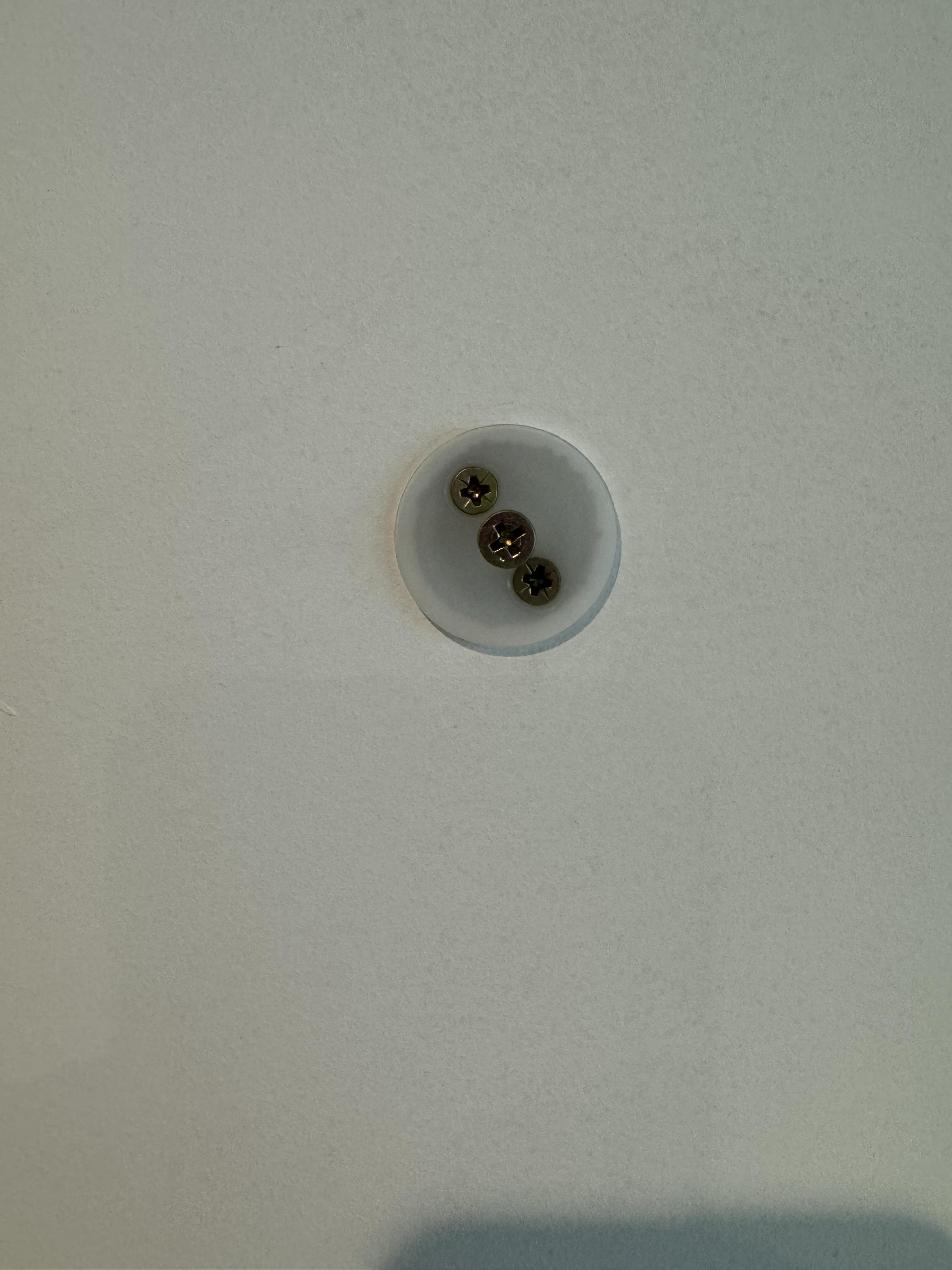

Alan Ambrose Posted June 17, 2024 Share Posted June 17, 2024 I like these things for that sort of job: https://www.fischer.co.uk/en-gb/products/cavity-fixings/board-fixing/metal-cavity-fixing-hm Only the Fischer ones, the competitor ones are rubbish. You really do need to use the pliers thingy ('setting tool') to pull them tight before you screw into them. Ask me how I know. With these you can screw and remove as often as you like. 1 Link to comment Share on other sites More sharing options...
Pocster Posted June 19, 2024 Author Share Posted June 19, 2024 Oooooo Off my basic test these seem surprisingly good . I like that the centre screw ( the one taking the load ) can be of your choice and even placed in at an angle if need be . So some play . Enough work for today - tomorrow I will attempt mounting on the wall …. 1 Link to comment Share on other sites More sharing options...

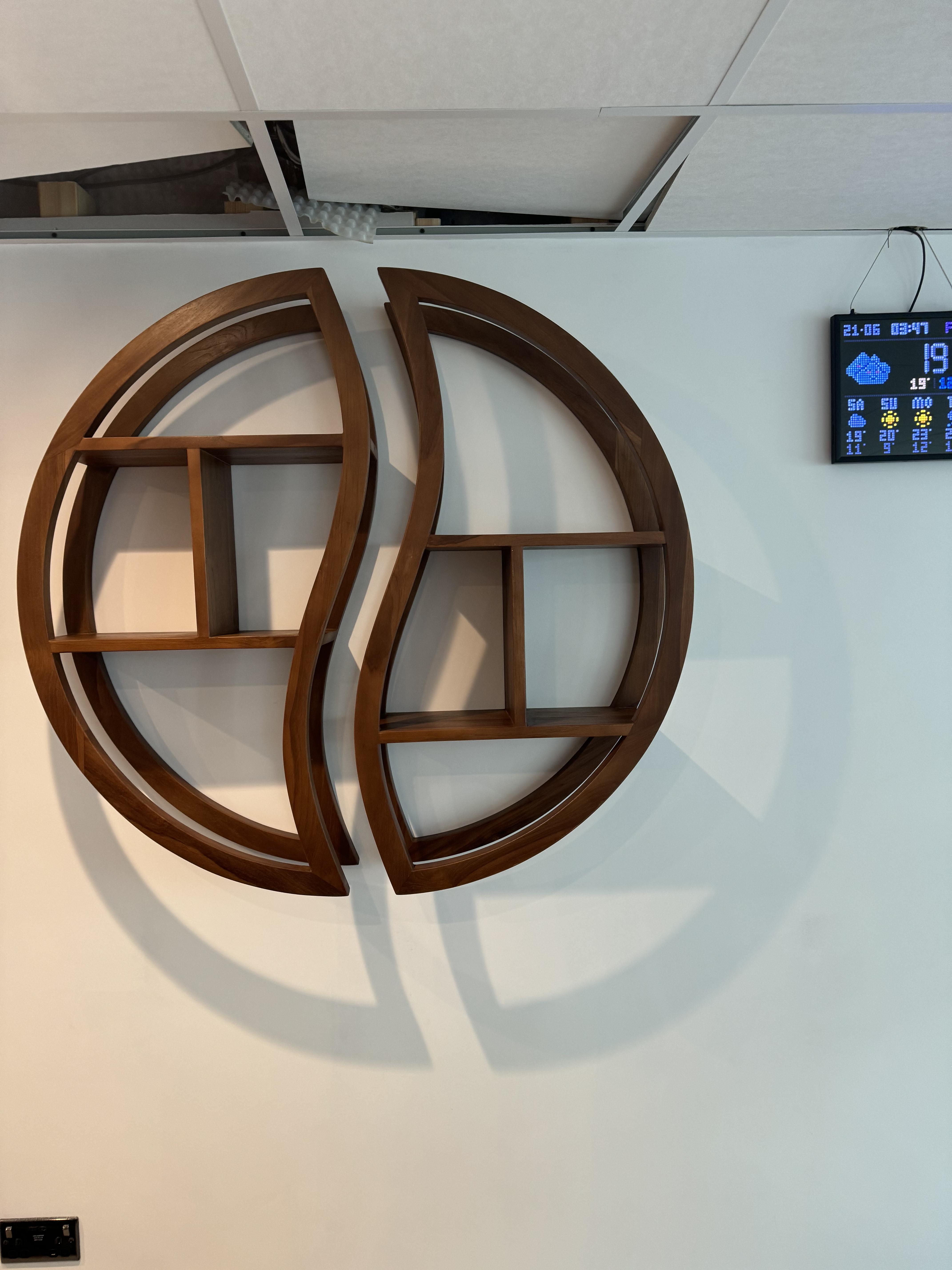

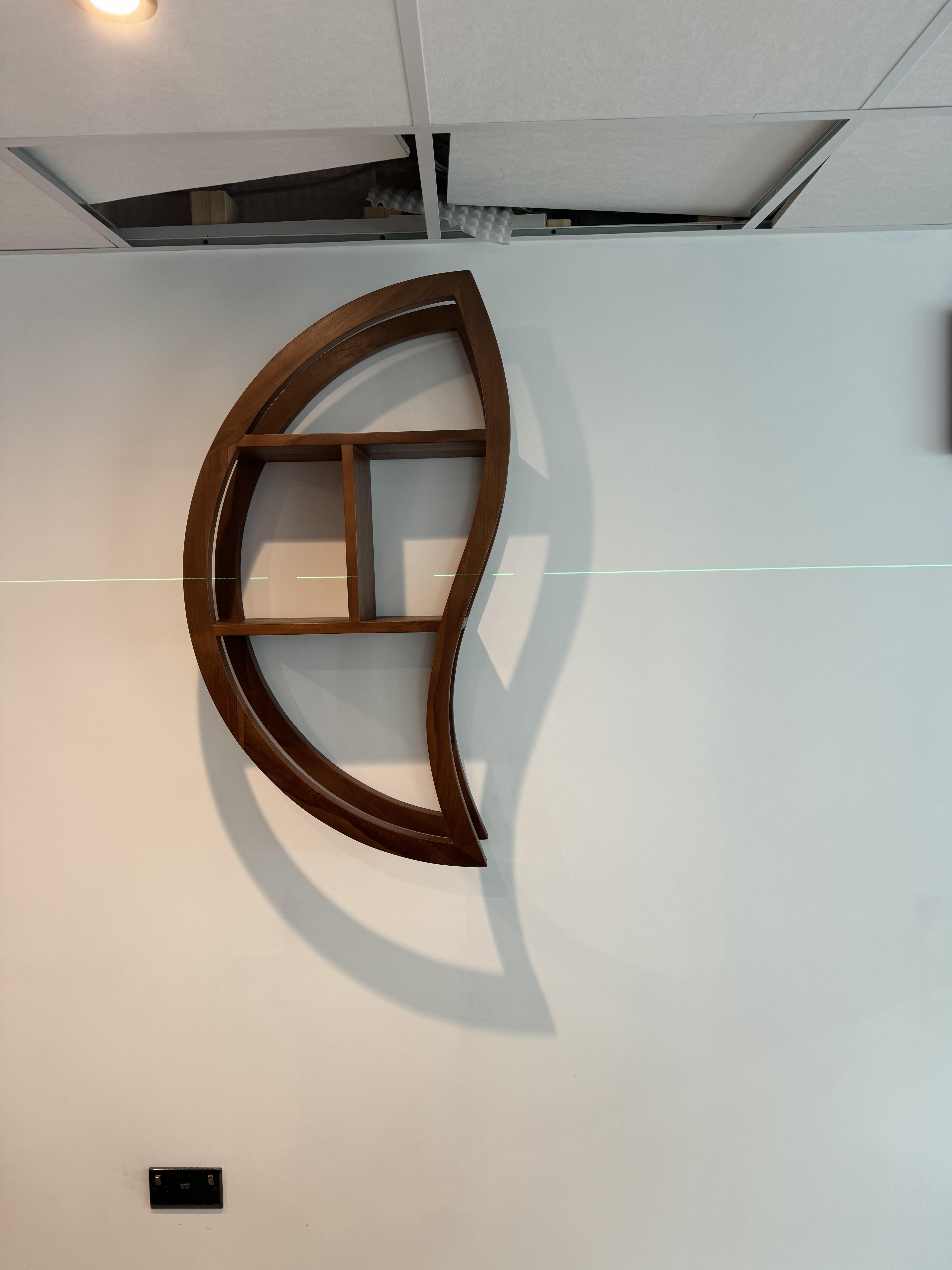

Pocster Posted June 21, 2024 Author Share Posted June 21, 2024 (edited) Lots of swearing ! Not with these fixings - they seem really good for pb . But with the tiny key hole fitting on the back - doesn’t help that their fixings aren’t perfectly lined up . Anyway half done !! Edited June 21, 2024 by Pocster Link to comment Share on other sites More sharing options...

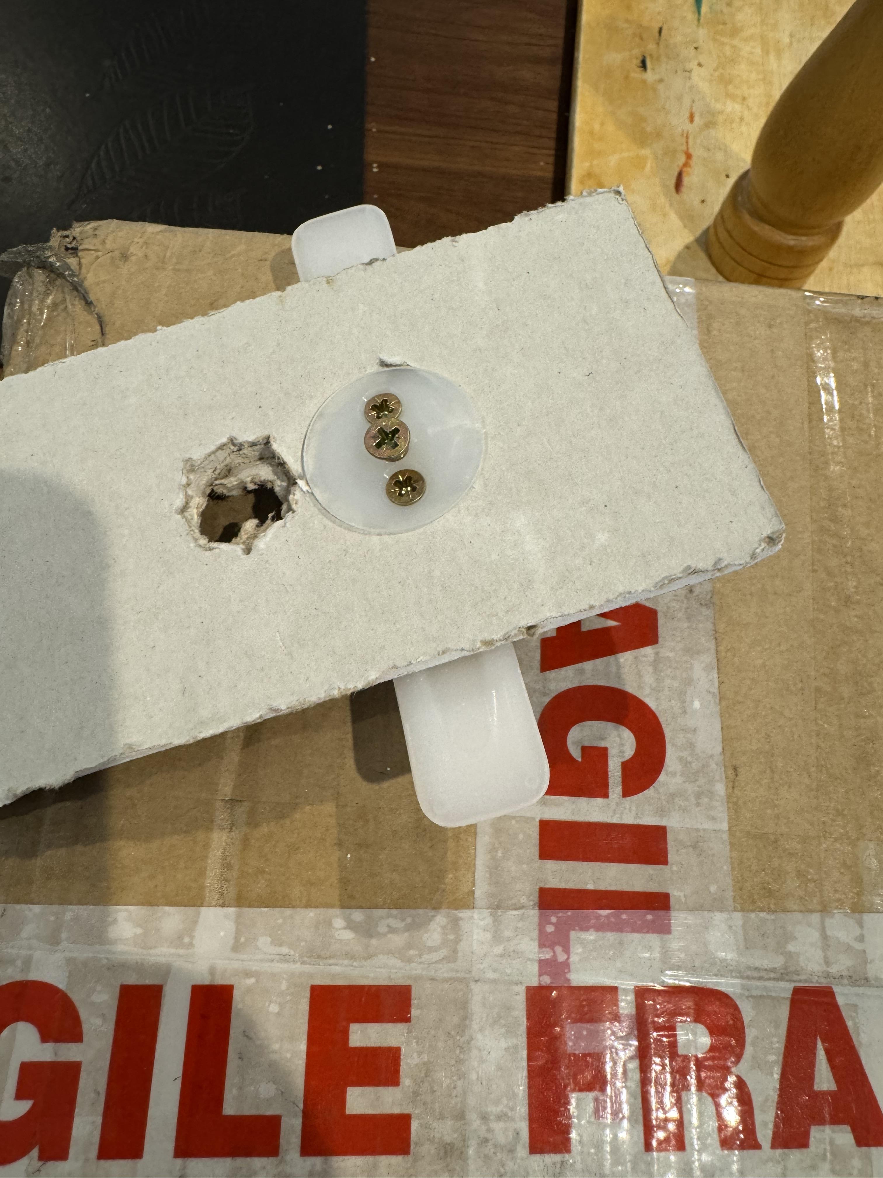

Pocster Posted June 21, 2024 Author Share Posted June 21, 2024 What a pita . The fittings are good . One issue is that the centre screw whilst installing can catch the nylon and so spins the fitting unhelpfully . One time I thought it was in ( you remove the nylon thread at this point ) and inner fitting just fell down inside the wall . 🙄 I recommend these fittings for pb - but like (expletive deleted) would I hang say a tv off them - no chance . Photo of completed work . Will update later with photo of unit on floor and pb failed 🤣 Home time now ! Oh , I am home . Home and Friday , so ????? 🤔 ……. 🍷 Link to comment Share on other sites More sharing options...
Thorfun Posted June 21, 2024 Share Posted June 21, 2024 @Pocster I don’t understand about you needing a spread to re-plaster after cutting a square of plasterboard out. Surely you just put the same square back in and then just easyfill around the edge? 🤷♂️ glad you got it sorted though Link to comment Share on other sites More sharing options...
Pocster Posted June 22, 2024 Author Share Posted June 22, 2024 10 hours ago, Thorfun said: @Pocster I don’t understand about you needing a spread to re-plaster after cutting a square of plasterboard out. Surely you just put the same square back in and then just easyfill around the edge? 🤷♂️ glad you got it sorted though If I do that then say polyfilla around the re inserted rectangle it will look shit . A large area can look perfect if re skimmed . Of course if your poly filla skills are amazing then perhaps it would work . I was just trying to do the job to a professional level for once . 1 Link to comment Share on other sites More sharing options...
